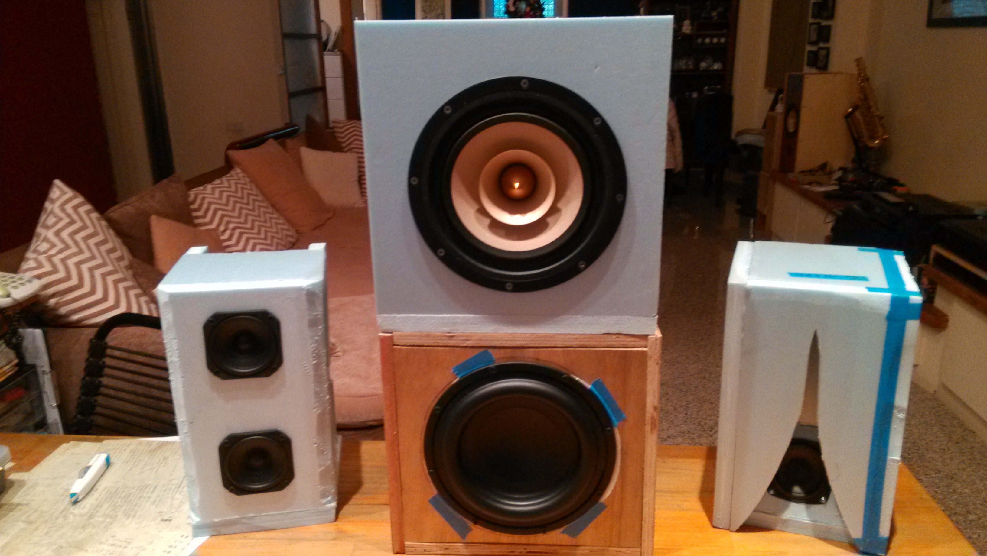

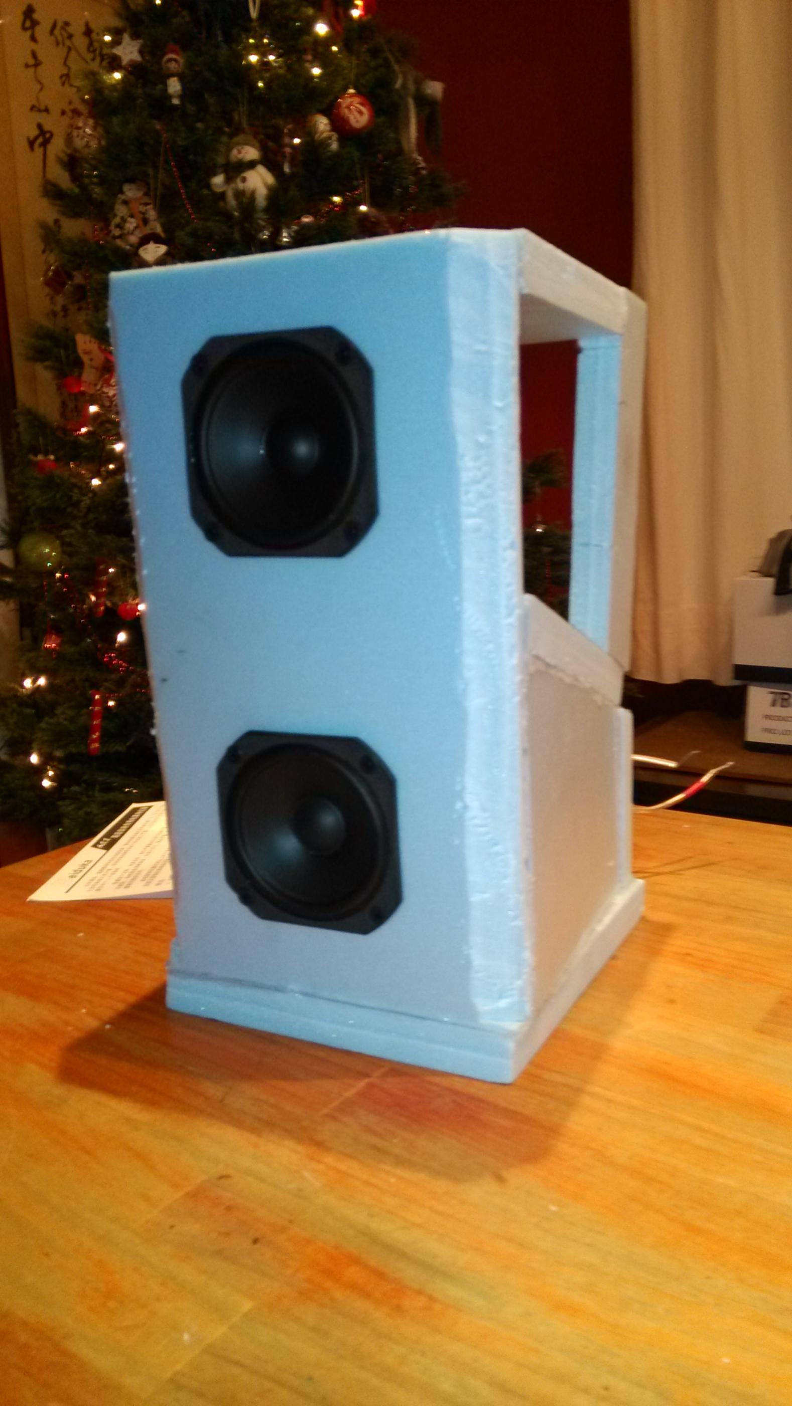

Couldn't stand still... and since I had a couple of hours today and a new glue gun to try, I came up with a mockup of the Brio. It's not pretty, but it works. I could only make one as I only have 2 TC9s (thanks to the amazing member BYRTT)
It doesn't have a cap to limit the lows on the higher driver, nor does it have a port, the lower driver is in a sealed box.
I combined it with a sub for the lower frequencies. XO at 150Hz.
It has a sweet sound. One of the best monitor I've built. In a proper wood and good looking enclosure, it would surely be quite nice.
Do I think it could beat big towers or big full range setups? eh.... no. To my ears, there's something about using big drivers that gives more presence.. unless you're using 25 of those TC9 in towering towers ala wesayso. But having now combined 2 TC9s, I believe that 25 of them with DSP must sound incredible.
Anyway, back to the Brio styled enclosure.... they are sure nice for a small to medium sized room. I think they give a very good experience for the size and for the price of 4 TC9 drivers.
If anyone wants some measurements, just ask... what do you want to see?
PS. I think I will run with this and put it on steroids and go with an 8" sub under and an 8" fullrange on top....

Can you measure that top end driver playing by itself? Just to figure out the reason for that cap.
It would help to see the bottom one too and their combined result.
Even though the top driver will not produce any bass on that small baffle, it's still moving at those freqs so I'm guessing the cap is to limit excursion?
Probably. To contradict someone earlier in the thread, the OB driver will need a highpass, as it will bottom out before the ported driver does. Cabinets add resistance to cone motion, OBs do not.

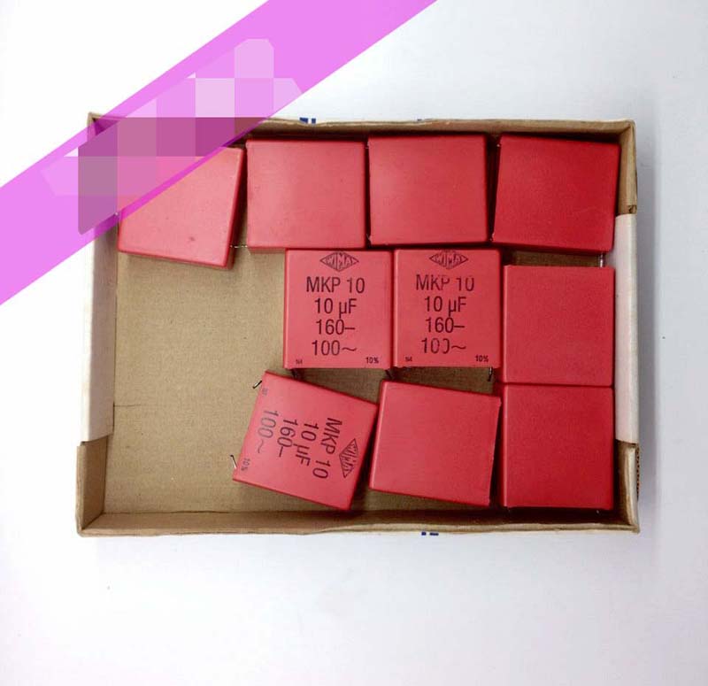

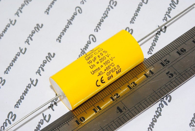

I found these two that looked promising, but not sure if one is much better than the other one.
The first one is about $4, and the other square one is 10 times the price at $40.

1. What frequencies would be filtered out using the 4.7uF to 10uF caps??
2. Does the cap just get soldered in line with the positive wire lead going to the upper driver?
3. Are there huge differences in terms of quality for the Caps?? Which brands would you recommend?
