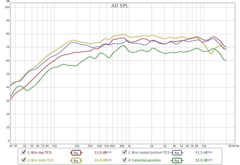

Here are the measurements of the Brio wannabe I made :)
DAC and amp were set with the initial sweep of the dipole driver, and left untouched for the other sweeps.
I see why the top one starts to get bypassed at 1k... probably helps flatten out that little bump right under 1k. That bump isn't there with the sealed driver.
Also, on close mic position (less than a meter), using both drivers, there is comb filtering happening peaking at about 13k.
This does not impact performance when sitting over 1.5m from the speaker though. So, I wouldn't use the Brios for a nearfield setup.
So, along with better imaging, having the speaker sitting away from walls, and the listener at least 1.5m away, the comb filtering is non-existent.
Having a sub (or two!) that will reach to 300Hz, and adding a little bit to the 300 to 500Hz range would make it just about perfect!

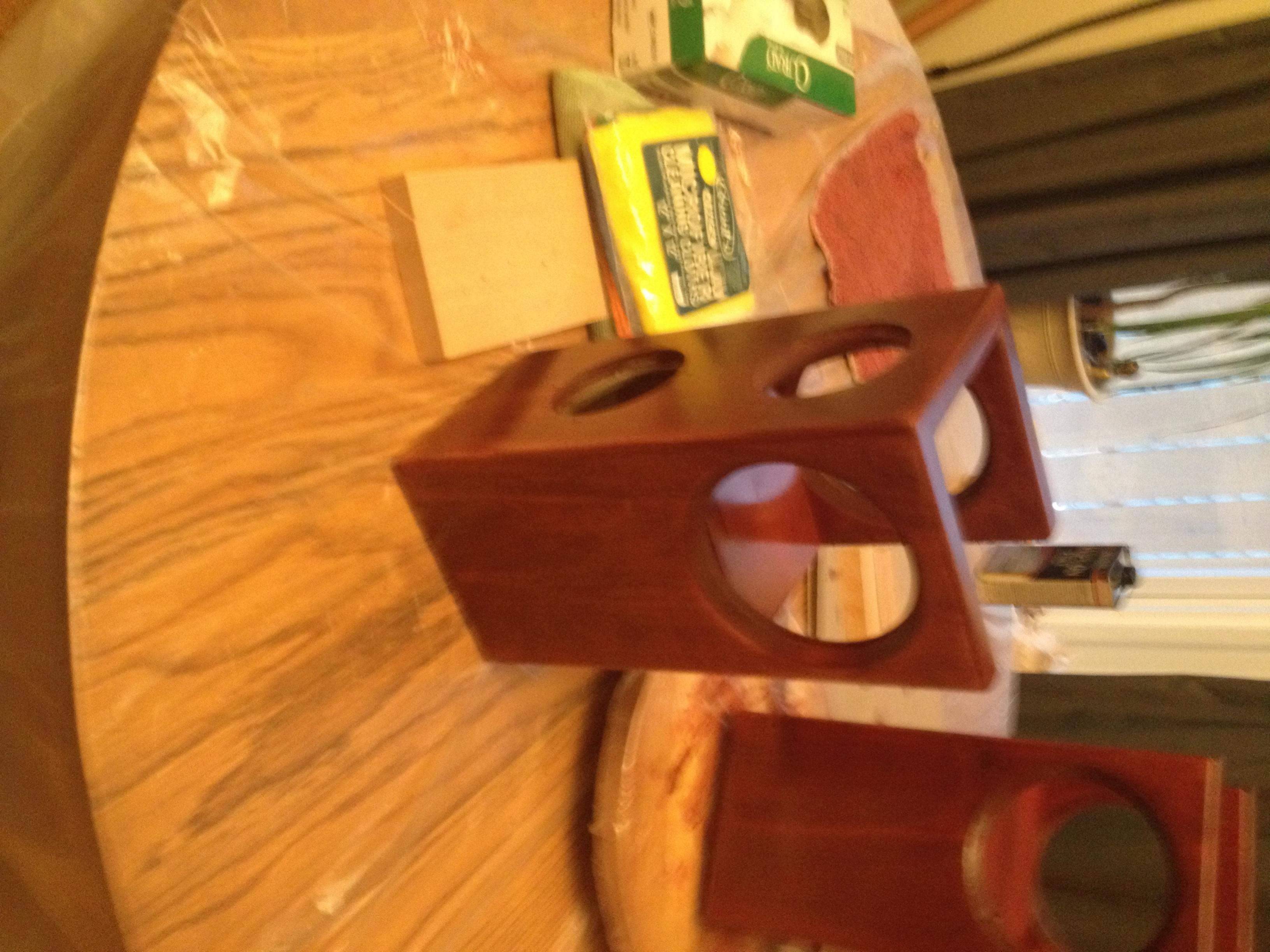

Hi all. I am creating a prototype of these brio trio speakers as well. I already have one pair if the drivers and am getting the second pair soon. I am going to pair them with either an hsu subwoofer or an Eminence Alpha 15" in an h-frame. I wish that I could create a nice cabinet like the Nola ones.

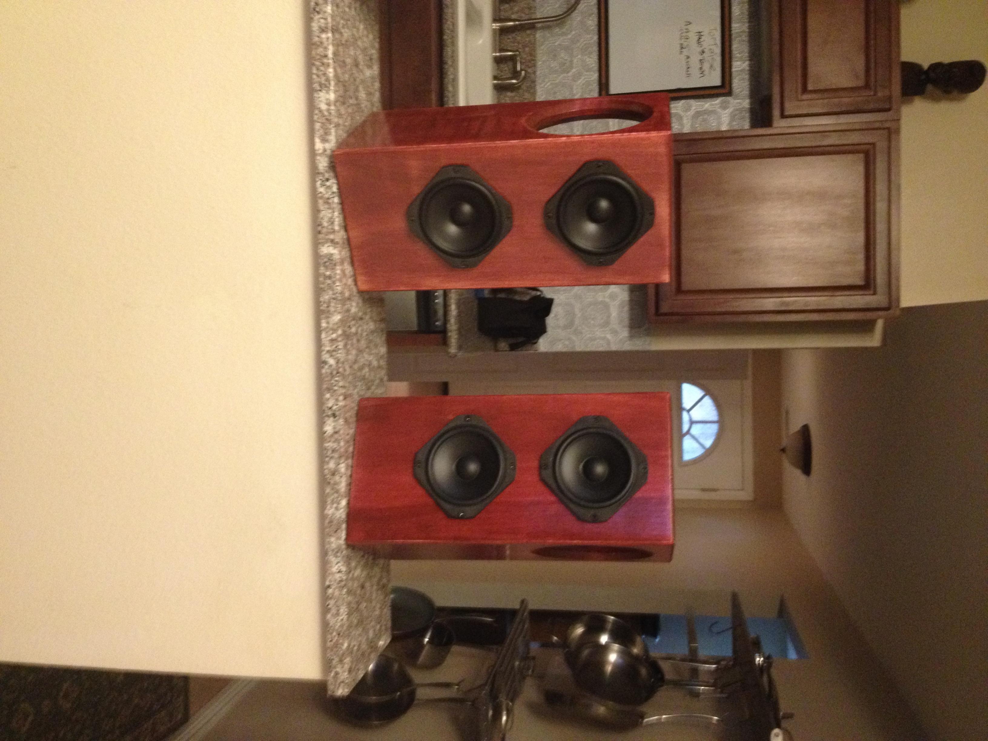

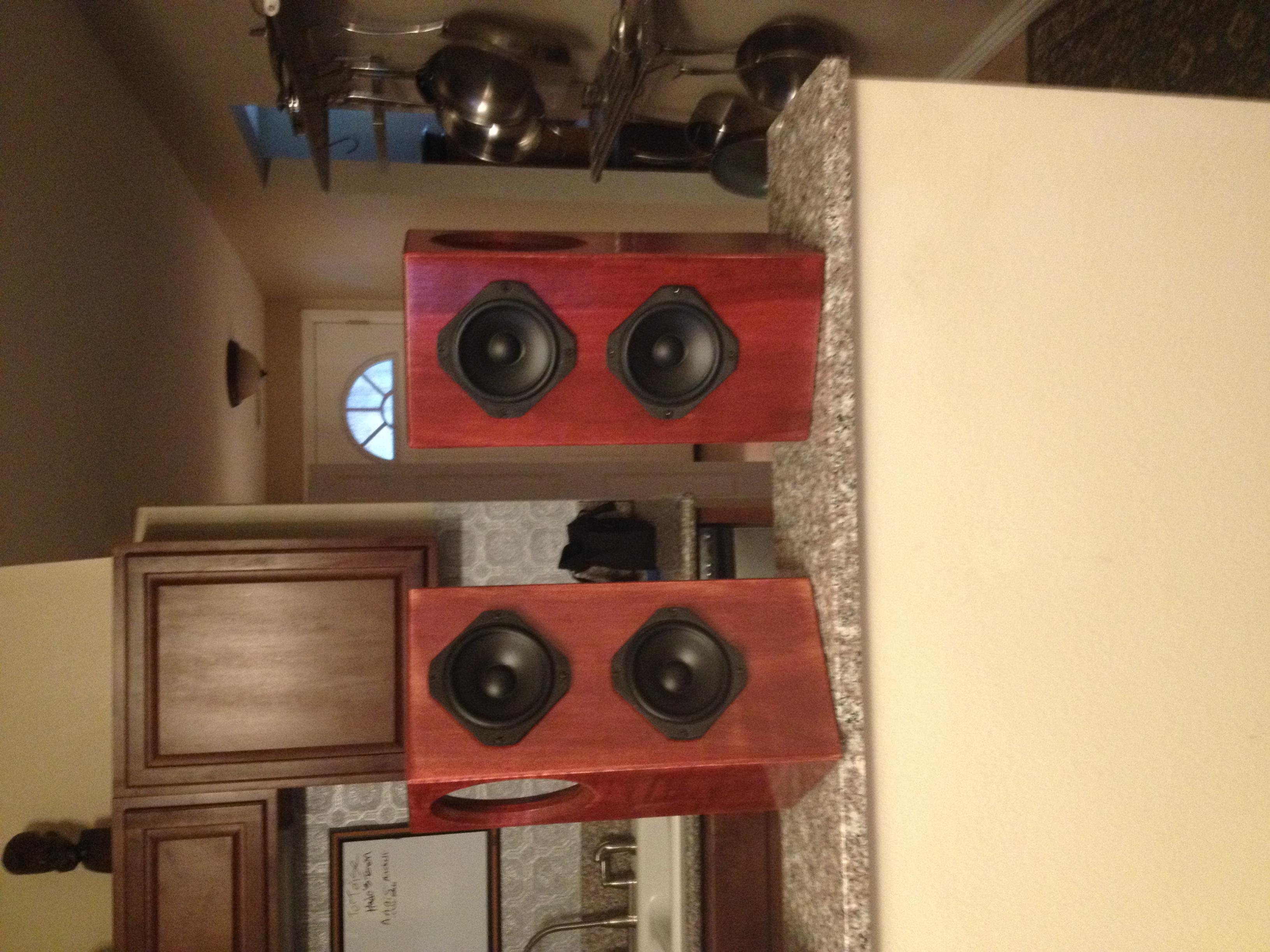

Finally Finished
Well Guys here it is... The first prototype of the brio clone. Imaging is unreal, though I have never really had monitors/book shelve type speakers and I hear they tend to struggle less with good image. They come across as a bit bright and I wonder if it was my choice of cheap cap. Low end is almost non existent, though i didn't expect much. Good with jazz, vocals, acoustic but struggle with hard hitting low end and tend to distort a bit. I am making a second pair now out of MDF and will try a better cap to see if that solves the brightness and provide better tonal balance. Thanks again to one and all who gave advice and laughed at my pain!!!!!
