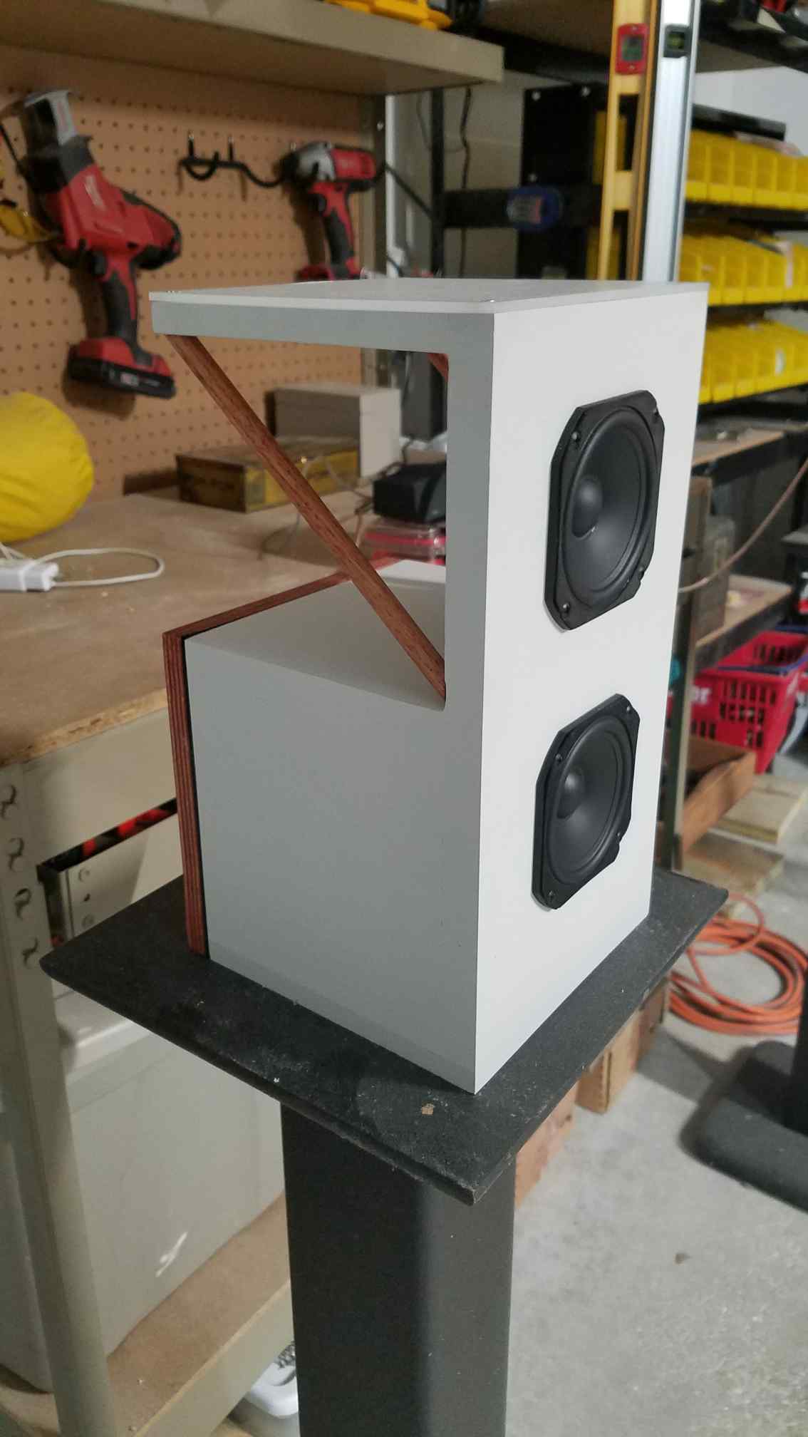

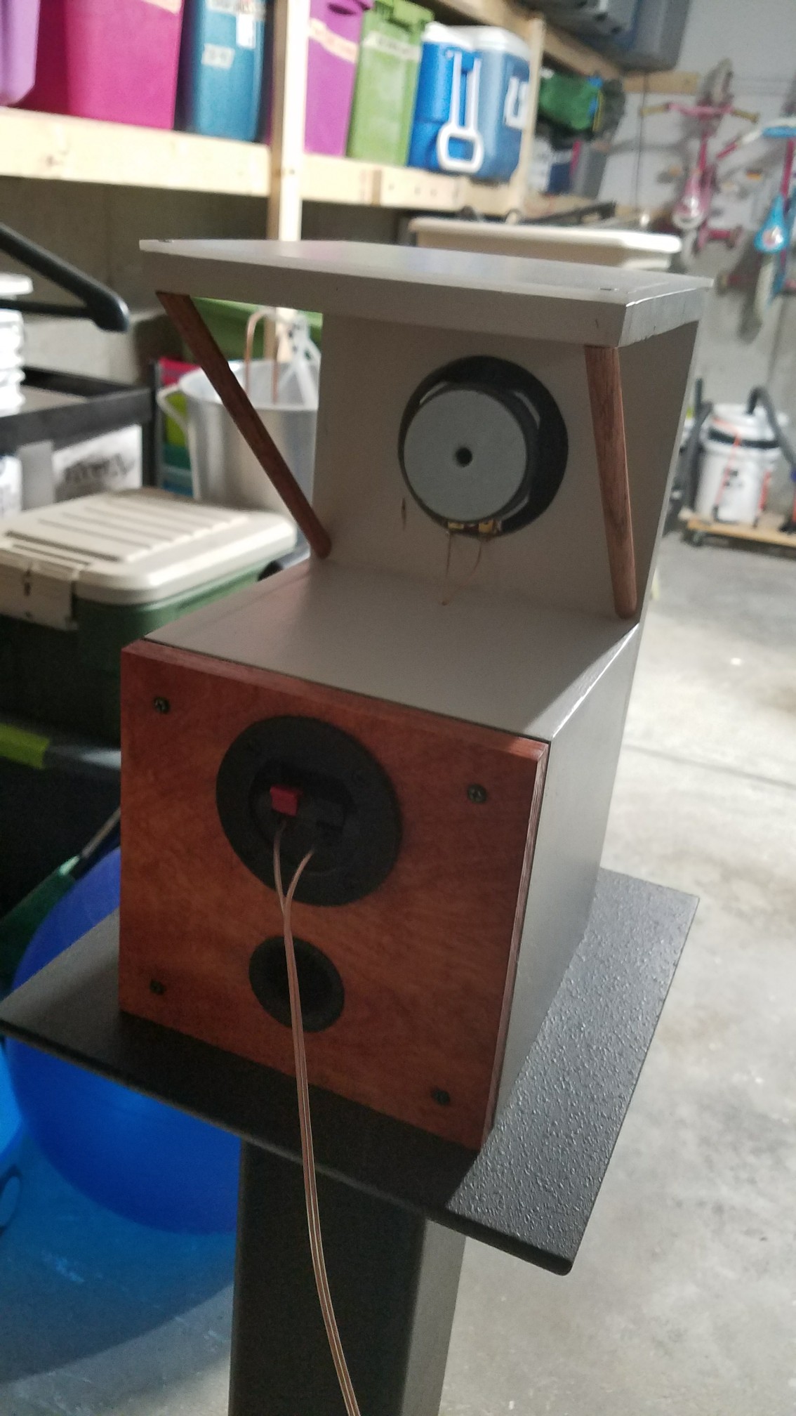

I am currently building a pair of these. Have all the wood cut and drivers and caps on hand. I could have had them done already but my OCD insisted on rabbeted corners and can't really run the router outdoors by the time I get home at night. Home depot here used to have the birch ply with more plies but the stuff they get now is crap. De-lams easy, splinters like crazy and has voids on the interior plies. I'll be using Doug-fir marine ply from here on out unless I can find better at a dedicated lumber yard.
I ended up going with a 15 degree angle on the top because it just looked better to my eye from where I sit. Ended up cutting the holes in the sides with the band saw and patched the blade entries back with epoxy/cabosil. Wasn't worth making a router pattern for. I'll sand and round over those holes before assembly. Also used a solid run of ply for the entire back so that it has the same reveals as the sides.
May change the enclosures once I figure out if I like them and what makes them tick, since I am not sure how I feel about "cloning" things.

I have so far made the open section 'somewhat' smaller, relative to the sealed section. I also put a 45 deg bevel on the back side of the drivers being I used the crap 17 something mm 'birch' plywood. Home Depot's broke me from buying anymore plywood from them. I knew better. It was convenient and on the way home from work so I took a chance. Had to repair large voids on some of the edges with cedar shims and glue before I could even proceed. The face veneers are ridiculously thin as well. I am used to thin face veneers on marine ply, but this is borderline paper. I just left enough space in the top with a little more than enough room for the wire connections. Have no idea if this will make a difference.
Also didn't center the drivers in their spaces. Favored the slanted ceiling of the box with lower driver with the flat edge of the driver frame about .75" below it. Top driver is more centered in it's space.

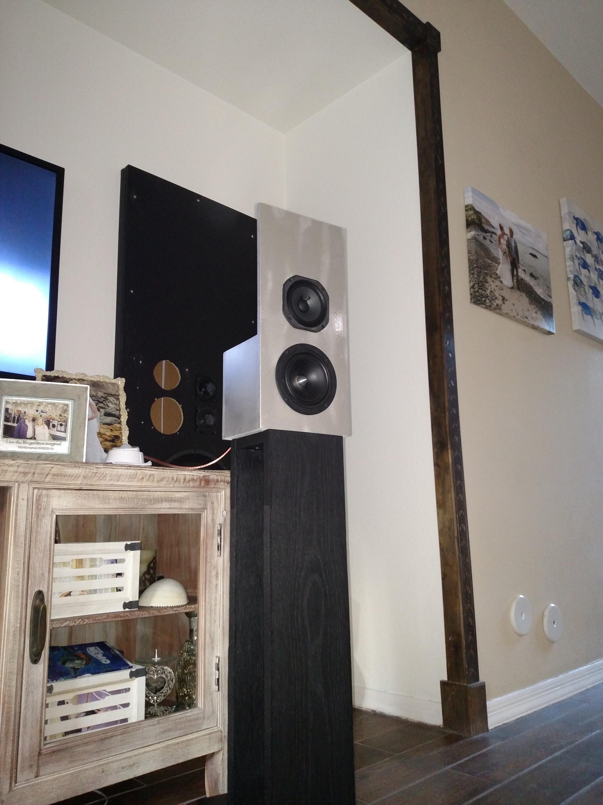

finally made a decent looking speaker!
I finally got around to making a reasonably good looking speaker. Three cans of fancy, sparkly paint, three cans of clear and black stands. It is the aforementioned Tang Band/Galaxy Audio combo and it sounds just perfect even without a capacitor which I do intend to try. There is no shortage of bass either because I have two infinite baffle subs in the wall. My wife is awesome! And the living room entertainment center backs to a bedroom closet so I went for it.
I'm very very happy. The sound is wonderful. Am I satisfied? No, probably always be searching for ways to make better sound, but happy nonetheless.
