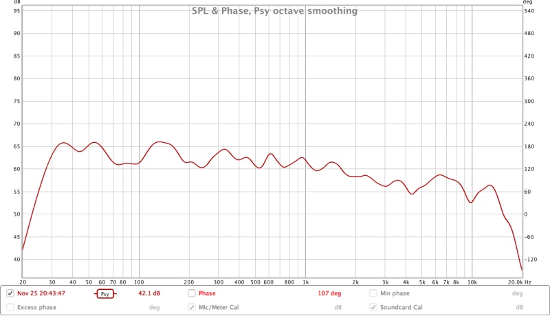

Holy Guacamoly!

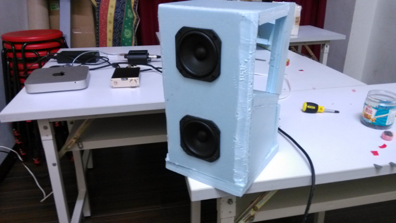

What did I just do?
Inspired by the renewed interest in this thread, I took my little clone I made a while back.
I decided to try all sorts of setup and see where that brings me.
At the moment, the bottom driver is sealed, I will need to add a port to bring it up to about 80Hz, I believe...
Now, here's the run down.

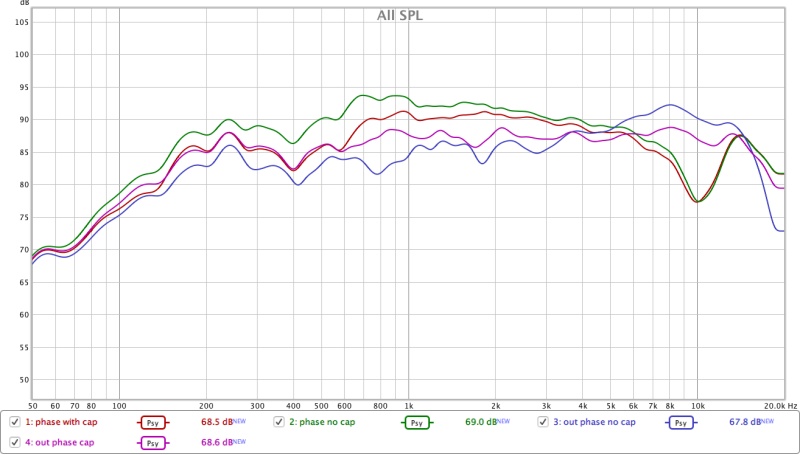

I tried the 2 drivers in phase, without a cap (I only had a 22uf) on the top one.
Then, 2 drivers in phase with the cap on the top one.
For fun, I tried to wire the drivers out of phase, no cap.
And finally again out of phase, with the cap.

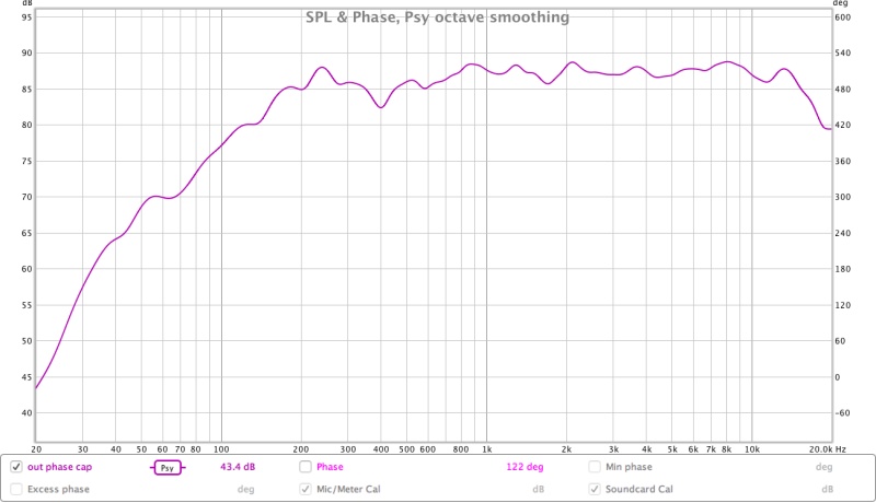

And here is the result of that last test. My jaw dropped. It sounds so natural, it's crazy.
So, all of you out there, give it a shot. Invert the wires on the top driver.
Now, I'll add a port and try to get f3 a little lower to easily match it up with a sub. I already have the tube, I just need to cut a hole in the back when I have some more time to play.

Looks very nice! I think what might be happening is that the inversion took care of the baffle step by canceling some of the top end. Have you tried both sealed and in phase with a BSC? Should be flat like that as TC9 is naturally flat. Or perhaps both open baffle and BSC.
Here is dual TC9FD in sealed Nautaloss. No BSC or filter of any kind.
Looking at my response vs yours, I suspect that the rise above 1k on mine is what is cancelled by your inversion of the OB. 22uF in 8ohms impedance is 900Hz 1st order high pass filter.

How wide are those boxes you built? They look wider than the ones I built which could be an illusion, I suppose. Also, the ones I built have the drivers flush and are well rounded over. I have no idea what effect this has on BS, but in these instances, I like to consider all the details as I try to learn about these things.
And, doesn't wiring two 8 ohm speakers in series result in a 16 ohm? Wouldn't you have to use the 4 ohm (TC9FD00-04) version to make it an 8 ohm system?
Reason I ask this is I am not finding any shortfalls or audible room for improvement. The EQ I have applied to these is real close to what I use on just about every speaker I have in this room.
I did try switching, one, to play against each other and then both and I was not fond of the results. The clear highs were muted even with EQ. Switched it back and it's fine again.
baffle is about 22cm (8 1/2").
It was a quick build using blue foam boards and yes, I didn't bother trying to mount them flush. Yes, I'm sure it would help a little there.
My understanding is when you introduce a XO into the mix, each driver behaves as a single, and two 8 Ohms drivers retain 8 Ohms overall. For confirmation, I ran DATS on them, and yes, they were still at 6.8 Ohms total, but I noticed Qts has increased to 1.2
I'll try measuring them in another room to test

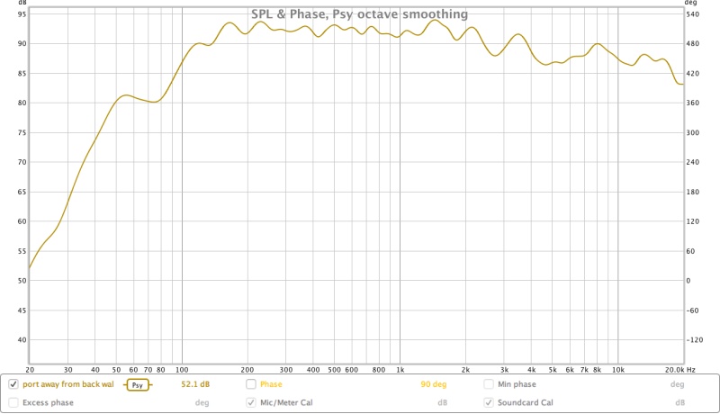

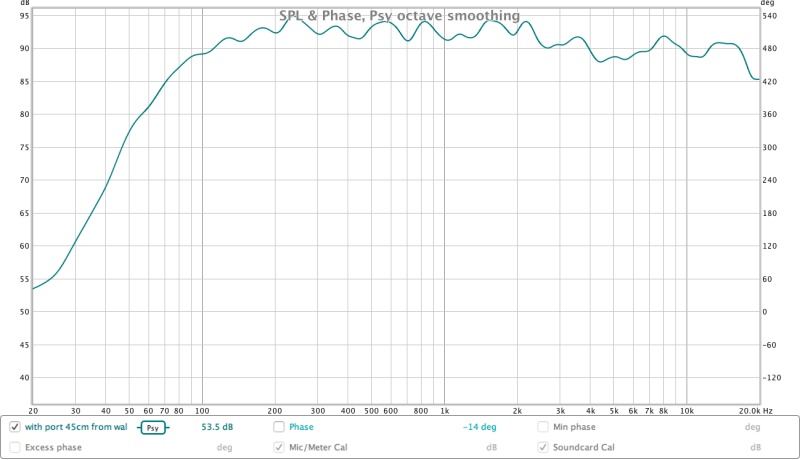

Had no time to set up again, but this afternoon, I cut the hole and installed the port. 1" diameter, 2" long.
There's a little improvement when the speakers are 2m from the back wall, but much better when they are 45cm away from the back wall. As good as any small bookshelf speakers out there, and stil, a nice flattish FR.
This room picks up bass like crazy. It's because it's small and there are bass traps in all 4 corners of the room, so a lot less cancellations due to bounce. It's not thumping like the TABAQs, but it's believable.
Next step, build a second one and listen in stereo! It's all been mono so far.

Mine are 5.5"W with continuous round-overs. I have the driver mounted in the sealed portion higher towards the roof of the sealed box, and the port, as far onto the bottom away from the driver as possible but not quite touching the bottom panel.
Now granted, I cannot take measurements, but there is nothing audibly missing from the music I am familiar with, and no portion of the mix more or less proud than the other with regard to balance and they are neither warm, or bright. The subwoofer is blended as such, that you would swear the bass is coming from the tiny speakers, or that the rest of the frequencies come from the subwoofer, depending on what you are focusing on. The only performance change is that these speakers open up more at mid volume. Weirder yet is, if you go right up to the drivers, they are relatively quiet point blank, and louder starting at about a meter away. I imagine this is due in part to the dipole effect and the port effect with room effect merging.
I have these speakers mounted on stands, approx. 40cm from the wall behind them, and about a meter from the side walls.
Like most good speakers, they are a bit revealing with recording quality, except perhaps with near field use at lower SPL being a bit more forgiving in that regard.
Oops, I "guesstimated" the dimensions last time as I wasn't near the speaker. It's actually 7" wide baffle.

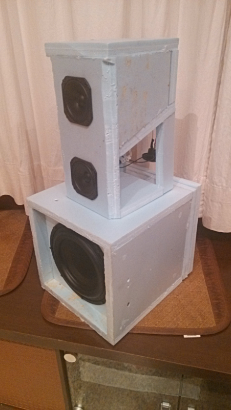

I have this idea of taking the Brio, inverting it, and putting a small subwoofer underneath.
Kinda like this, but as one unit, one cabinet.

What's the idea behind inverting the Brio? Won't that cause a loss in some of its soundstage?

Why would they lose soundstage?
Because the OB one will be sandwiched in the middle?
Remember, the Brio have a "roof" on top, so, they are only opened to the sides and back.
