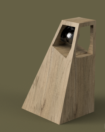

I scaled the pictures on the internet for the speakers. I used 18mm plywood. I made the boxes 5.5"WX12"H. For the slanted portion of the sealed box, the low point is at the halfway mark O.D. It then raises at 15 degrees to the front. The open sides start at 7/8" reveal from the front baffle, 7/8" down from the roof, 7/8" from the rear, if that makes sense. The portion of the hole that matches the slanted portion is a 1/4" above that roof. From the bottom, the driver centers are roughly; 4.33" and 9.5".
Yes, I used a 20uF cap, the more expensive one. Dayton Audio DMPC-20 20uF 250V Polypropylene Capacitor. Part # 027-436.

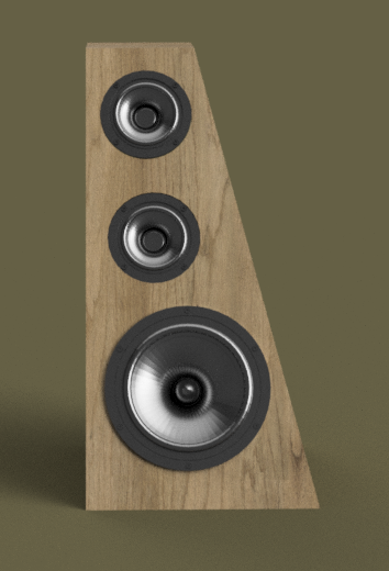

I'm thinking about upgrading this idea, and include a woofer directly in the build.
Using a different shape, and not bother with a crossover for the bottom woofer, instead using a sub amp to drive them separately.
I like the renderings I made.
I think I will slowly build them.

All separate. Probably will do the middle one sealed as well. No point in going vented for that one with the woofer underneath.
The woofer will be in about 15 litres, the middle in 2 litres, and the top one OB of course.
Drivers are four Visaton B80 and two W8-1363sbf.

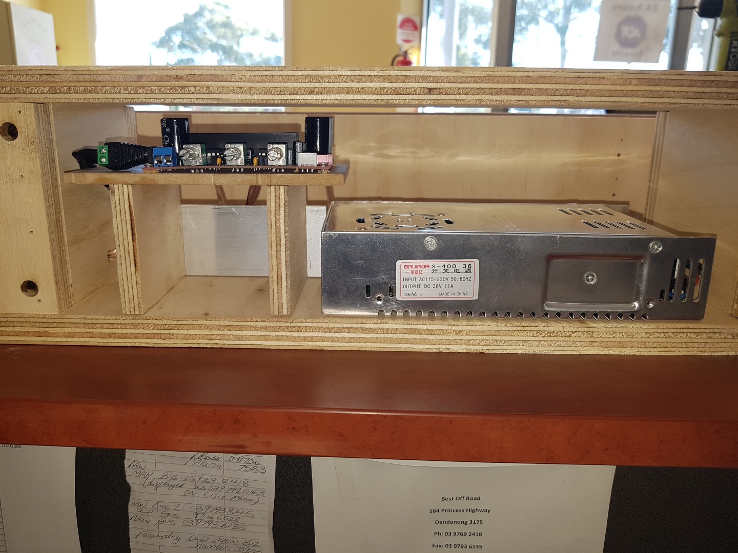

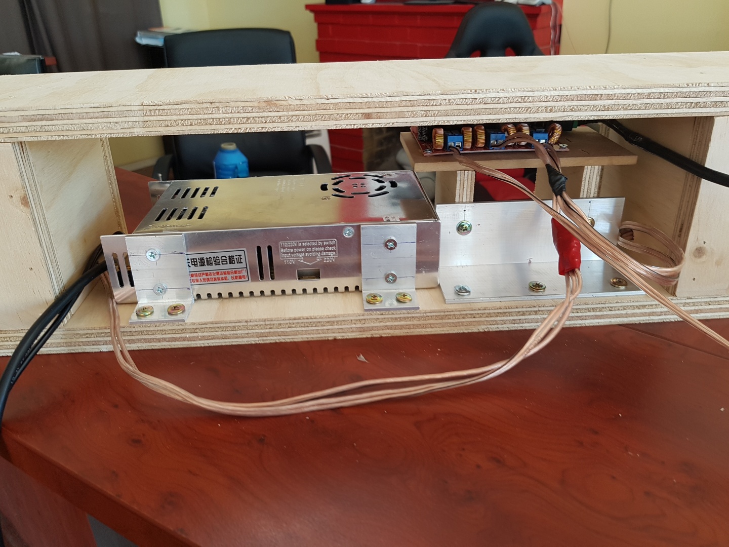

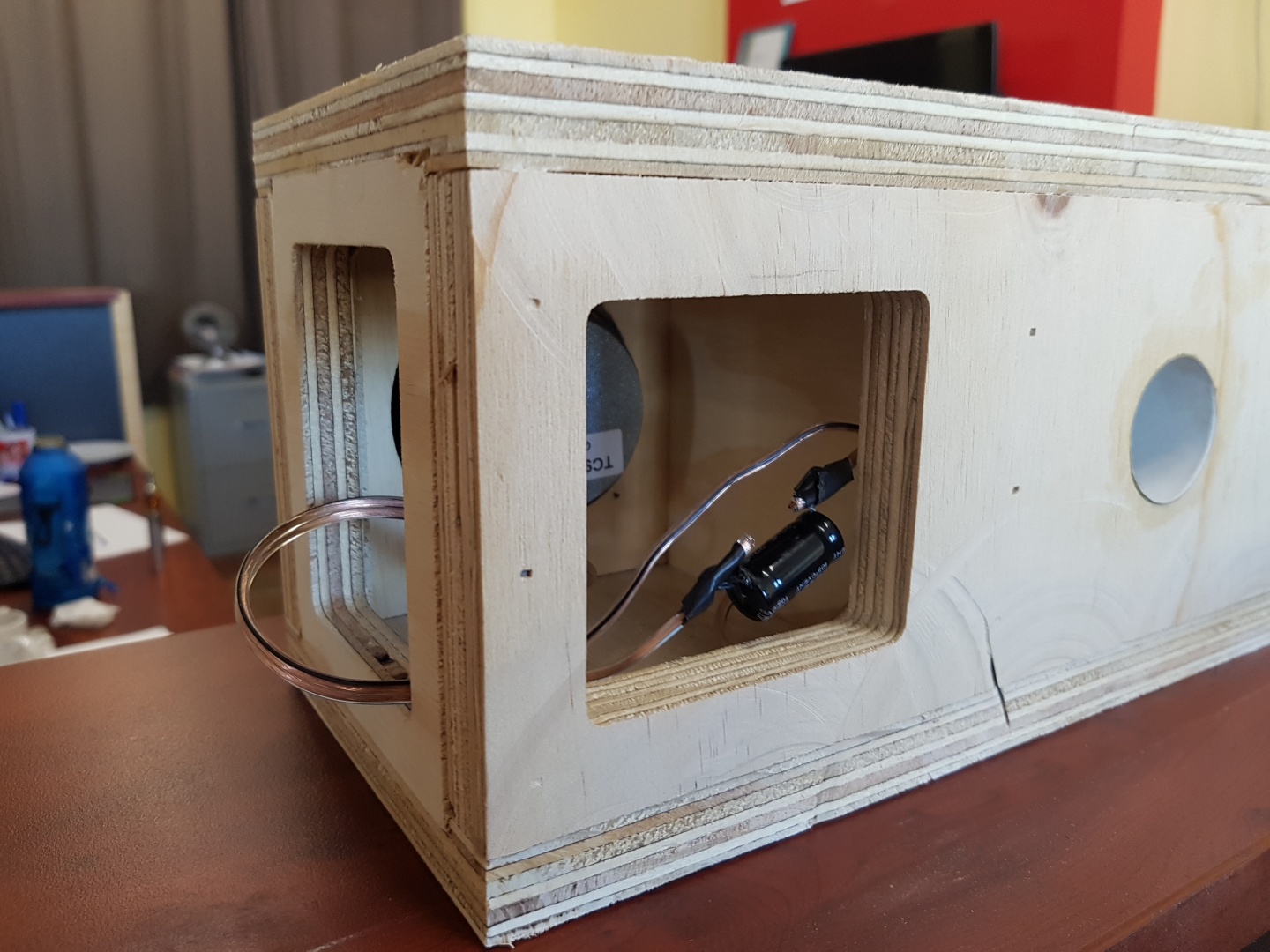

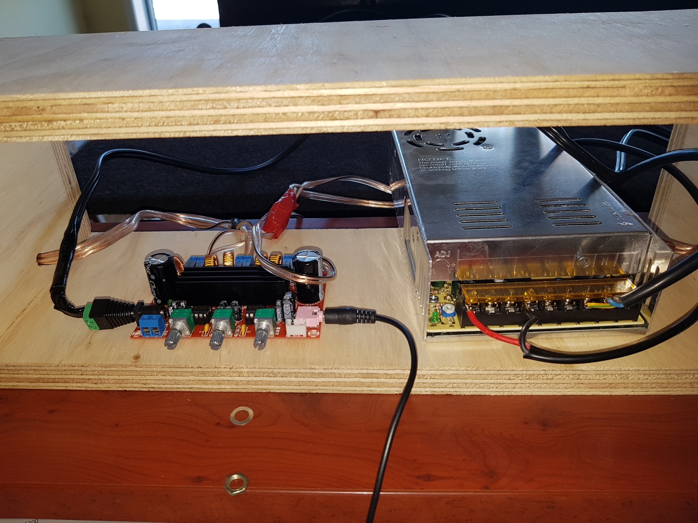

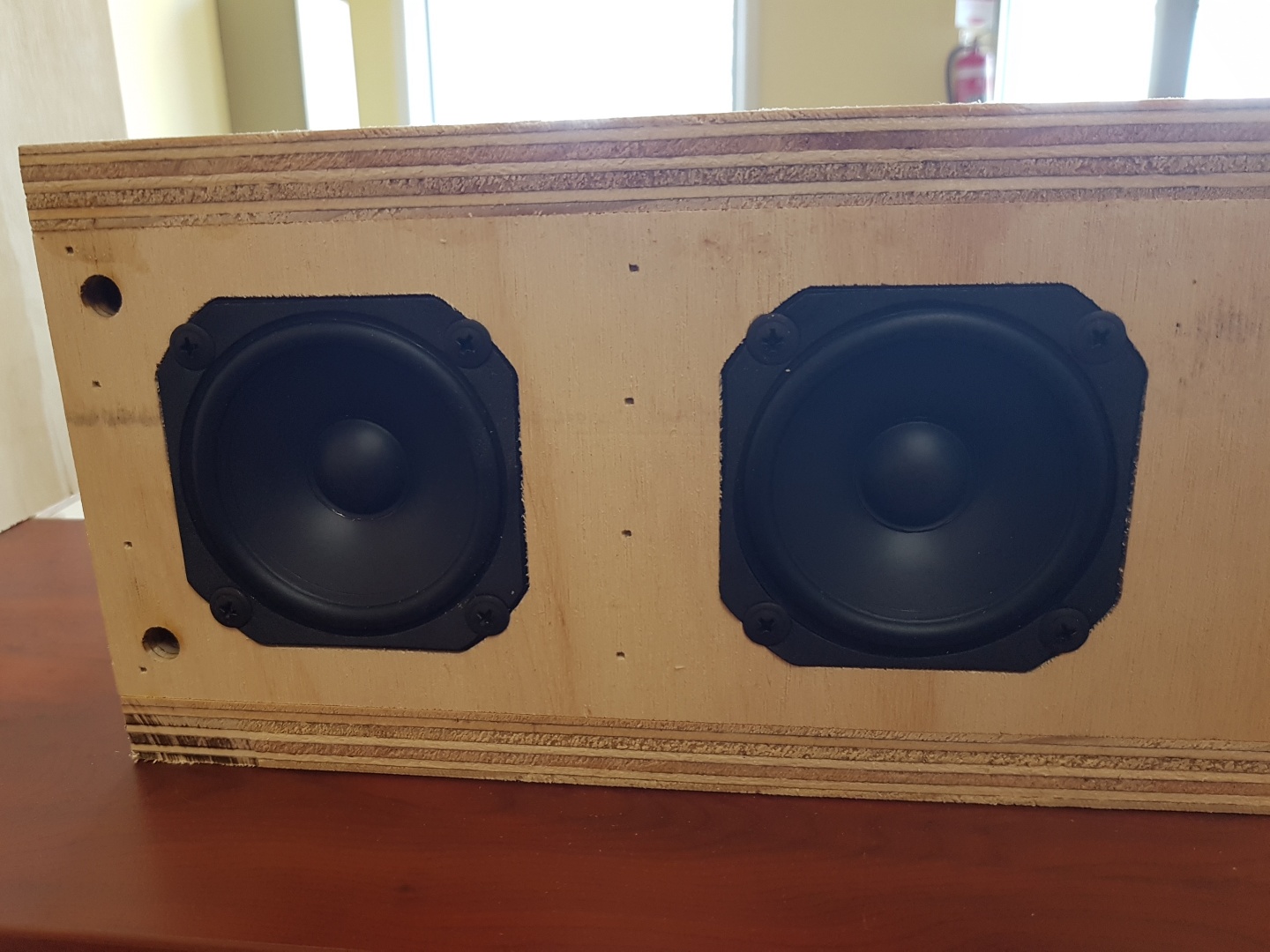

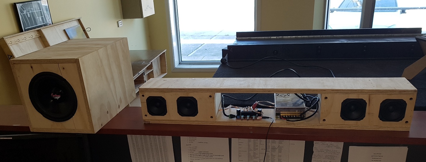

Latest soundbar folks. Design based on a clone of the Nola Brio Trio satellite/sub system. Running as a 1.5 way, simple setup, 2 TC9FDs in parallel with the outer being open baffle with a 22uF cap. Sub is a Dai Chi CS80.
Amp is a TPA 3116 2.1 which drives the sub as well. It could do with a little more juice for extreme volume but it cranks up loud enough for enjoyable music listening and TV/movies. Drivers are yet to break in but it already sounds great. All up about $160 (Aussie that is, you lot in Europe and the USA get stuff way cheaper than we do).
Those TC9FDs are just remarkable little drivers at the money.
