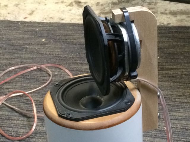

Playing around with my new Galaxy Audio (bottom right).
The plan is to put some of these speakers in the wall soon for an infinite baffle configuration with bass support below. I'm a big fan of the W5 Tang band (incidentally I have the venerable TC9 also and I can tell you that open baffle I'm hard pressed to tell the difference between it and my W5, the W5 just does more bass in a sealed box which is another reason I like it so much🙂).
Nevertheless, the W5 and TC9 are a bit shy on top. I've been using the 3 and 4" Faital's to make up for that, they are anything but shy on top, but they get a little fatiguing for my ears and don't always sound "natural" and as lush as I'd like.
So I pulled the plug on the Galaxy Audio. For the $52 price of admission I gotta say this is a very well behaved, great sounding driver and well made. Neodymium magnet, aluminum frame, heck it's even got ferro fluid. It's a touch louder than the Tang Band, 92.5 vs 90, but that doesn't seem to hurt their harmonizing at all.
It sounds terrific in this hybrid, sealed, Brio Trio even without a 20uf. I can't wait to get it inside the wall where I think they both belong, but I'm enjoying them quite a lot right now.

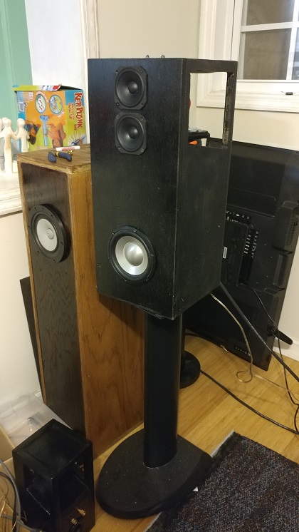

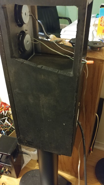

Hi guys,
I started a new thread in the multi way forum for my new build. I am playing around with the Nola Micro Reference Gold. I also posted some pictures with it. They sound really great but I would like to try them with the 5" woofers in the cabinet. Do you guys have any suggestions for solid 5" woofers?
