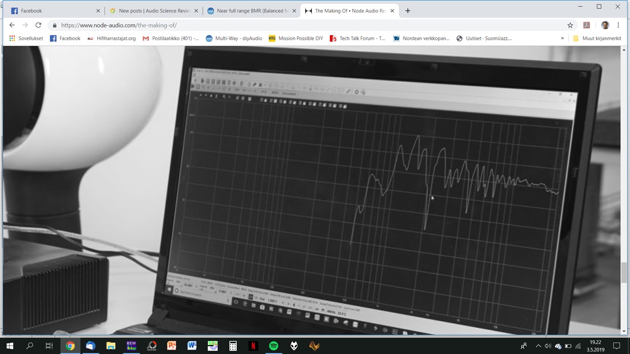

Finally a new BMR based speaker that looks impressive, with some serious investment in 'tooling'
What do you guys think, novel approach to bass.

Would need to see some measurements, and hear how they really perform.
Makes me wonder how low it goes and how loud with moderate distortion. The TL exit area is not huge, neither the midrange membrane...
It would be nice to read that this thing breaks the laws of physics!
So, it's a 3-way and this might be BMR (+tweeter's) response in nearfield
Frequency response in their spec page.
Yep, and kinda weird that it starts beaming at 3kHz, when all they talk about on the page is how wide the dispersion is....
