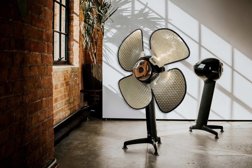

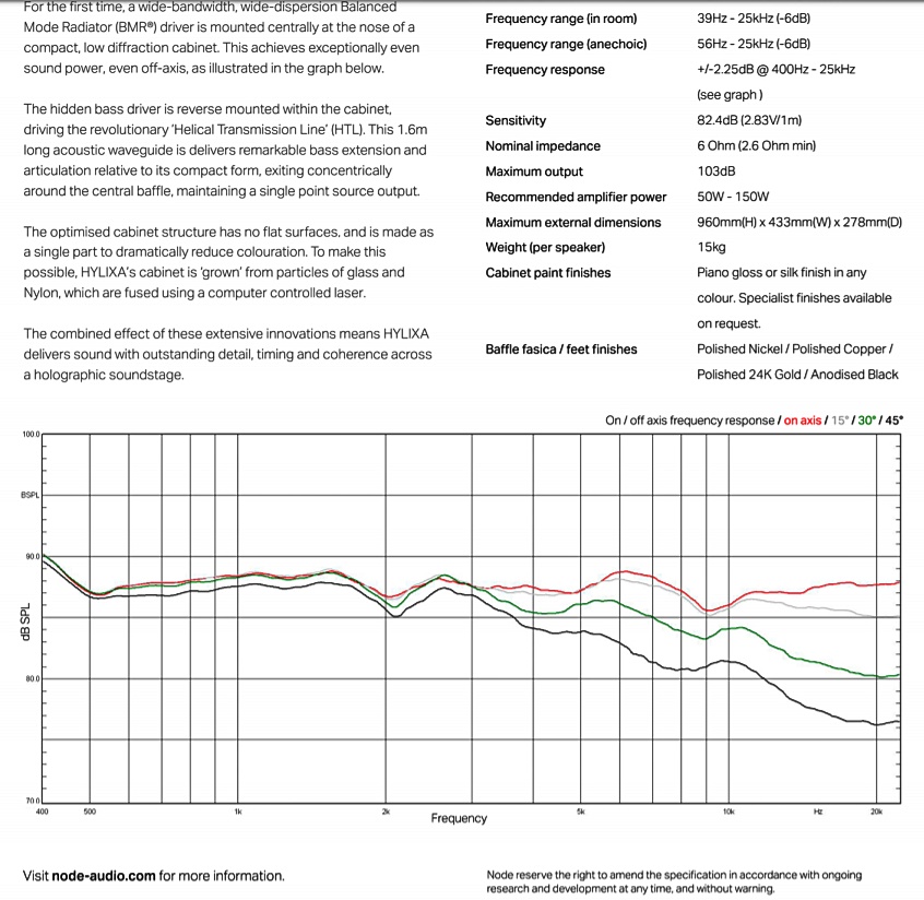

But hey, isn't the Node Hylixa's bass basically a compression driver? I can see only one route for soundwaves to exit.
Specifications show measured response, nothing special to brag about actually
https://www.node-audio.com/docs/hylixa-specification.pdf
