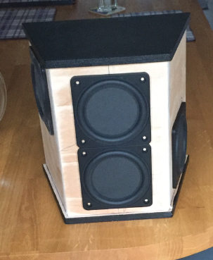

In my opinion it will be correct to use 4 speakers TEBM65C20F-8 and 4 speakers TEBM35C10-4. This will ensure sufficient sound pressure in both bands with minimal distortion. I got a good result with a crossover point at 1kHz. Near full range BMR (Balanced Mode Radiator) pictures in post #537

It seems that the theme has completely died down, it's time to show something new
What's the port looking thing at the back ?
This is the implementation of such a construction http://www.tornadoacoustics.ru/content/tech/PatentDE10338313A12004.10.21S1.pdf
