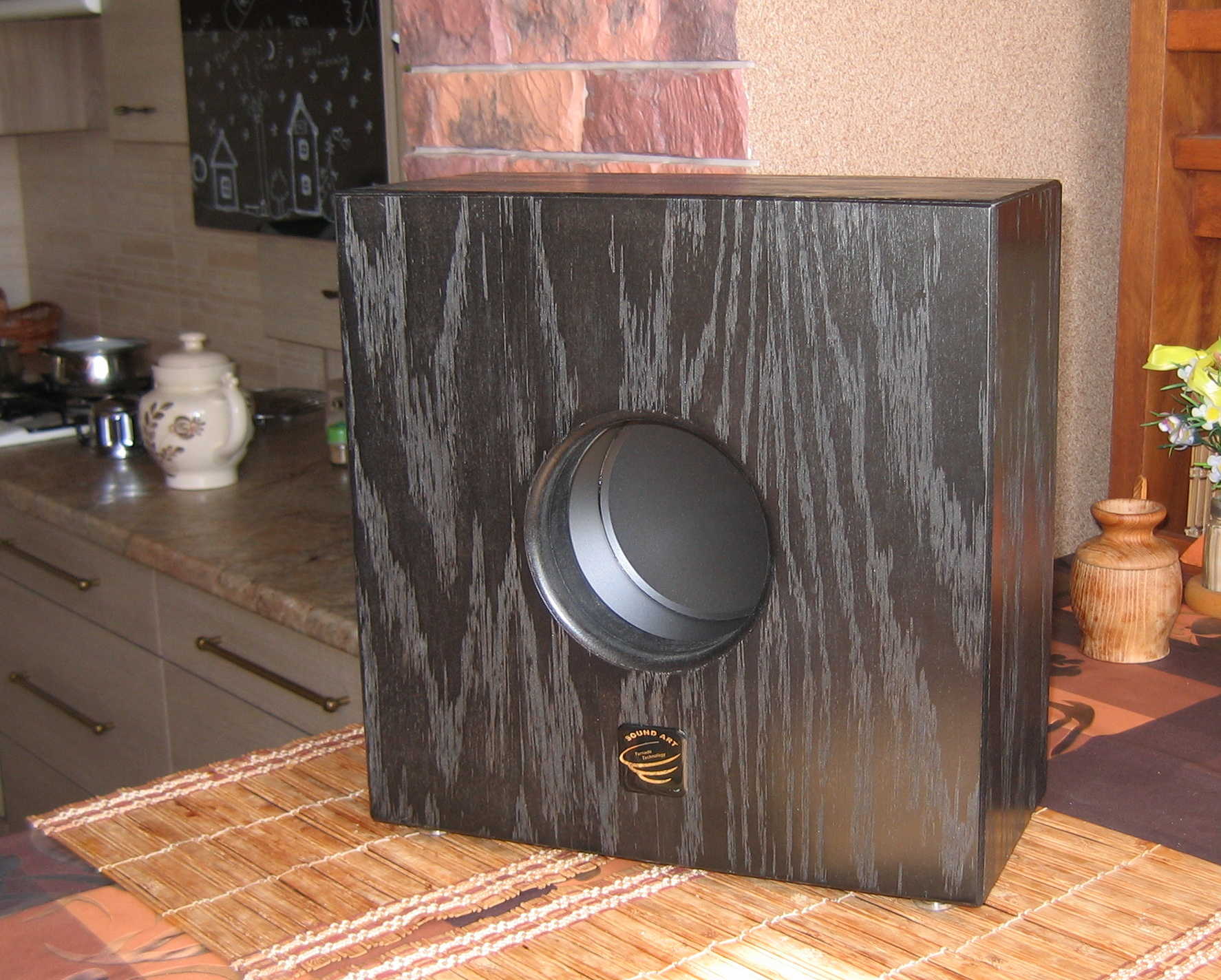

Near full range BMR (Balanced Mode Radiator)
And of course, it is very important to build the right subwoofers to work with BMR speakers
It seems that the theme has completely died down, it's time to show something new
Where did you get the square frame BMRs?
I bought them in Moscow from a small local home theater company.
