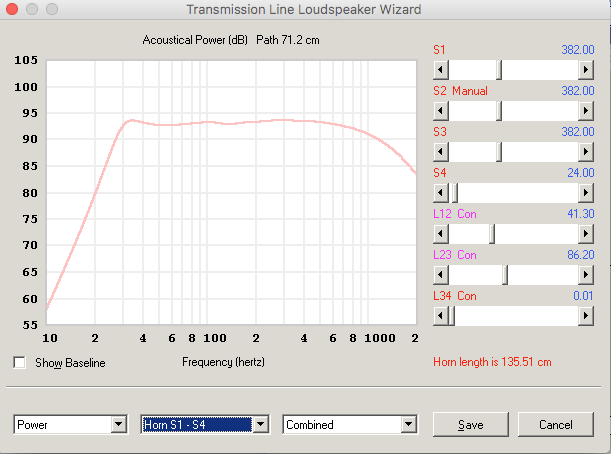

Looks nice, and seems to sim well in a MLTL.

Trouble is that most BMRs are about 80dBs, so you will need to pad that woofer if the 90+dBs is true.
The QTS is given as 0.831 so I thought it worth a go as the alternative application, and only other application I have seen using this driver is a transmission line set up by ‘Curvi Speakers’a novel looking design but to big and complex to emulate.
