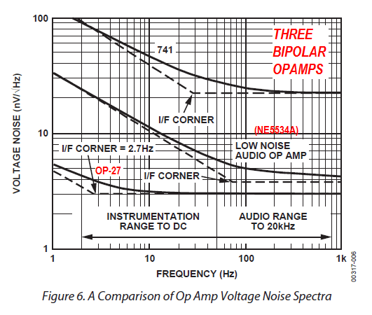

The CMOS opamps all have stirling performance except for 1/f noise which is very high IMV although Marcel has said he doesnt think it’s an issue. Scott Wurcer remarked on this site a few years ago that he had to push for low(er) 1/f noise when opamps were being spec’d at ADI.
I have settled on the JFET OPA1642 for general low level signal work and the OPA1612 for bip inputs. The OPA1612 makes a very credible MC head amp for 500uV level signals.
One way to reduce 1/f noise in a CMOS opamp is to increase the gate length and also the gate area of the devices in the input stage. Increasing L gets you away from the short channel effects, but you then need to increase W to get a decent gm. Increasing A decreases 1/f noise. The only trouble with that approach is that the input stage devices become enormous, thus, more capacitive and more expensive. Basically, you end up having to trade off cost and bandwidth to get lower 1/f noise. Opamps tend to be cheap so the bean counters often win that battle.

Engineering is always about trade offs! I guess low noise audio isn’t on everyone’s radar and there are good alternatives in TI’s portfolio for that if needed. CMOS opamps are great for filters, line stages, headphone amps etc.

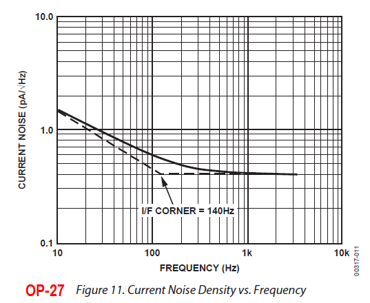

Alas the OP27 has bias current cancellation circuitry, so when the inputs see difference impedances (as in most low noise preamp situations), the actual current noise is higher than those curves suggest. With equal impedances the cancellation circuit noise cancels out, otherwise it adds to the noise signature and makes the device noisier than a NE5534A - basically the benefit of low bias current comes at the expense of more noise in practical circuits. Sometimes datasheets admit this, often its ignored.
I made the mistake to trying to use an LT1115 (I believe it has bias current cancellation) in a phono preamp with a cartridge that has nearly a Henry of inductance (Stanton 680, sadly no more now that Stanton has imploded) - hissed like a nest of snakes... Scott Wurcer fixed me up with some AD745JN samples, and that de-hissed it. That same preamp is still doing yeoman duty in our radio station main production studio, going on 20 years now.
It certainly has bias current compensation, like the quite similar LT1028 and LT1128. Linear Technology managed to design and specify it such that the actual input noise current is as much as some 10 dB above the differential noise current, see https://audioxpress.com/article/boo...spice-models-to-simulate-vintage-op-amp-noise
