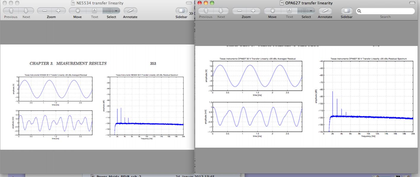

In inverting mode the 5534 is hard to beat even by recent opamps, i pointed that it was recomended by TI as I/V
converter for optimal perfs and it s used in inverting mode, the LT1028 is recomended only for the following stage.
FTR here a measuremet and comparison with an 0PA 627 made by a member of this forum years ago :
