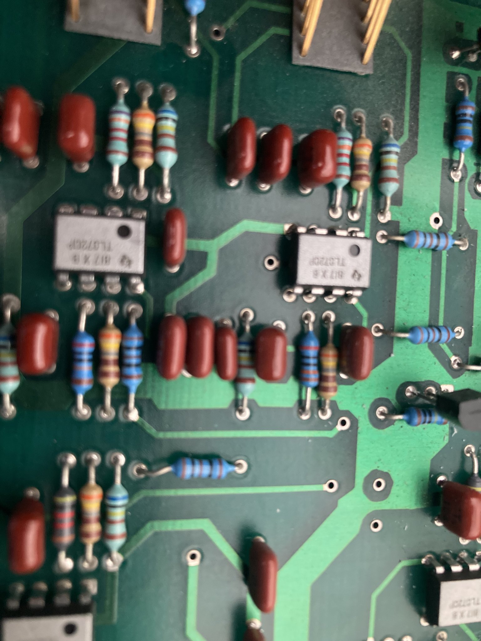

TL072 could be because a high input impedance was required in some parts of the circuit, LM833
is surely for the lower cost than 5532s.

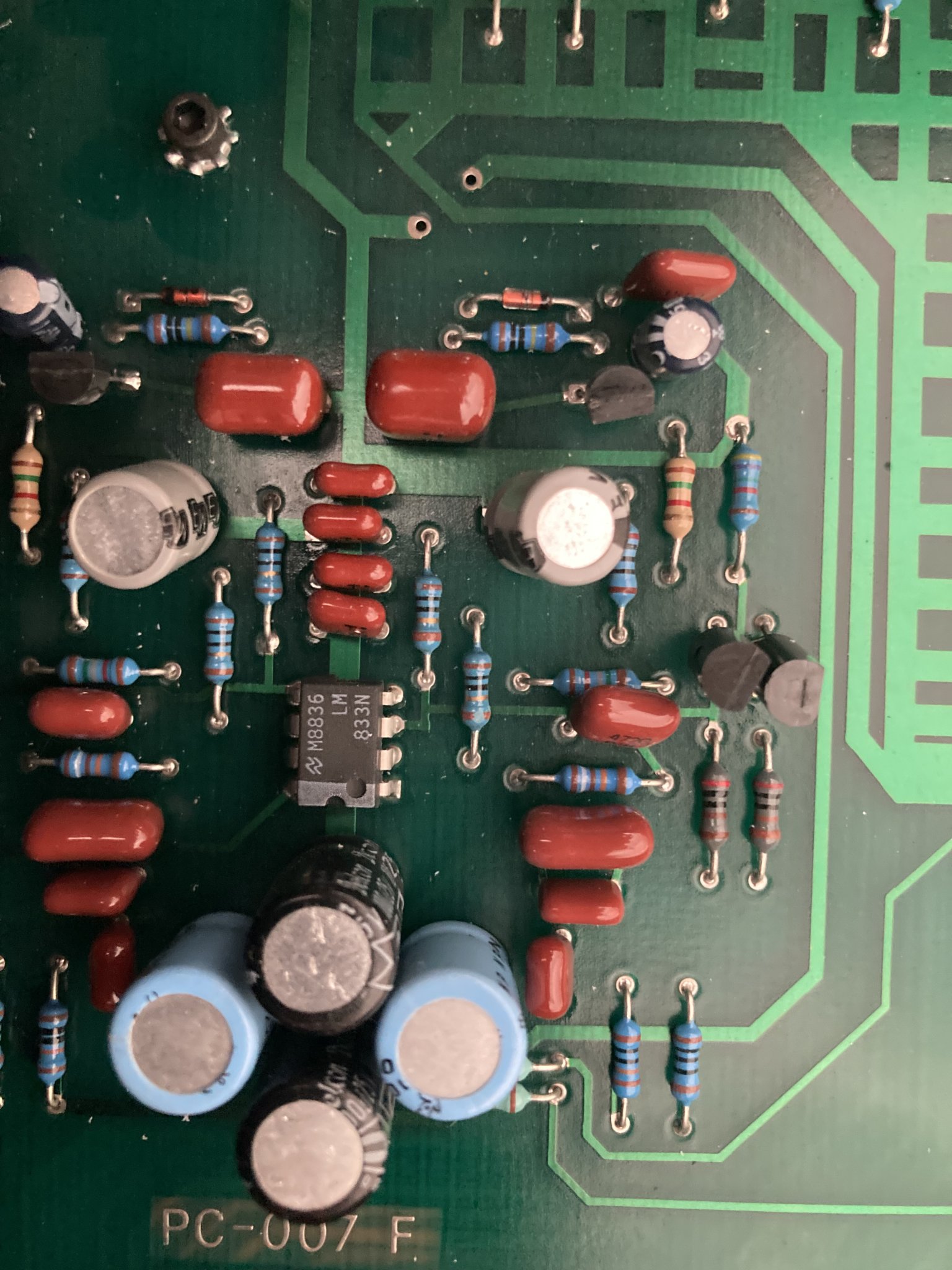

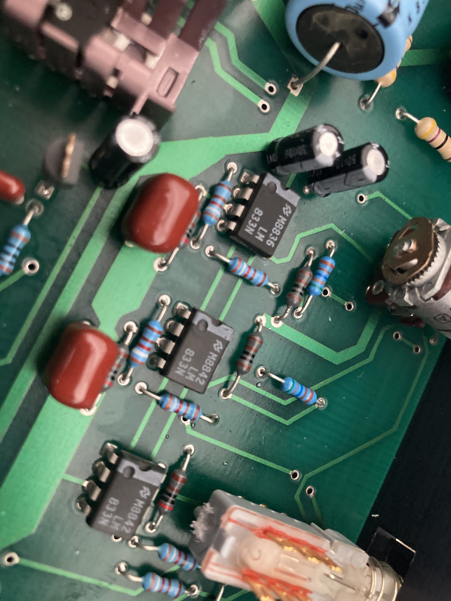

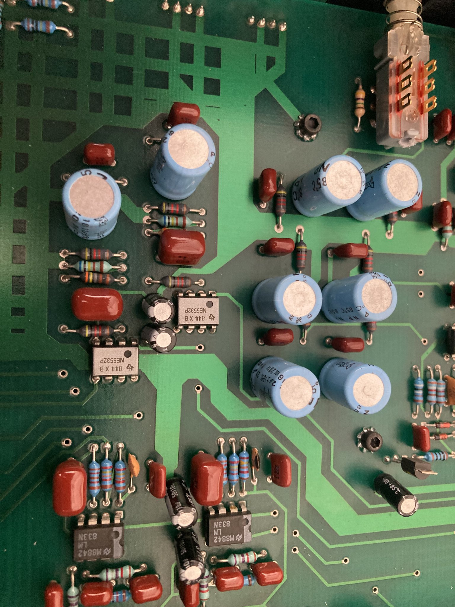

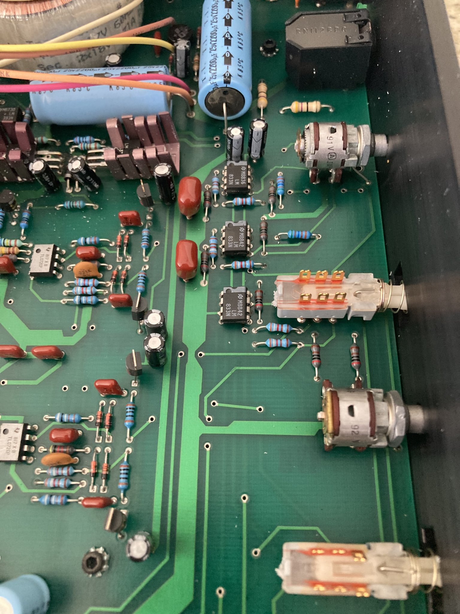

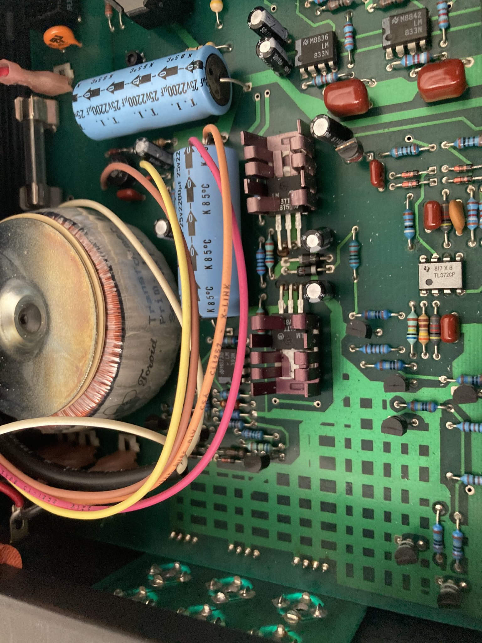

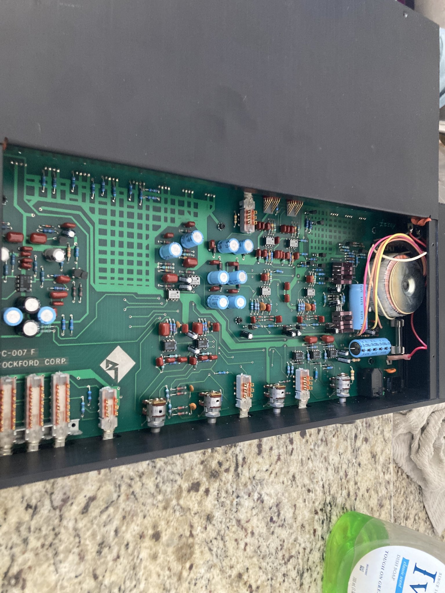

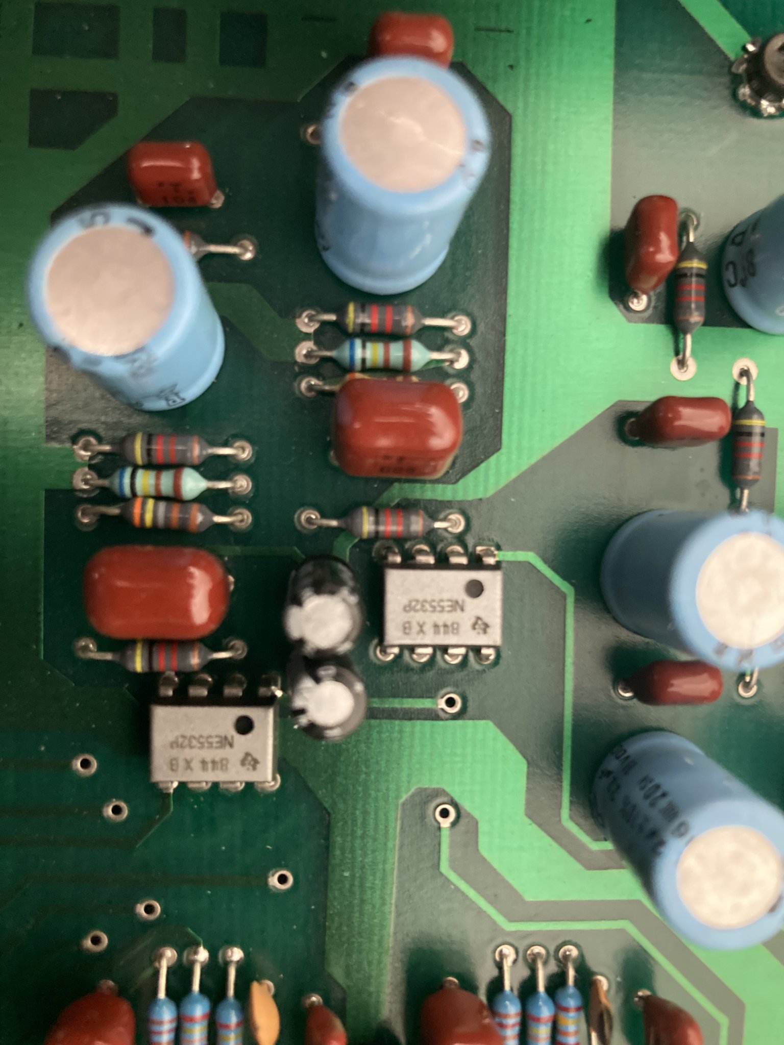

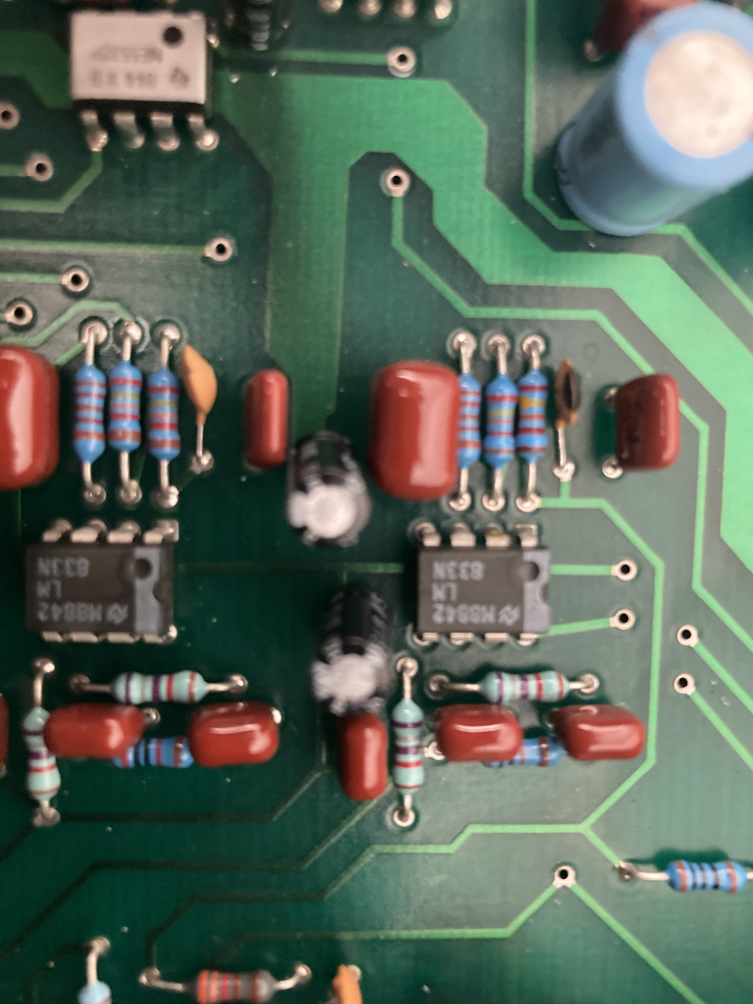

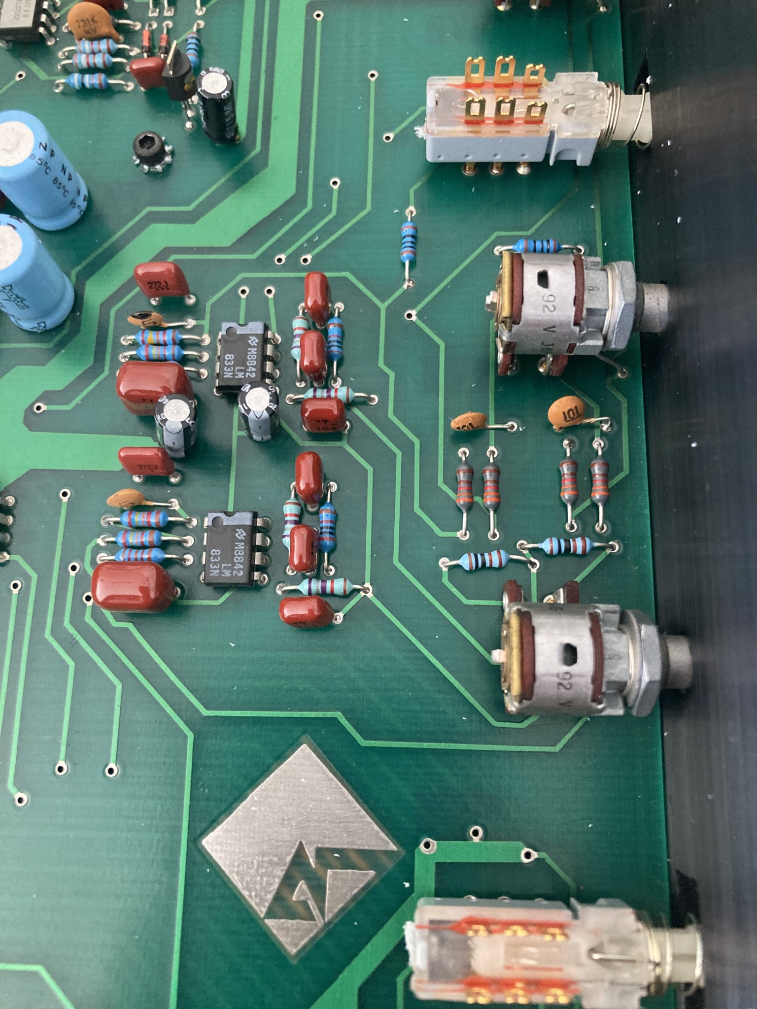

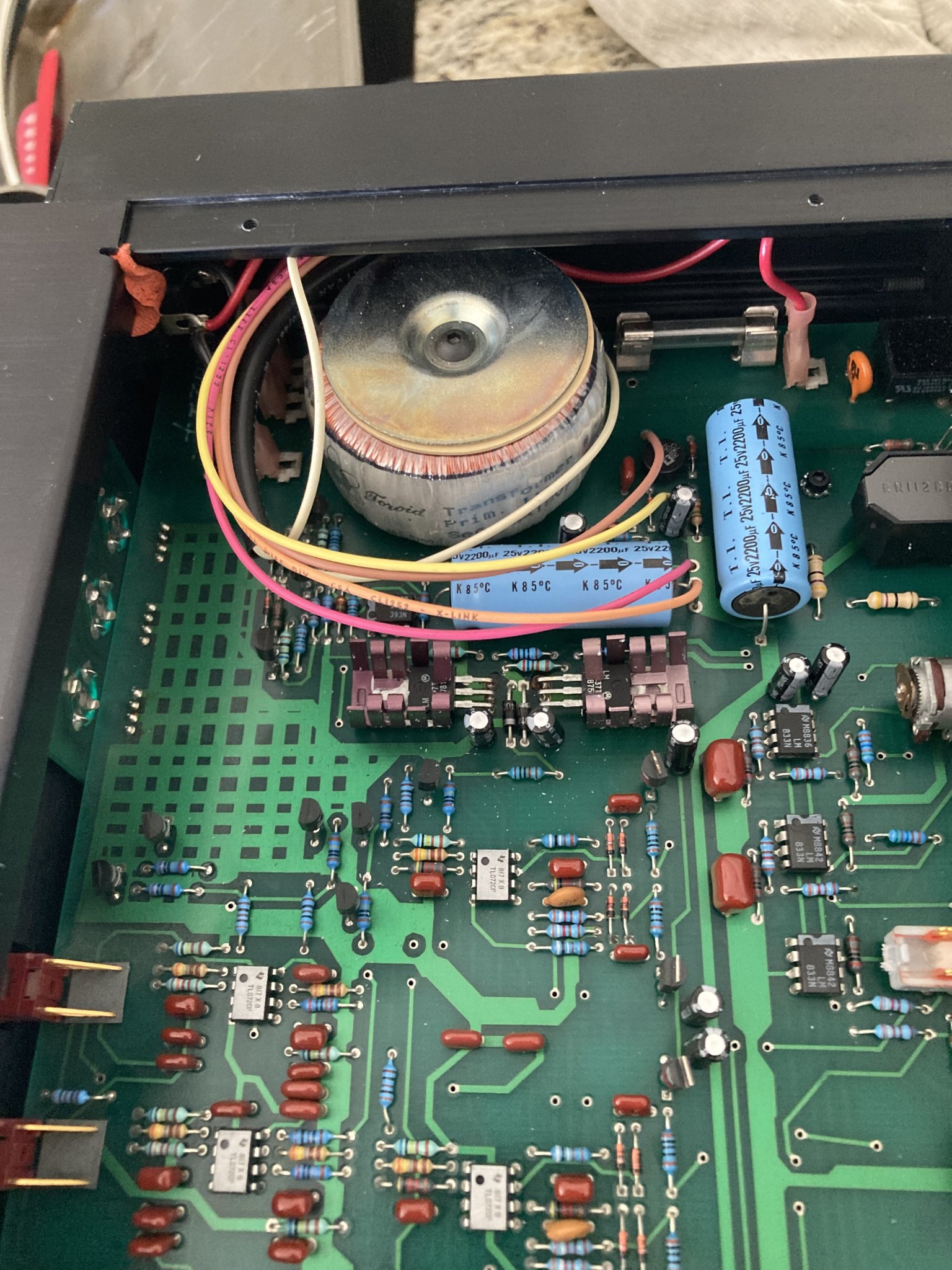

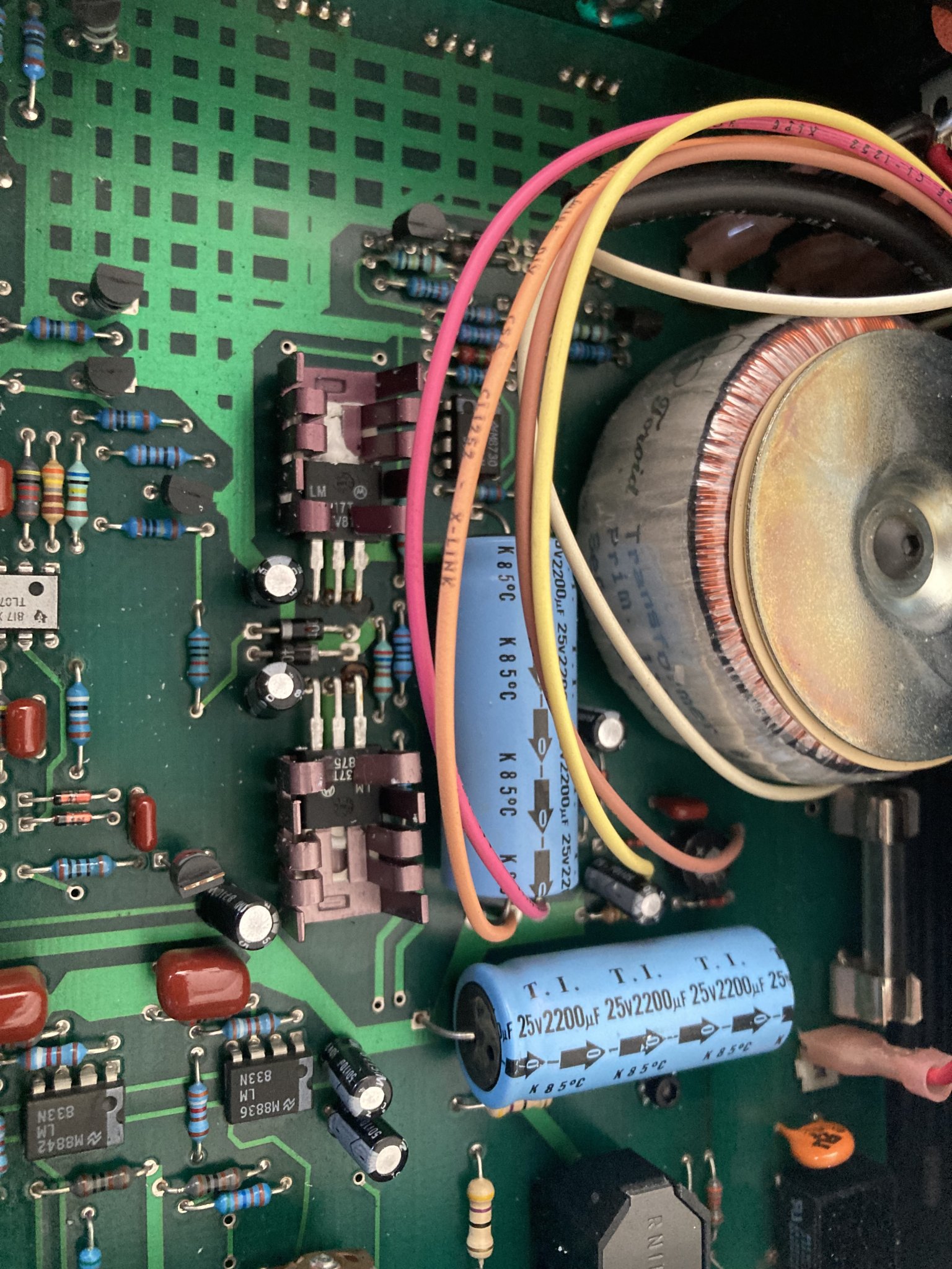

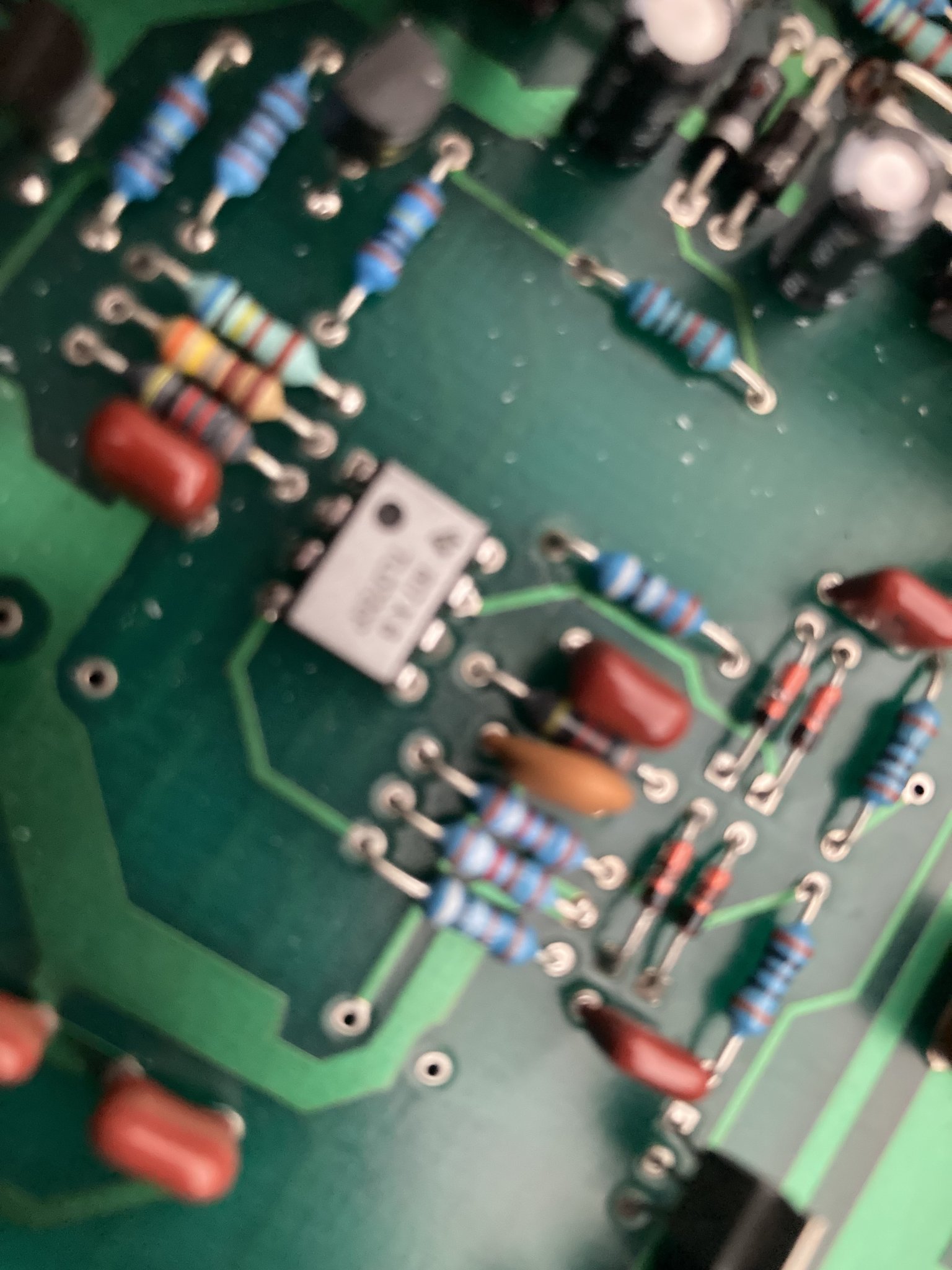

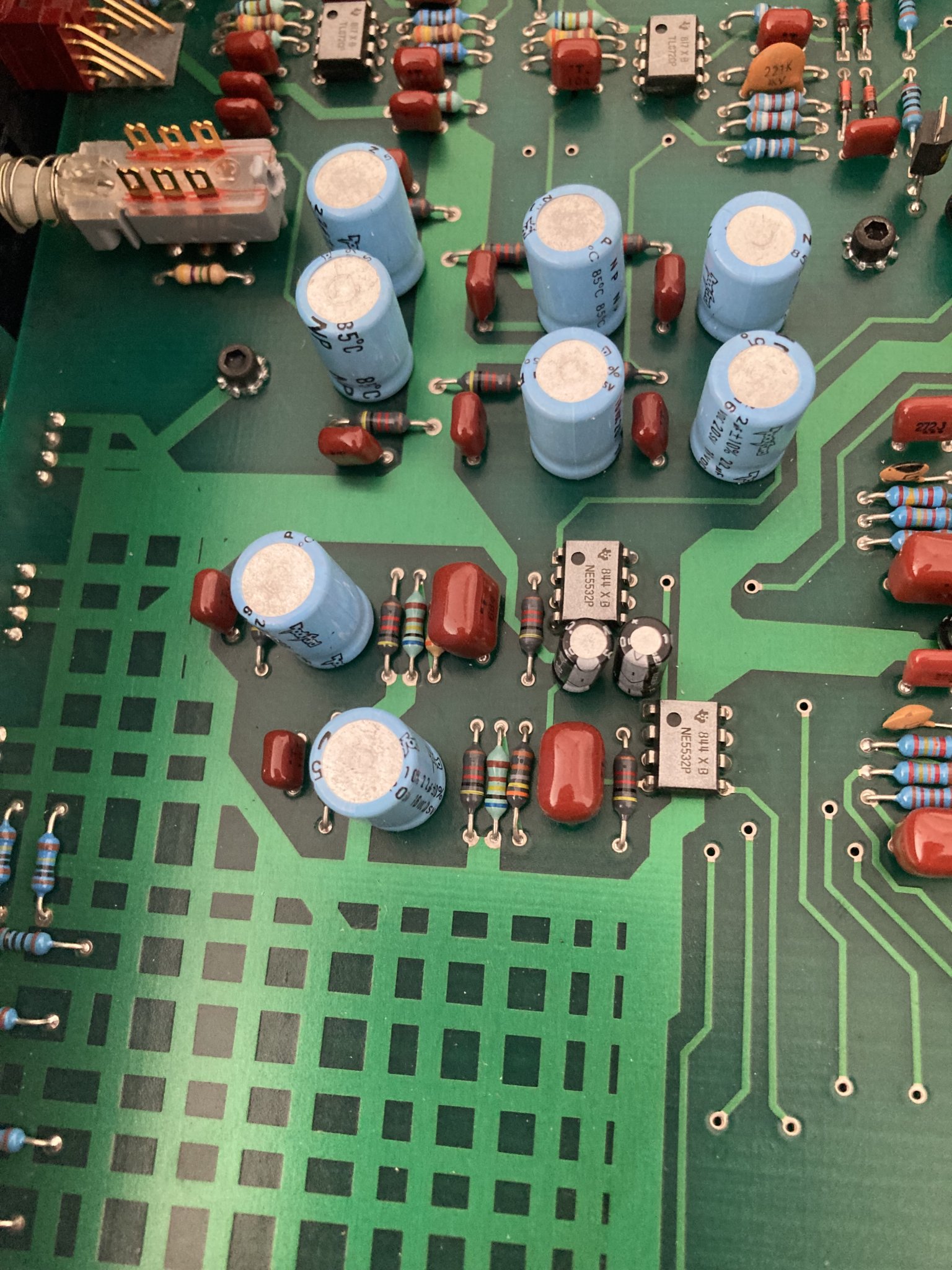

30 or 40 years ago people didn't have the measuring devices to determine the qualities of op amps. The few op amps that were available were used.I wonder why they used those op amps in this preamp
2x 5532
4x TL072CP
6x LM833
1x LM393
It makes not sense
Very rare Rockford Fosgate RF200
no schematics or anything only a few reviews out there
2x 5532
4x TL072CP
6x LM833
1x LM393
Take a look at the LM393 datasheet ; it is a dual voltage comparator, a 1-bit Digital To Analog Converter. It is not an opamp. If you attempt to build linear analog amplification circuits with the LM393, you will encounter instability (oscillation) because the chip does not include frequency compensation. Voltage comparators never do.
Rockford Fosgate's designer felt that some aspect of the design required a voltage comparator (not an opamp), and chose the LM393 for that position.
I disagree with that general statement. There existed different types of op-amps for different tasks - not one size that fits all.30 or 40 years ago people didn't have the measuring devices to determine the qualities of op amps. The few op amps that were available were used.
How can the TO assume that the different stages inside the circuit all use the same amp?
Without the context, it is impossible to judge the choice of op-amps
At the time NS themselves stated that the LM833 could replace a NE5532, so it was meant as a cheaper replacement,
wich it didnt manage to actually achieve, remember that circa 1978 you couldnt manufacture a 5532 without
paying royalties to Phillips.
If a replace the Lm833 with 5532 no problem with oscillating?
Both op amp have the same power requirements?
If it work no need to fix it, in principle there will be no audible difference, so why bother with the hassle.
