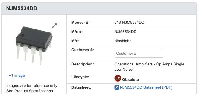

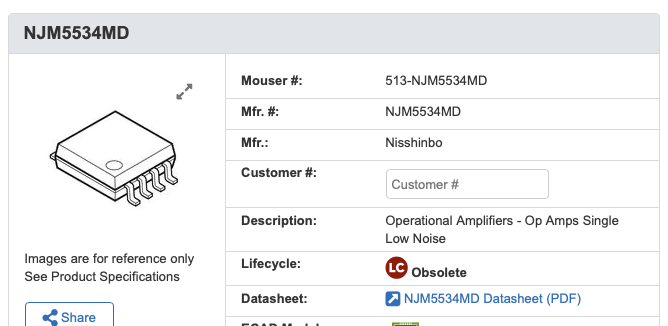

The equivalent of the NE5534A is the NJM5534DD/MD - these are the versions with guaranteed-by-testing low noise performance. You try getting those!

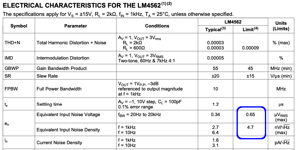

Ah... That's not entirely true. Voltage noise is tested in production as noted in the data sheet. Keep in mind that the spec table in the data sheet is a binding agreement between TI and the customer. If a number is in the 'limit' or min/max column it is measured in production.The LM4562 of course has 12dB more current noise than the NE5534A and the issues with high susceptibility to RFI, no production testing for noise (with large variation by all accounts).
Current noise is not tested from what I can tell. If you're concerned with current noise, the LM4562 would not be your first choice anyway. The OPA1642 would be better, as mentioned earlier.

Mouser says:The equivalent of the NE5534A is the NJM5534DD/MD - these are the versions with guaranteed-by-testing low noise performance. You try getting those!

You didn't read footnote (4) - you don't get far in datasheet land by ignoring a footnote, the bad news is hidden there....Ah... That's not entirely true. Voltage noise is tested in production as noted in the data sheet. Keep in mind that the spec table in the data sheet is a binding agreement between TI and the customer. If a number is in the 'limit' or min/max column it is measured in production.

Which basically means its statistically sampled, not tested for every die.(4) Tested limits are specified to AOQL (Average Outgoing Quality Level).
There have been several threads here about how a significant proportion of LM4562's have abnormally high 1/f noise (with popcorn noise), again evidence that noise is not tested on every die (it takes maybe minutes to screen for 1/f noise so its a production expense they don't want to have)

1/f noise and popcorn noise in bipolar devices are mostly current noise, which isn't guaranteed anyway for the LM4562. By the way, NE5534A noise is also sample tested (or at least it was when Philips made them).

Tells me that NJM is obsolete, but substitutes are available in decent quantities
