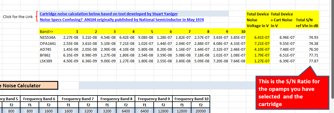

I just realised I should have said there’s nothing in practical terms between a 5534A and a OPA1641 - the 5534A is about 0.5 dB better. Neither here nor there in my book.Because of the noise shaping by the RIAA EQ amplifier, you can do slightly better with an OPA1641/2 than a NE5534A and you get better RFI to boot. The SNR figures below are the absolute best case for a standard RIAA EQ amp with a cart of 1000 Ohms and 500 mH, 47k load and 125pF input capacitance (c 1.5-2m interconnect cable from T/T to phono amp). The gain setting resistor for these results was set at 110 Ohms (which is what the X-Altra MC/MM used but with paralleled LSK389/JFE2140 devices for the MM stage).
Of course, the OPA164x devices are a lot more expensive.
Data below from the Hifisonix RIAA noise calculator you can find here https://hifisonix.com/preamplifiers/so-just-how-quiet-is-your-phono-stage/
