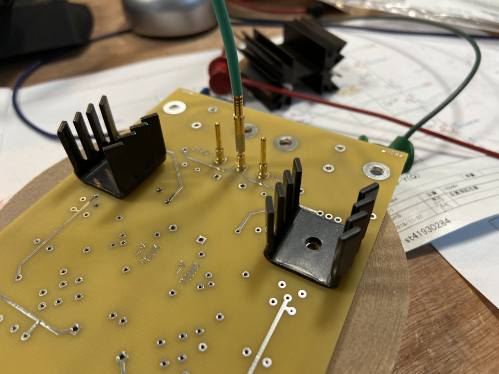

this is slightly off-topic but would you mind sharing a pic (ideally mounted) of the circular mil spec connectors you mentionned earlier in the thread ?
They are pricey, but I don't built 10 amp a year either... so this got me curious.

Hi Max,
I will indeed. While the cost is eye-watering, they are really sweet.
(I should have a board built-up by next week. Ping me again if you'd rather see just a mock-up sooner.)

Hi Jeff,
Those mil style gold connectors look the part. They seem to have a large contact surface area - are they quite tight when mated, i.e. do you need to give them a good tug to disconnect?
I would also add heat shrink down to the shoulder to "finish" them off - very professional looking.
They're pretty tight. The threaded collar on the housing they normally go into is push/pull so that you can get them apart when there's 30 pins in the housing.

Thanks Jeff, for the "shipped" confirmation on the pcb set and the reply on those mil spec pcb pins.
One other question with those mil style gold connectors Jeff, how are you attaching the wire - solder or crimp. From the photo you show I think you have just slid the wire into the socket for the photo, as it looks "too clean".
