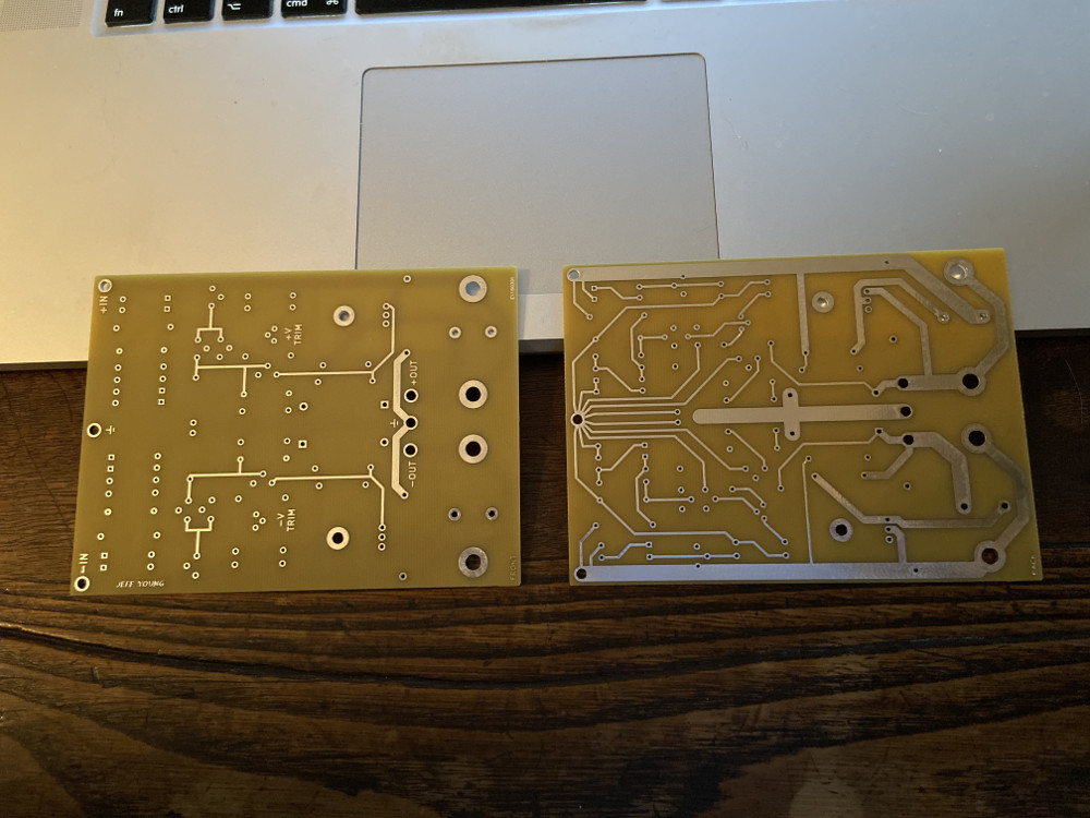

Boards have arrived.
Cost per board comes out to €13.40 (€53.60 per stereo amplifier).
Shipping is €5.70 untracked, or €12.70 tracked.
PayPal to jeff (at) rokeby (dot) ie.
Please indicate which postage you want. Please also include your shipping address.
Jeff.

I did talk to Les about the heat spreaders. He's moved to a CNC machining company who have a 100 piece minimum quantity in order to program the machines. He said they might do a smaller order, but at greater cost (and even the normal cost is more than the cost per board). So probably not cost-effective.
Feck. (That's Irish for... well, you know what it's for.)
The hole spacing is wrong for the TO-3 devices. Not wrong enough so that you couldn't drill them out a bit or bend the leads into them... but wrong enough that I'm not happy with my name on the boards.
So I need to re-run the boards.
I thought about selling the rejects at a reduced price for those interested, but since that would then reduce the quantities for the re-run it doesn't materially help the costings. Worse, I'd still know my name was floating around out there on some dodgy boards, so that's probably a non-starter.
I could also mark them "reject" with a Sharpie and include them as "freebies" when I ship out the new ones. It's possible that would bump the weight over the 500g limit for "large letter", though, and I suspect most of the folks on this GB are beyond needing to practice their soldering. So that one is of dubious value as well.
Or I could just bin them. That's probably the best solution as the cost is already sunk, but it's hard to throw brand new stuff in the bin. 🙁
Jeff.
PS: this might mean I also need to redraw the holes on the heat spreader drawing. I haven't checked it yet....
One last thing: I want to double-check nearly ever detail on the board now, so it won't be till next week that I send them back out for production.
Jeff.

Well Jeff, at least you found the error before sending them out, sorry for you as the cost will sink a hole in your budget, but I agree with your thoughts in the post, I am happy to wait on the revised, corrected pcb's - take your time and make sure they are all double checked I suppose.
I will go through the updated documents and print out.
My payment has been sent, thanks.
Gary..
