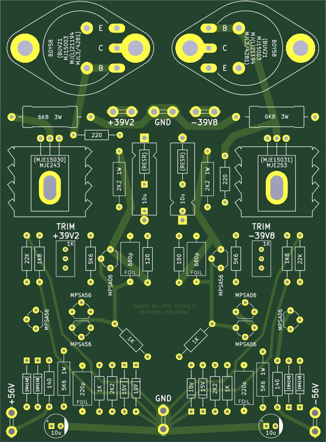

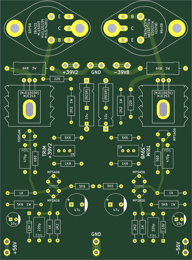

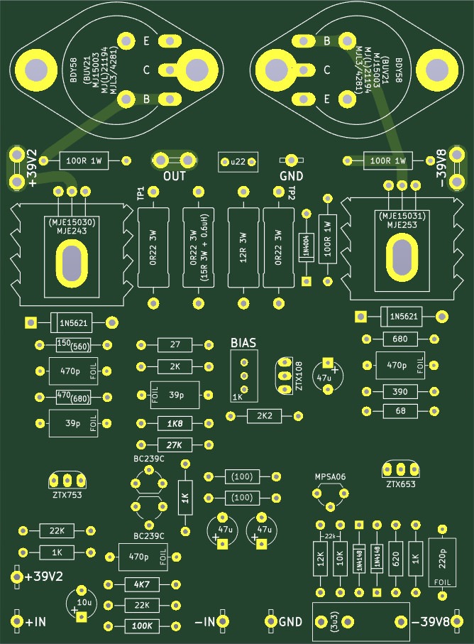

NAP250 amp boards & regulator boards
Attached pictures of my actual files, still some boards available...
