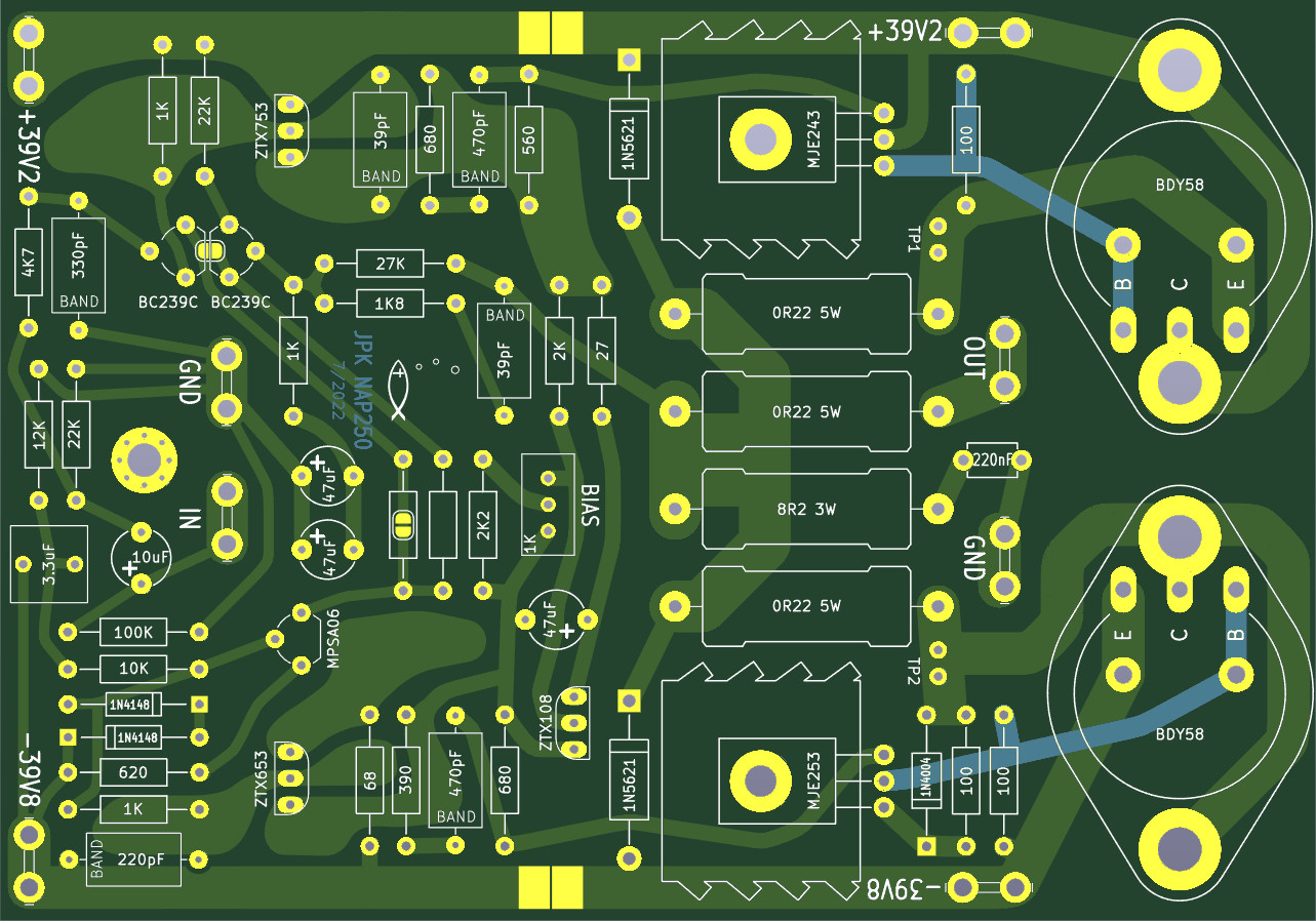

I updated my version of the PCB with a combined footprint for TO3 and plastic transistors:

In total, for testing in the clone NAP250/2 there will be the following transistors:
1. MJ802 Motorola
2. KD503 Tesla
3. BDY58 Comset
There is a BUX20 transistor in the Comset catalog, but Halfin does not have it.
I've asked Comset about production plans for the BUX20, but haven't received a response yet.

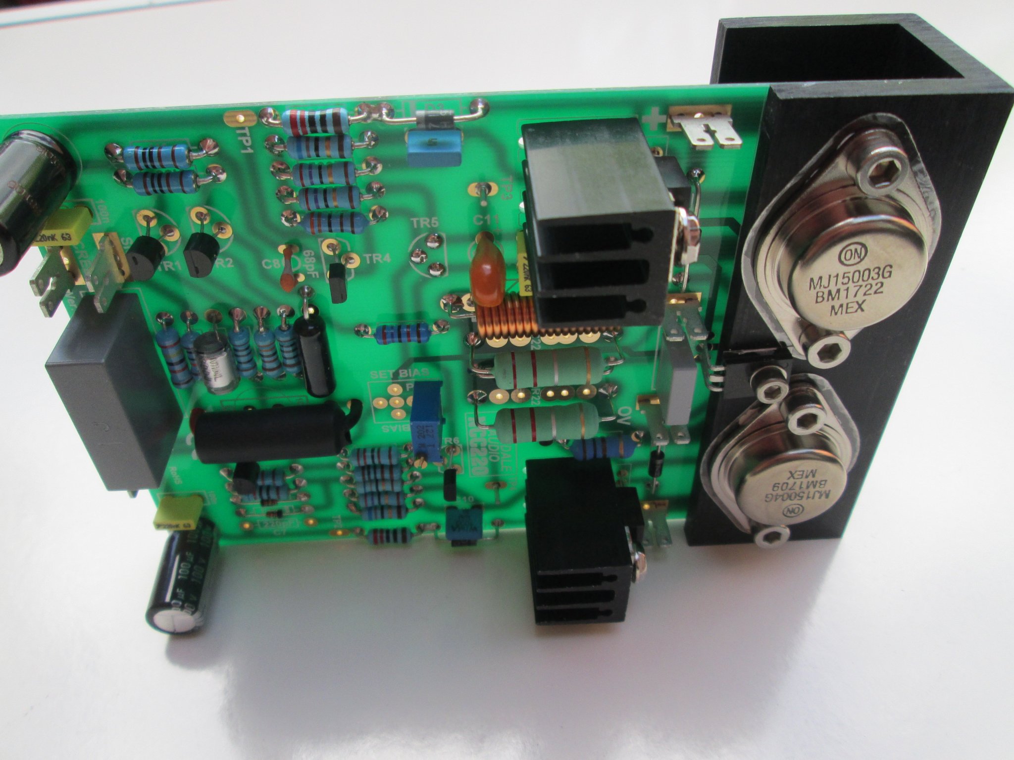

Hello, I would like to ask where the aluminum U-profiles shown in the picture can be purchased.
Basically, the sizes are 31.75mm/31.75mm/31.75mm/4.76mm.If it cannot be bought in these dimensions, then at least indicate a manufacturer with close to these dimensions. I mean the profile for the power transistors. Thanks in advance.
