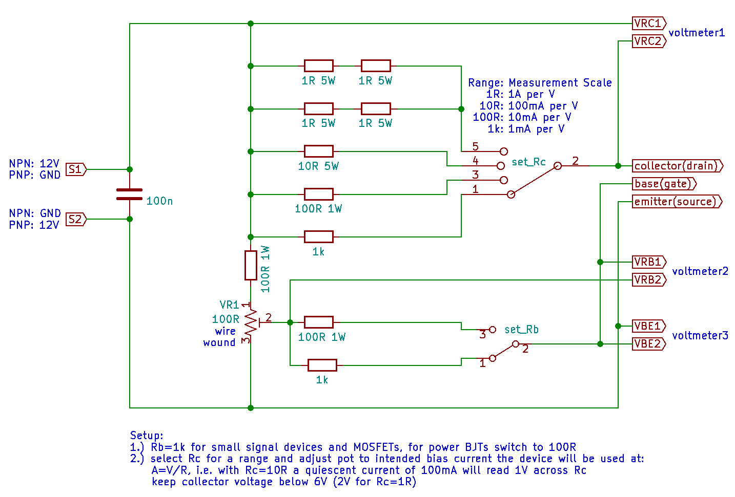

I finally managed to get hands on some 40 genuine but vintage power transistors from a trusted source. They have the much thicker base plate, and some of them have solder remainings on their legs. So I need to test them. I looked around the forum and found this post. As far as I understood testing / matching can be done by simply putting resistors around the transistor and feeding current to it, then mesauring Vbe (voltage between base and emitter) and voltage across the resistors and calculate gain like this: hFE=(VRc/Rc)*(Rb/VRb). I copied the circuit from this article and intend to build a simple power transistor tester:
attachment.php
Of course I would use a good regulated power supply and fix the transistors during test with some kind of clamp to a heatsink. Please let me know if I am on the right track!

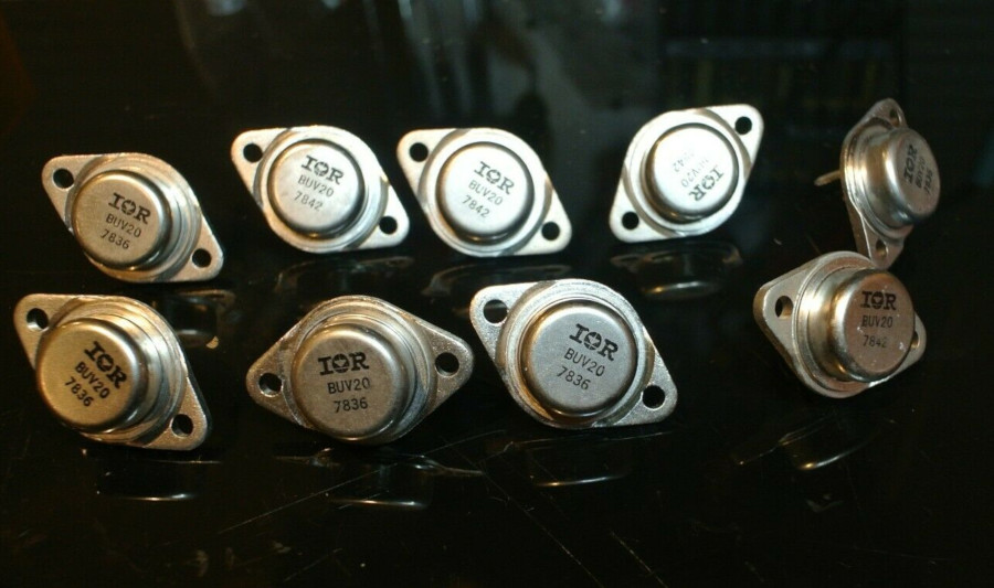

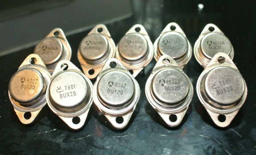

I bought from different sources, but one guy on Ebay sold BUX20/BUV20 from old stock, some of them were pulled, I need to test them - sorry I bought all of them (see attached pictures). Another set of BUX20s I got from here, they look exactly like the ones offered here on Ebay and came with the same paperwork and matched drivers. The set I posted photos of earlier I ordered from here, but I doubt they are genuine. BUV21 are in stock at Mouser!

I possibly do not have any suitable TO3 transistors for the "Young" boards yet. The BUV20 I have bought from ebay are very possibly fakes (they look like yours, jpk73). I do actually have MJ15003 from Onsemi, but they seem to be rather slow compared to the later Naim transistors (as far as JV has told us...). If I do not find any better I will try to implement these first.

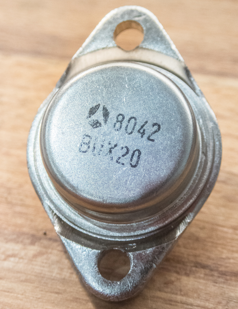

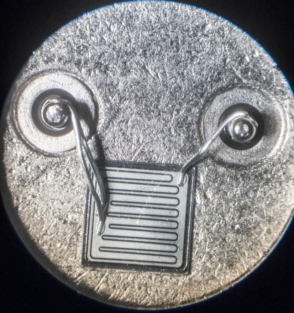

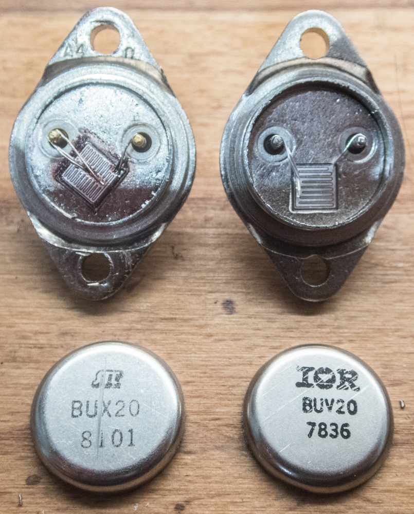

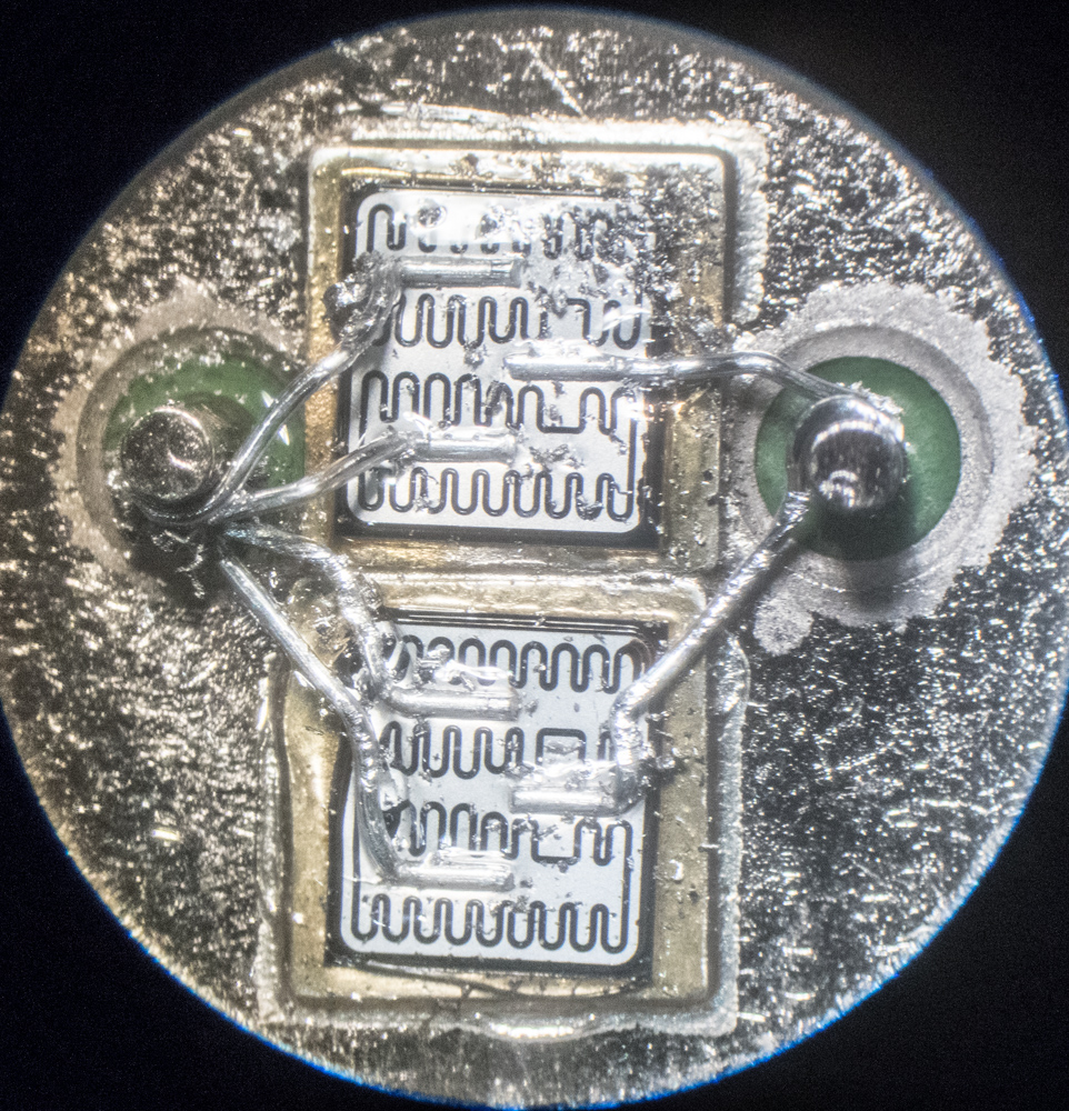

I tested my TO3s with the test circuit mentioned in #262 for HFE and VBE, indeed I got very different readings. So different that I decided to open again some of them:
attachment.php
And surprise surprise, these are single die devices! BUV20:
attachment.php
BUX20:
attachment.php

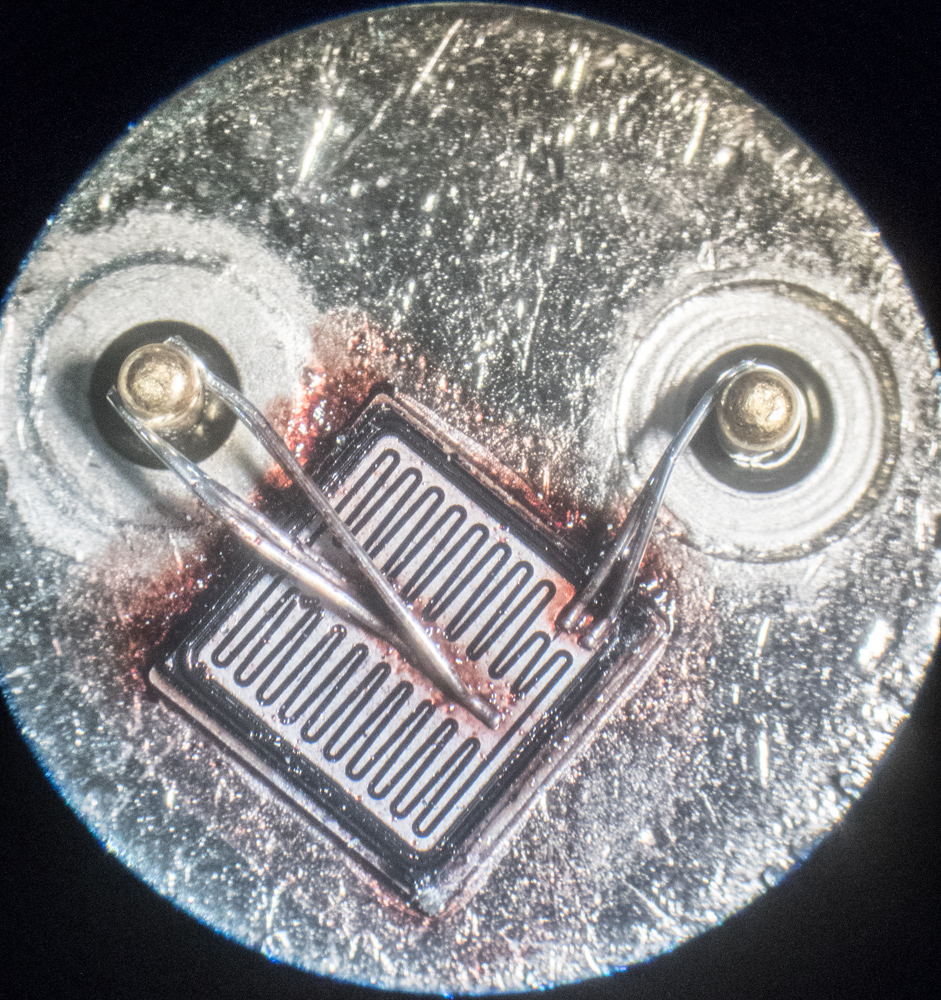

And a double die BUX20:
attachment.php
The dies of this last one are covered with some soft and transparent stuff the saw chips stick to...
attachment.php

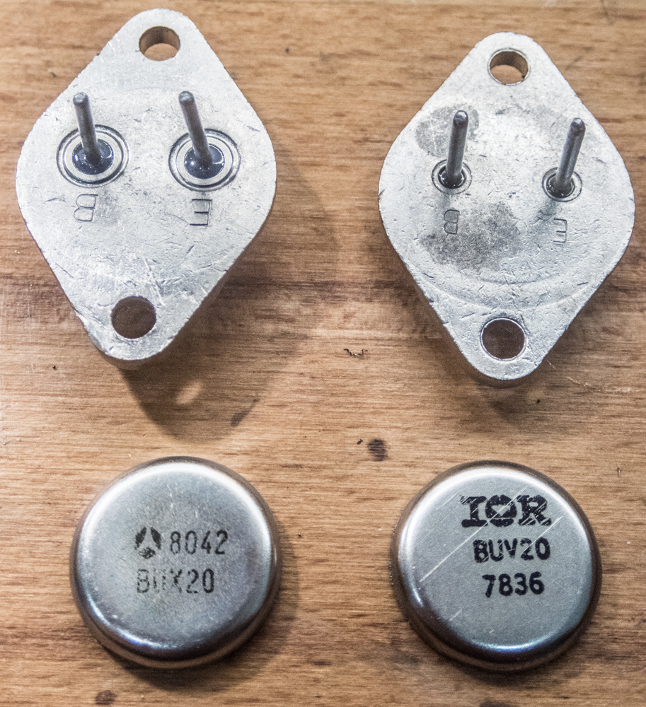

These look genuine to me, what do you think? Here is the underside with the "E" and "B" markings:
attachment.php
I run my tests with a collector current of 1.7A, HFE for double die devices was around 50. The single die devices developed more heat and gave a HFE between 150 and 220. The question is: which kind should I use first?
