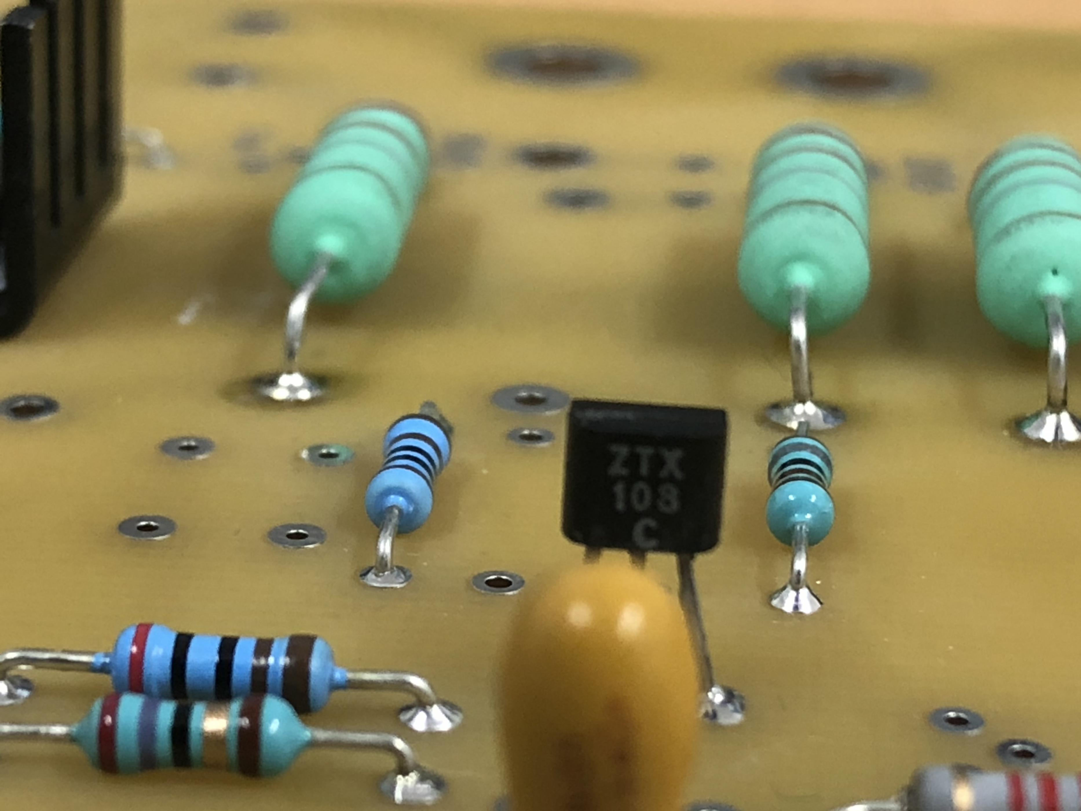

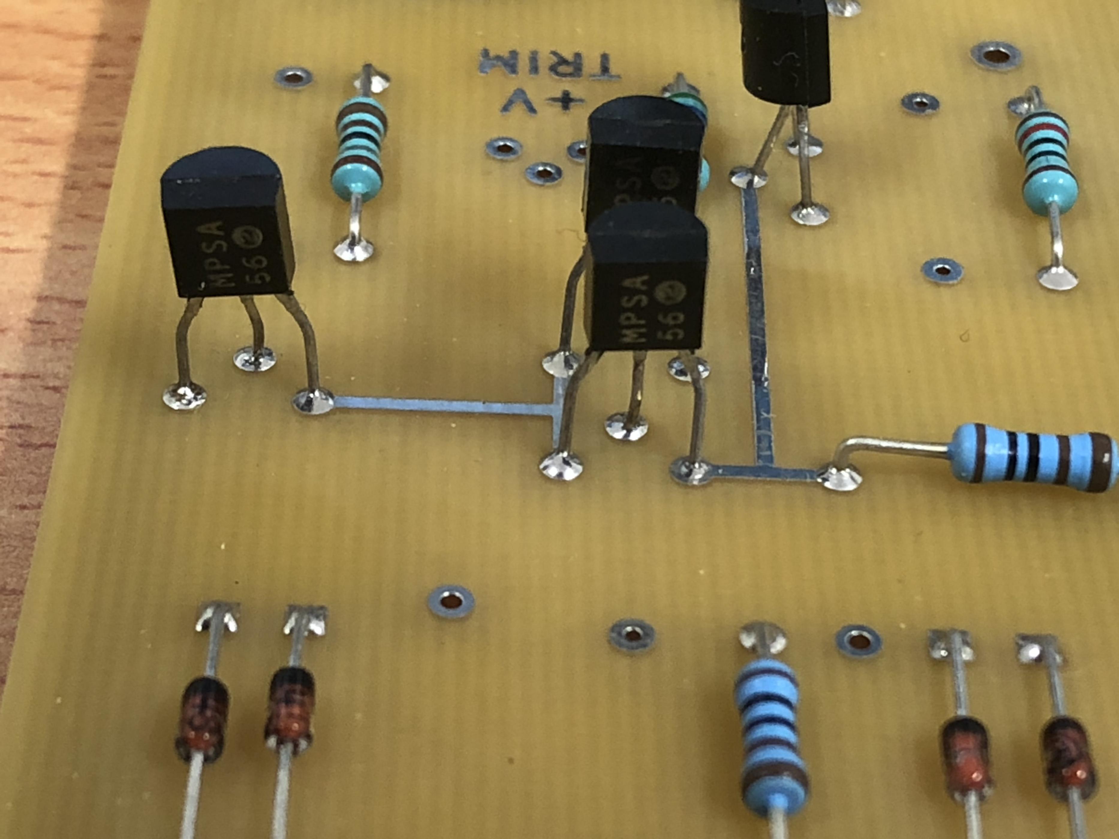

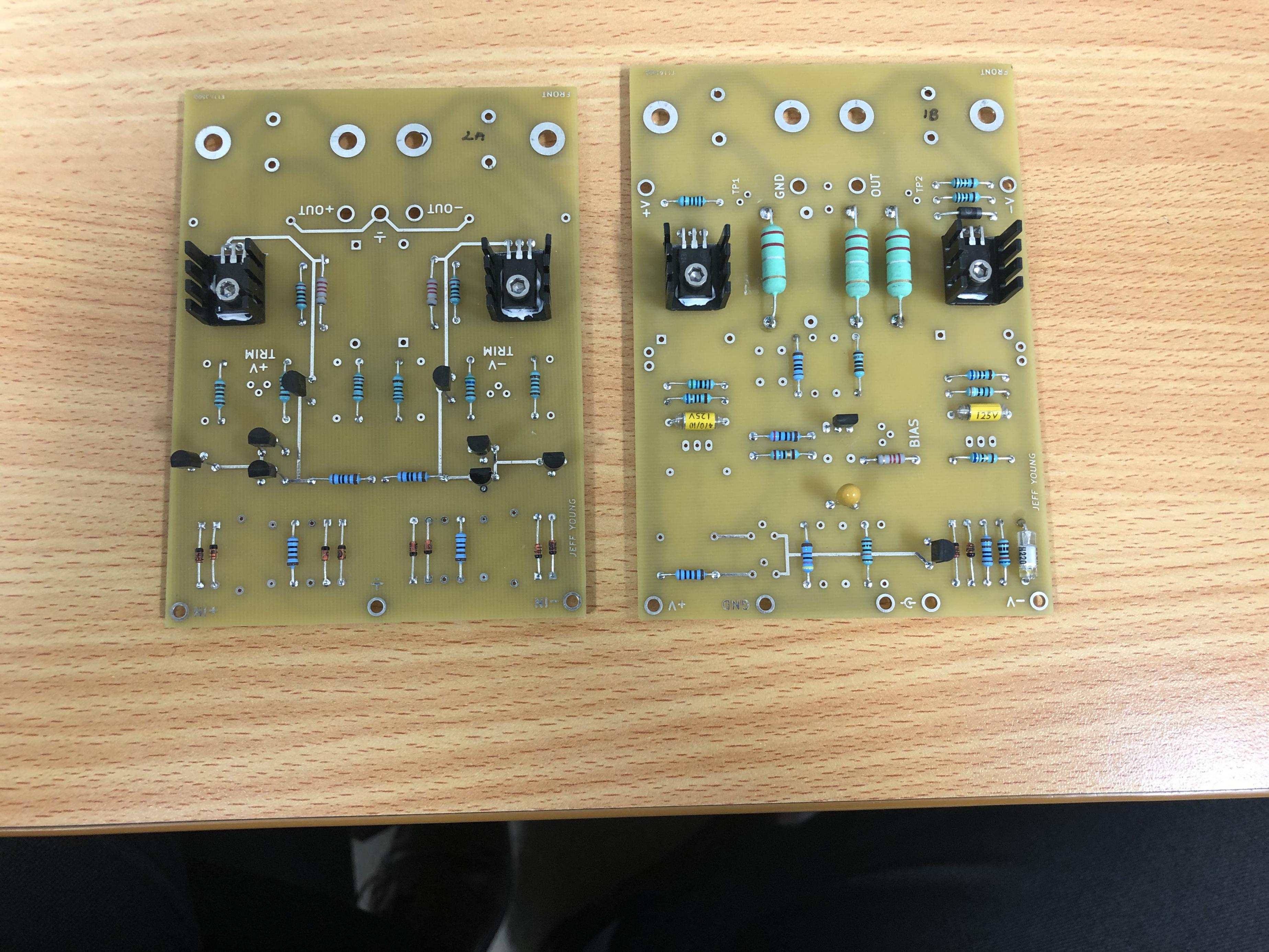

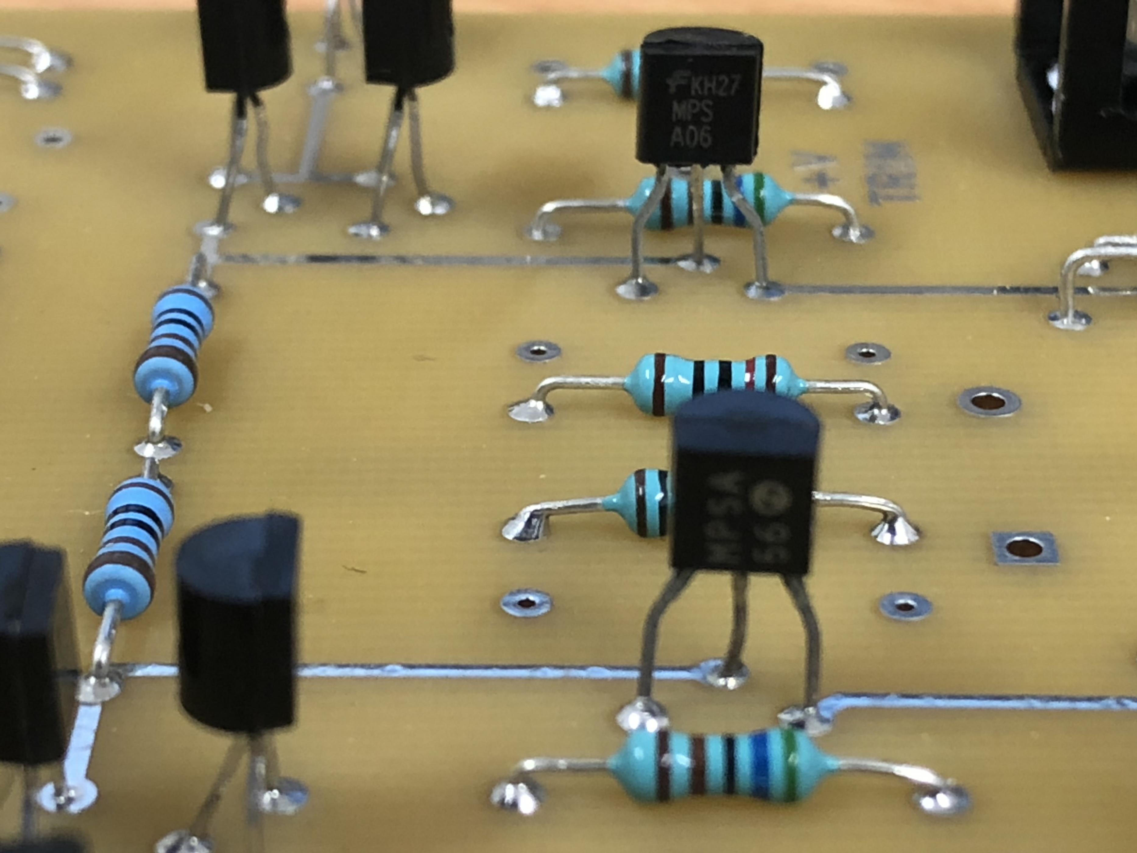

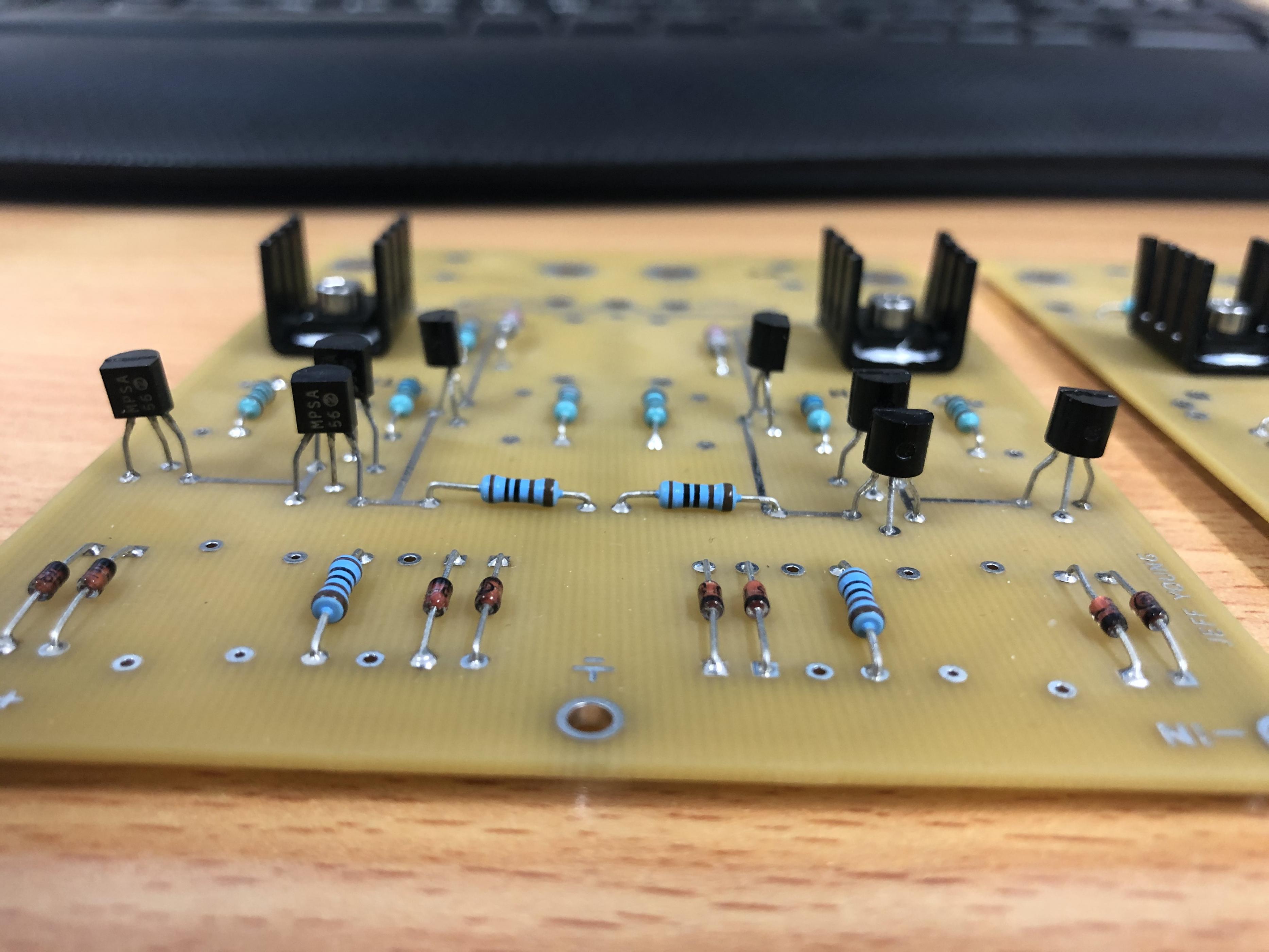

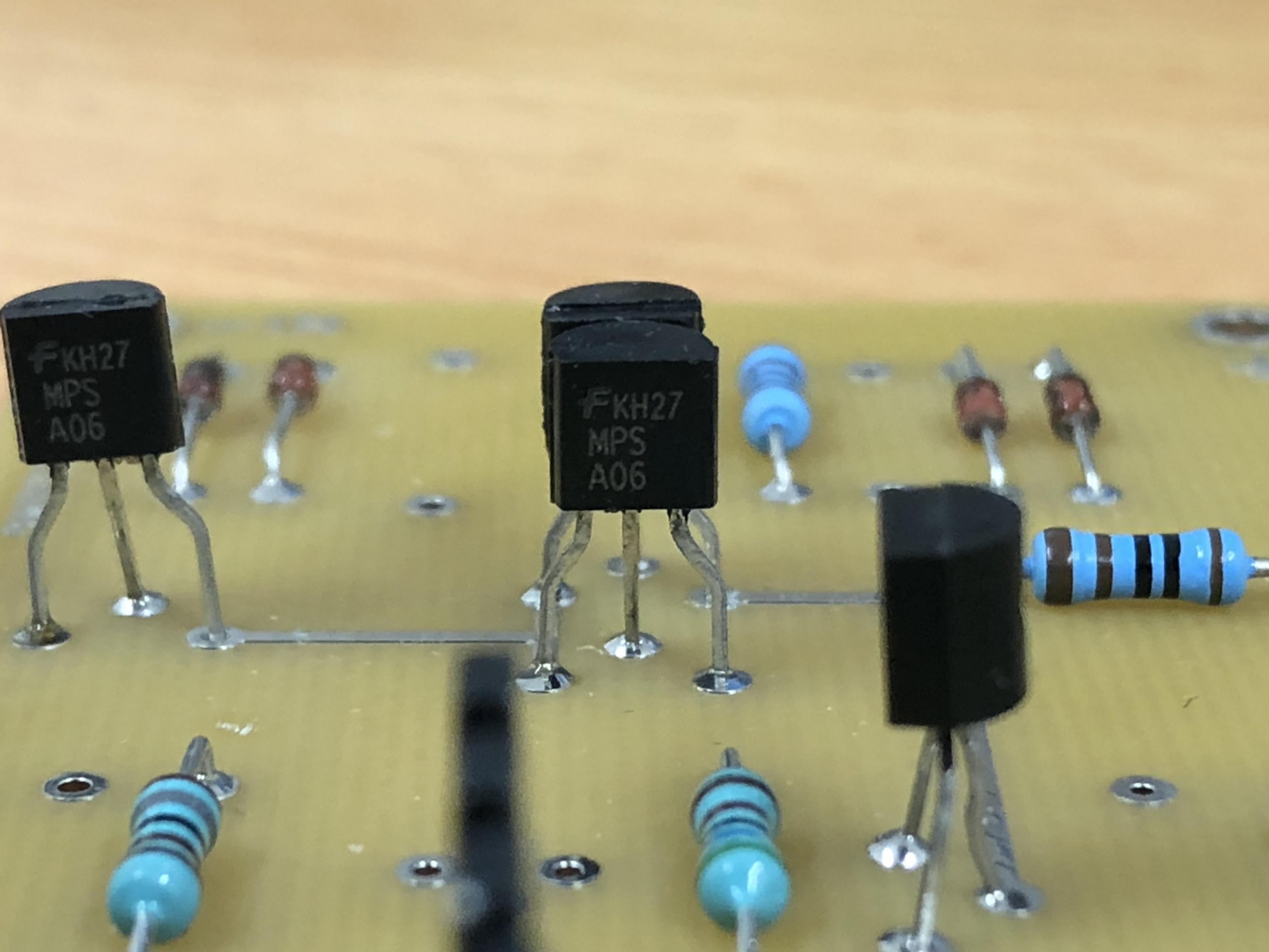

I have started to populate the boards with parts I already had. I am posting some pictures mainly due to anxiety about transistor and diode orientation as I am a novice. Please comment if you spot a problem.
Sajjad
Sajjad
Hi Sajjad,
Looks good to me. Only comment I would have is to hold the transistor legs at their wide spot with some very small needle-nose pliers when you bend them so that you don't put any stress on them where they join the casing. (I use Xuron 450-TweezerNose pliers for this -- and many other things.)
Jeff.
[Edit: to double-check the diode orientations against the stuffing guide, the banded end always goes towards the square pad.]
