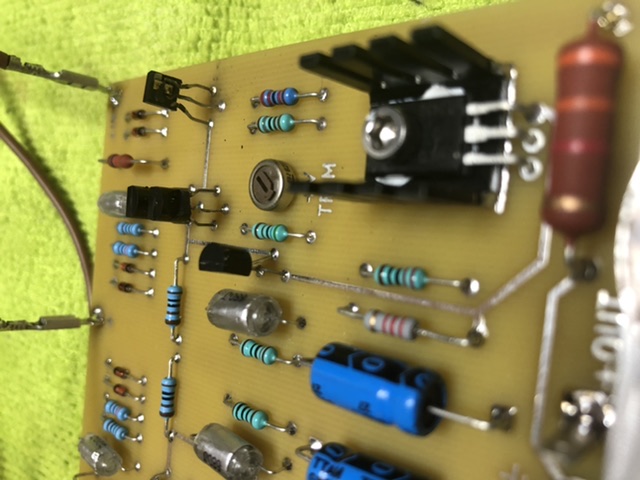

I used 39pf radial PS from an old tube amp and cheap connectors from my drawer. If everything works I may change to the ones suggested by Jeff.

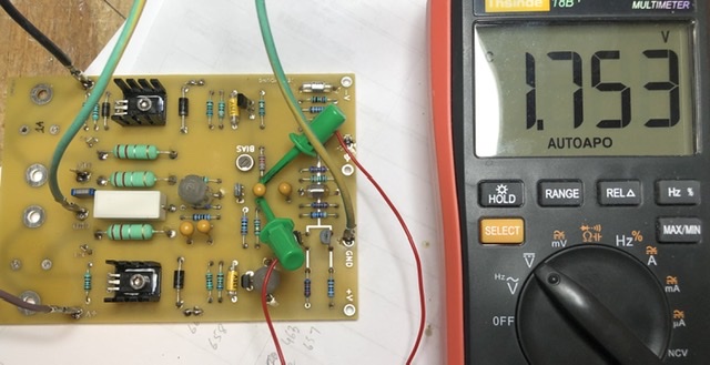

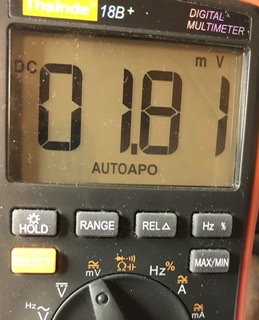

First power up test without op transistors has been successful 🙂
Bias at minimum adjustment is acceptable (I hope) 😕

Hi Sajjad,
For that bias test you want to be measuring the voltage spread across the VBE spreader. What you're measuring between TP1 and TP2 is the voltage drop across the emitter resistors, which won't be meaningful without the output transistors in place.
(Note also that your meter is reading mV, not V.)
To do the other test connect your leads across the capacitor in front of the VBE spreader (TR5).
Are those 39p the rocket-shaped ones from TheStylusLady? I have some of those too. 🙂

OMG! Little knowledge is always dangerous!
Thank you Jeff, I’ve corrected the leads as you suggested. Now on 47uf capacitor legs, I can still adjust the voltage.
You are spot on, these were bought from stylus lady, I had to make a u shape jumper to mount them.

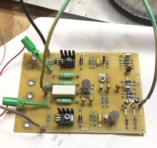

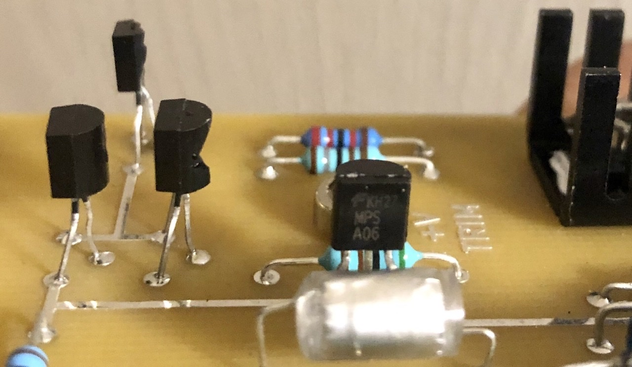

Huston, we have a problem.
After mounting the op transistors and checking for short circuit I powered on and mpsa56 have blown up on DBT.
Please guide me!!
Sajjad
Please guide me!!
Sajjad

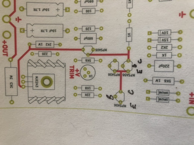

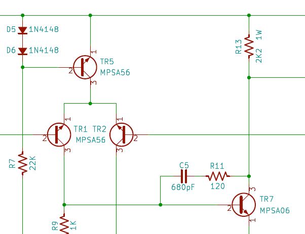

Hi Jeff,
Do you have a later version of the Inverted Schematic?
The one I have has NPN symbols for MPSA56 so I just wanted to make sure I'm getting the orientations correct.
Cheers!
do you know if stuffing guide is replicating this error?
As per stuffing guide we are connecting 2 Emitters to one collector. Electronically
Should this be the right way or 2 collectors need to be connected to one Emitter?
Sajjad
The collector of the CCS transistor should be tied to the emitters of the LTP transistors. So it looks like the boards (and the stuffing guide) are correct; just not the schematics.

DBT- dum bulb tester - it glows then dims and then bang
TR2, TR5 and TR7 blow each time
I’ve used a variac and negative side regulates power supply but just the positive side keeps blowing.
Thanks for confirming the boards are fine.
Sajjad
EDIT- I am using 2 x 40V ac Toroidal Transformer, 500VA with 2 bridge rectifiers and 2x33000 uf 63v capaciors final output is DC56v
You've got an A06 in TR7, not an A56, right?
yes that is correct.
Crap. There's another error: there's supposed to be a 140ohm resistor between the rail and the emitter of the CCS transistor.
Try that and see if it works....
Yeah, I ran the simulation without that resistor and it feeds several watts into the MPSAs (which is never going to work).
Thank you Jeff for helping me. Can you please tell me exactly which two points need 140 ohm resistor?
Sajjad
Here's a new copy of the schematic. Note the new R23 and R24 (which you can see in the LTSpice picture I posted earlier, but which somehow didn't make it into the Kicad version).
What you want to do is not insert the outside leg of the CCS transistors (TR5 and TR6), and instead put a 140 ohm resistor in the PCB hole and the other end of the resistor soldered to the leg of the transistor.
