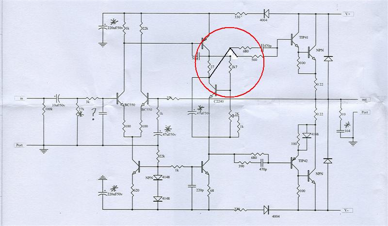

Polarity of DC blocking input capacitor
Further to an earlier post, does everyone agree that the input blocking cap (C1) and the NFB DC blocking cap (C5) are shown reverse biased?
It seems to me, that to get any bias current into Q1, a current must flow from ground via R2 & R3. This will make the voltage at the junction of R2 & R3 negative with respect to ground. That being so, the voltage across C1 when there is no signal will be the same negative voltage with respect to the input pin i.e. the cap is shown negatively biased.
With Q2, the bias current must come from the speaker output - which we hope is at 0V. Therefeore the voltage at the base of Q2 will be negative with respect to ground. Therefore, c5 is also shown negatively biased.
Can somebody confirm (or deny) my logic before I build my new amps?

Re: Polarity of DC blocking input capacitor
hi cdswift,
I had noticed the feedback cap was opposite to what I expected. There are 3 different "NAP" schematics with the cap this way and I found one that had it the "correct" way. From what I understand, there is only a very small voltage across it, so it isn't a big problem until a fault occurs.
I also reckon the 27R resistor in the Vbias circuit is in the wrong position if Douglas Self is to be believed. What do you think?

Re: Re: Polarity of DC blocking input capacitor
You're right!
Correct wiring attached.
You're right!
Thanks for the response - this concurs with my view.
I am not sure what Douglas Self has to say about the position of bias resistor 27R.
However, it looks OK to me as it limits the collector current of Q5 and provides some element of negative feedback to keep the voltage across this bit of the circuit stable.
