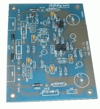

Each channel will have something around 160 watts of consumption when driving full power over 4 ohms.... so.... your transformer, 2A and 28 plus 28 will give a little bit more than 110 watts....not enougth, even to a single channel into 4 ohms...but will operate fine into a single channel when using 8 ohms speakers.
If you have two of those transformers, and accept to use only 8 ohms, using good electrolitic condensers into the supply, you will be happy with them.

I like the kit, in special the boards colour... i love this blue

This kit is lovely.

I have just completed these boards and boy was I careful to not mix anything up or do any bad joints, not drink too much while squinting at the bands with my out of prescription specs.
one very unusual feature, and almost certainly my error - when connected to my bench supply at 31v per side and rigged to test speaker, the current limiter clicks away and treats the circuit as a short. Now, get this, if I unsolder the speaker terminal and switch on everything fine with bias just nice and then connect the speaker, fine, sounds good. For some reason one of the output trannies is not team playing and this quasi thing seems like a fine way to send some juice through your speaker coils. Beware!

It looks that your PSU does not like the steep current increase when connecting the amp with speaker load attached. One way to prevent this is to use a PSU without current limiter, or to modify the threshold of your PSU's current limiter.
However, since this current peak is ran through the speaker load during startup, it is advised to use a speaker protection for this reason (many speakers do not fancy DC current, even if it is during a short startup period. Low power full range speakers might die within a few milliseconds when exposed to DC 🙁 ). In one of the links posted in this thread, describing the building process of this kit with lots of pictures, you can see a speaker protection circuit connected to the output of the amplifier boards.

You were quite correct, the surge at turn-on is quite high and then settles down. They sound good on the bench speakers. I will get them put in the box I have ready and waiting that did house my jlh 75w that did not like my electrostatics at all and got very hot, very quickly.
