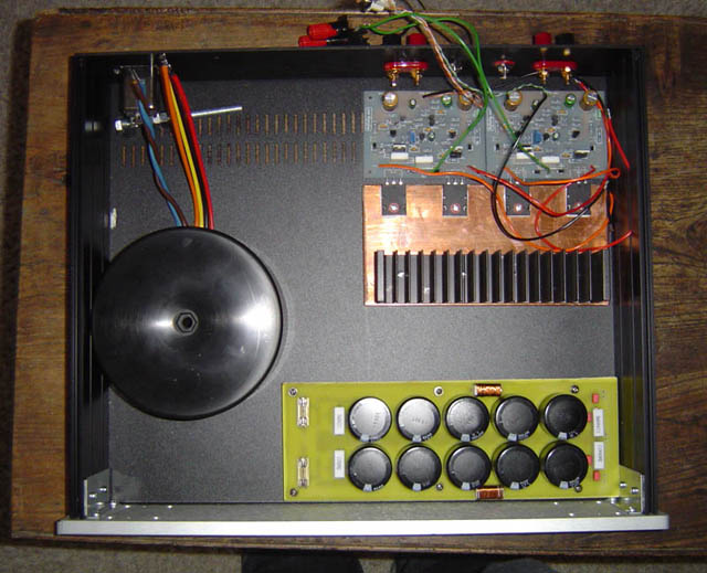

Very well, my chassis arrived from hifi2000 and i have and started thinking about mounting it all. Also waiting for my caps to arrive from ebay for my Cap 10. Still umm and arring about whether to use ultra fast but soft diodes or standard decent metal packaged bridges.

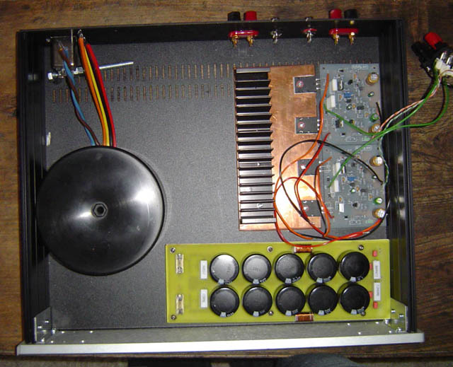

Layout A has the advantage of short interconnect leads while B has the heatsink between the Amp boards and the tranny.
Any advice ?
Oh yeah and before nayone asks the yes my diodes arent on board yet. 16Amp Hexfreds in the post though so hopefully it will be ok
Any advice ?

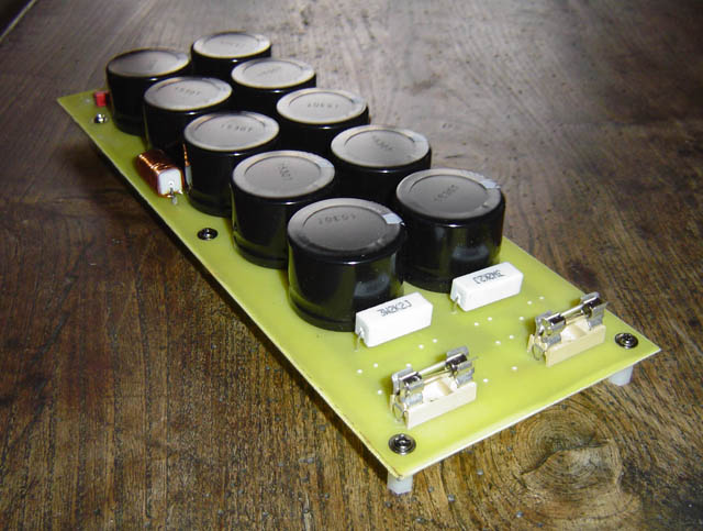

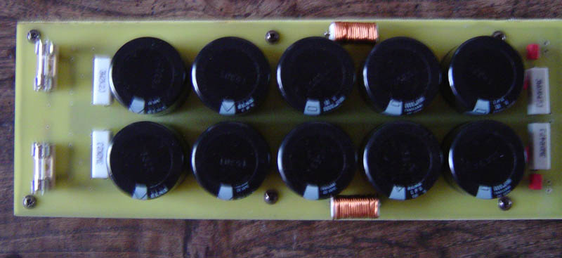

PSU is 5 x 6800 uf (Elna LP5) per rail, using dual fullwave recifiers made from Hexfred diodes.
Near the end of the cap bank there are small inductors handwound around 3r3 resistors, at the end are 100nf wimas, then a snubber made from a 0r47 resistors and 1n5 caps.
All could be remove to just leave a standard setup but i though i would start with these in place and try removing each part to see how it effects the sound.
Phil
Phil

Gives a pic of the underside of the PSU. Only thing you might change is to make it dual mono - but you could do that if you think its heading where you like it.

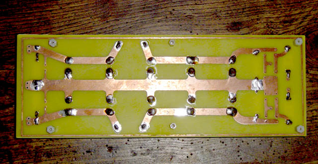

Here the board layout and thanks for the support.

Any suggestions on layout as well, recon shorter leads would be better than the heatsink as a barrier?

Its going to be a top notch amp on budget, psu looks good, did you calculate the inductor off the web calculator?
Whats the gauge of the enamelled wire?
Nice job on the DIY board, wish I could do that.

I'd go with whats easier to wire, I believe its the vertical direction you worry about most with Toroidals (ie the next component above seperated by a few inches), though could be correct.
As long as theres some space I'd go with easy to build any time, shortest returns from speaker to caps. Ie put the toroid at the front if you can so the speaker returns get back to the cap with least resistance.
To be honest its a bit of a pick n mix PSU nicking all the stuff i have used and or heard about.
The snubber network seems to be a pretty standard setup used on a lot of DIYaudio boards since CarlosFM came up with it for the LM3886 based gainclones. Seem it used on several other setups.
The inductor setup is based on the DXamp which i have been keeping an eye on. Its also uses the same snubber network values. The board is very heavily built so i can unsolder stuff at will and short them out to see if that changes things for the better.
My pcb layout skills aint bad but the psu is in truth a bastard child of many things. Mainly cos i cant work out that Duncan amp PSU simulator for toffee, i studied at art college instead of continuing electronics unfortunately.
We will see.
You should try something like Eagle PCB software though, i built my first pcb in about a day using it.
