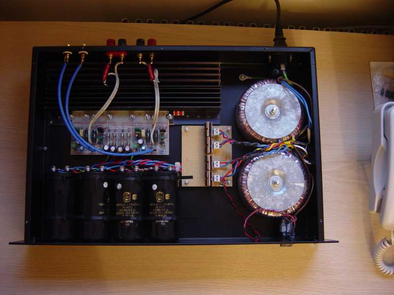

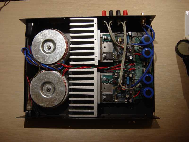

Ok i have built my psu. Its a 500 va 0-25 x2 unit running into a seperate bridge rectifier per channel. the + on one tied to the negative of the other.I have 22,000 uf between each rail and 0v. My issue is that i get about 26 v rail to neg without caps and 36v (what i was expecting) with caps. Is this right, i am guessing it is cos obviously i should get 25v x 1.41.
Almost ready to fire em up!!

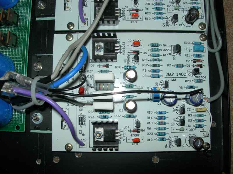

Right i have attached my boards to the psu and am trying to measure the bias. But the meter gives a zero reading. Even stranger the voltage across the two meter leads read by another meter is 50ish volts. What am i doing wrong?
Any ideas very gratefully recieved

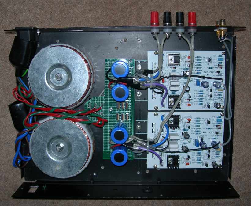

Well i am 99% sure my psu is cool, i have got twin secondary windings going into 2 bridge rectifers. The plus of one is tied to the minus of the other as per :-
http://www.tnt-audio.com/clinica/ssps2_e.html
I have got a 22,000 uf between each rail. This gives me a +37v and a -37v in comparison to the tied togther zero rail.
All this is working fine.
My issue is i have never measure current apart from using a clamp meter at work. From what i have read i have to put the meter effectively like a fuse in the +37v rail. It appears i blew the fuse in the metre on doing this i dont know why.
Any steps i should do or avoid whislt trying to measure the bias current?
Many thanks,
Fil
OK, it sounds like what you are doing is right, connecting all the amp up, remove the positive supply to the amp boards and then connect the meter in series.
A few gotchas here though!
1) have the meter on Amps
2) make sure the leads are plugged into the amp sockets on the meter and not voltage
3) nothing should be connected, no input or output form the amp
I have blown a fuse on one of those little yellow meters (200mA MAX) before (goes off nice and bright😀). If you are sure what you are doing is right there might be something wrong on the boards, ie a short of some sort, but if you are set to current on the meter and plugged in right it should be ok.
Get it plugged in and post up a photo or two of the meter and where the wires go before you turn on and we can look at it. Im being totally selfish 😉 I want a review.
Its a little too high, but not stupidly so, but it is something Les reported having issues with on his boards he tried.
You cant have let it run for very long, leave it on for 20 minutes with the meter in series, my amp drifted for a while, had to keep tweaking the bias.
