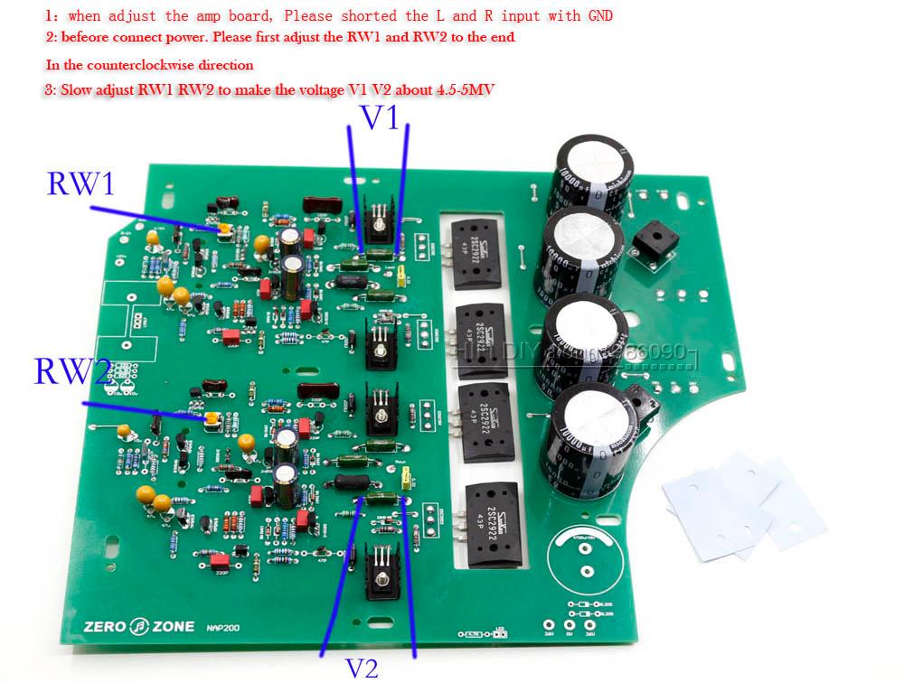

....to adjust the offset, see picture.....
That is good and the procedure is correct for bias current setting but the instruction neglects to say that it will only work properly when the amplifier is in a sealed case. Why? because there are no heatsinks used with this Naim design, right? The sensor transistor is also a long way from the output stage and the heat of the output stage has to get there predictably by some means. That means is the bottom of the case and the air trapped inside. Don't try to set bias without the amplifier being in a suitably thick aluminium case with a heat spreader bar for mounting the transistors or your output stage will overheat and the bias setting will never be stable or correct.

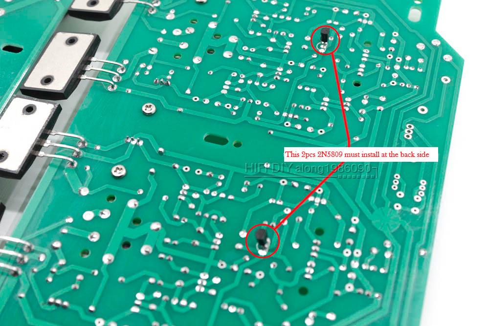

Is there an other way to placelebrate the sensor the probe is that it's located on the back of the pcb is now bent to the pcb what is the best way.

....Is there an other way to placelebrate the sensor the probe is that it's located on the back of the pcb...
You don't need to access the transistor leads directly because the 27R and 2k resistors and C3 connect to it also, which will be easy to probe from the top. Just look at the PVB tracks and trace the circuit in that area.

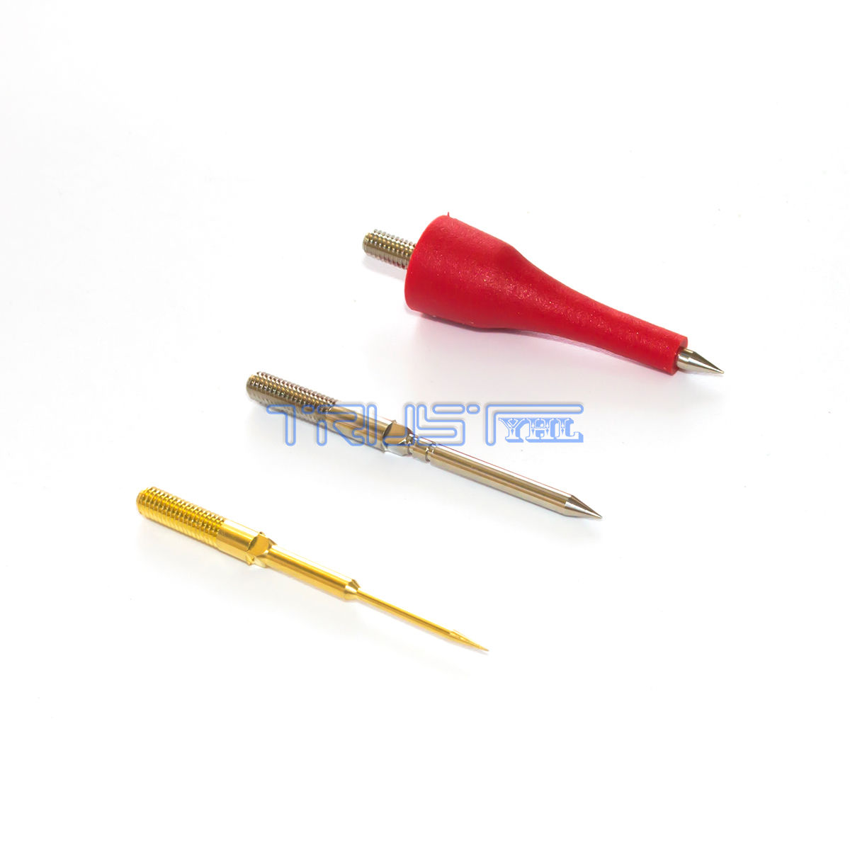

You may notice that new meter probes are sharp and don't slip on solder joints. This is often very helpful and a little sharpening of old probes on a fine stone or knife sharpener. is a good idea.
