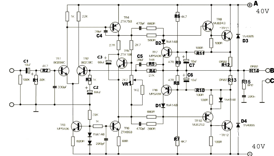

Naim amps do run relatively cool because they are a quasi-complementary design and operate with only about 30 mA bias current in the output stage.
The bias setting procedure has been detailed a few times in this thread. You probably don't have any schematic to refer to, so you need to identify the output transistors TR11 and 12 and the large "emitter" resistors, R11 and R12. Don't confuse them with the similar output resistor, R14. Measure the DC voltage across either R12 or R13. It will be very small and should be set to 7mV. If your meter is crap at lowest range measurements, measure across both resistors in series and adjust for twice the voltage at 14mV, which will be more precise.
Make any adjustments promptly after the amplifier has been closed and fully warmed up. If you are running the amplifier open, it will probably never warm up and stabilise, so don't try to set it without its case - you'll be wasting your time. Build your amp like the original, where the amplifier does eventually warm up warm after about 20 mins because the aluminium case is the heatsink.
I don't know whose clone you have there and what, if any, part numbering is used. The reference numbers I've used here follow the attached schematic. Yours may have nothing, so you may have to deduce the part identities from the circuit and layout, which will likely be similar to the original anyway.

I will try to probe the terminals later. Could it also be because I'm using a 300VA transformer instead of the original 430VA?
No, the 430 VA rating is more than sufficient for the task and even a 300VA transformer could be considered overkill. The over-sizing is not needed to maintain the tiny bias currents which are regulated by the circuit anyway. The over-size transformer is about better sound quality and is specific to the brand and construction qualities of the transformer originally used.
I should point out that the schematic is a general NAP schematic, suiting almost all NAP models since the 1970s. The transistors and other parts used will be different to the originals because those are obsolete. Only TR4 and TR6 are original.
