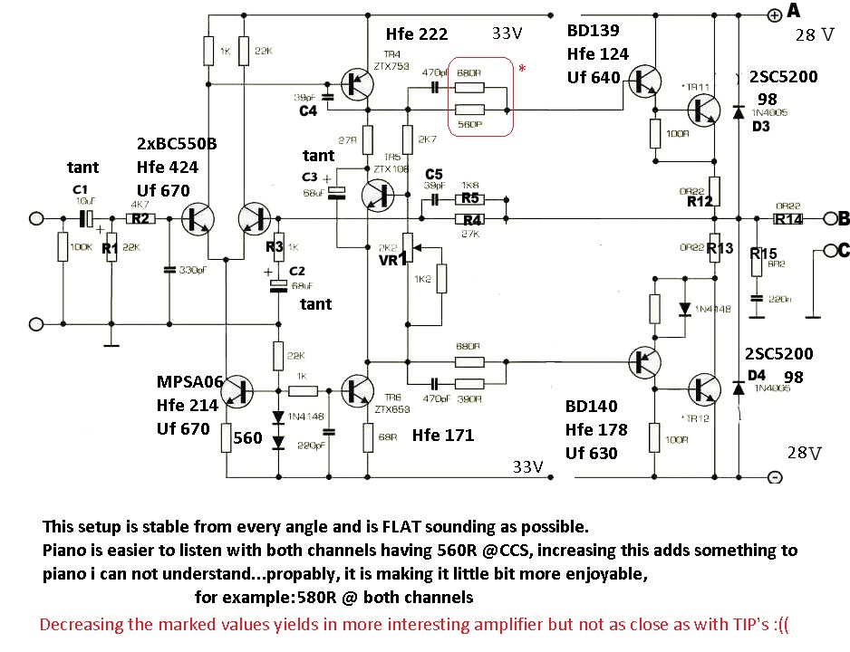

In overall, i Ended up:
1. Rewired the amplifier PSU and ground(still not twisting). Ian was right, that the Oscillation in Audio range was caused by wiring!!, but... i still had "silent" oscillations left with TIP41/42CG (high gain) drivers. I cured the bias oscillations by replacing the 1.8K feedback resistor with 1.2k, it is the resistor which is connected in series with 39pF capacitor in feedback network. It was stable even with Chinese Philips BC550C LTP transistors.
2. Removed stupid Inductor's from PSU DC path.
3. Sound is still way more pleasant with BD139/140 as drivers and BC550C as LTP.
4. The Driver base filter networks are adjusted. NB! every time i change drivers or input pair transistors... driver network filters need different resistor values to give best sound.
5. Removed soft-start/overheat control's and they'r PSU-s from the case.
I have reed here that someone was not sure about rhythm on naim clones... Probably it was DaveS . That happens when your grounding is wrong AND, OR input LTP are messed up.
For short: I have better dynamics compared to H-140 naim clones, same deep bass, alot better separation in high's AND it is Sooo rhythmic. ALLIN1, i prefer less powerful(500VA H-140 clone vs ~150VA Very close NAIM ??), but more interesting amplfier for now.

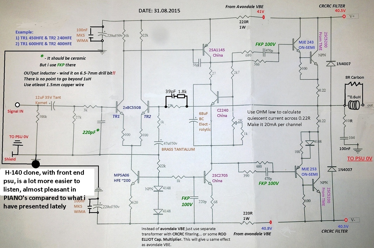

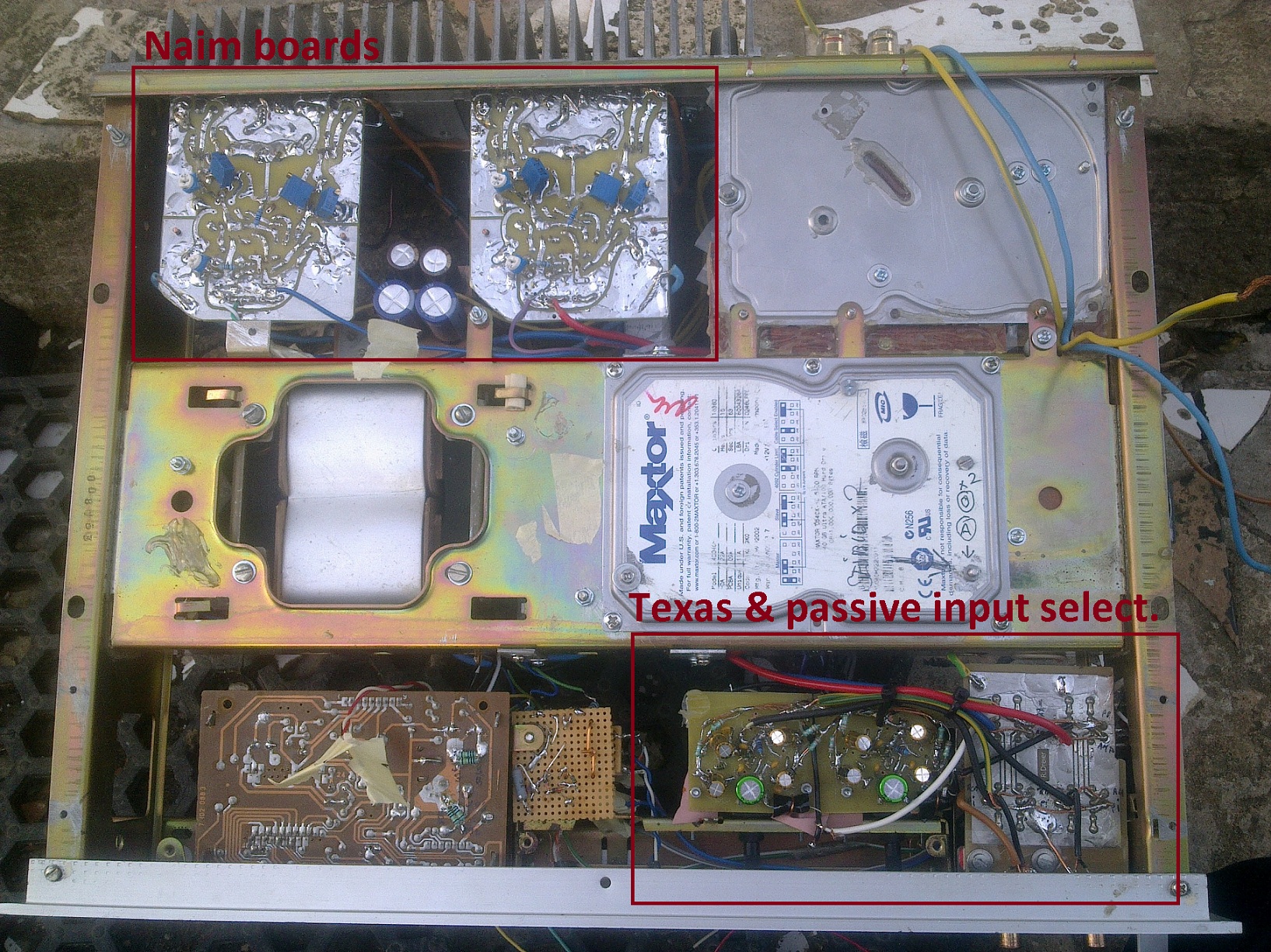

Hello,
I was able to make the amplifier quiet without inputs connected, by replacing overheat/control systems and they'r PSU with much simpler solution:
Capacitive reactance based PSU's straight from AC power line. If everything is done correctly, there will be minimal heat and noise.
So i continued the journey for better sound that, i have a feeling, will not be reached😀
This was experimented with (NAP 140/160/180)that is seen in pictures below.
Final results were never reached, cuz there are always some downsides.
At least Tidu34 pre-amp is doing good job, transparency at its best 😀
Few facts:
*I have not yet tried BC239C, but second candidate would be BC550 series, they are much more linear to my ears in naim LTP then any other transistor i have tried here.
Third candidate would be BC546B, they affect bass a little, some may like it. Also, drum instruments have more power with BC546B's inside.

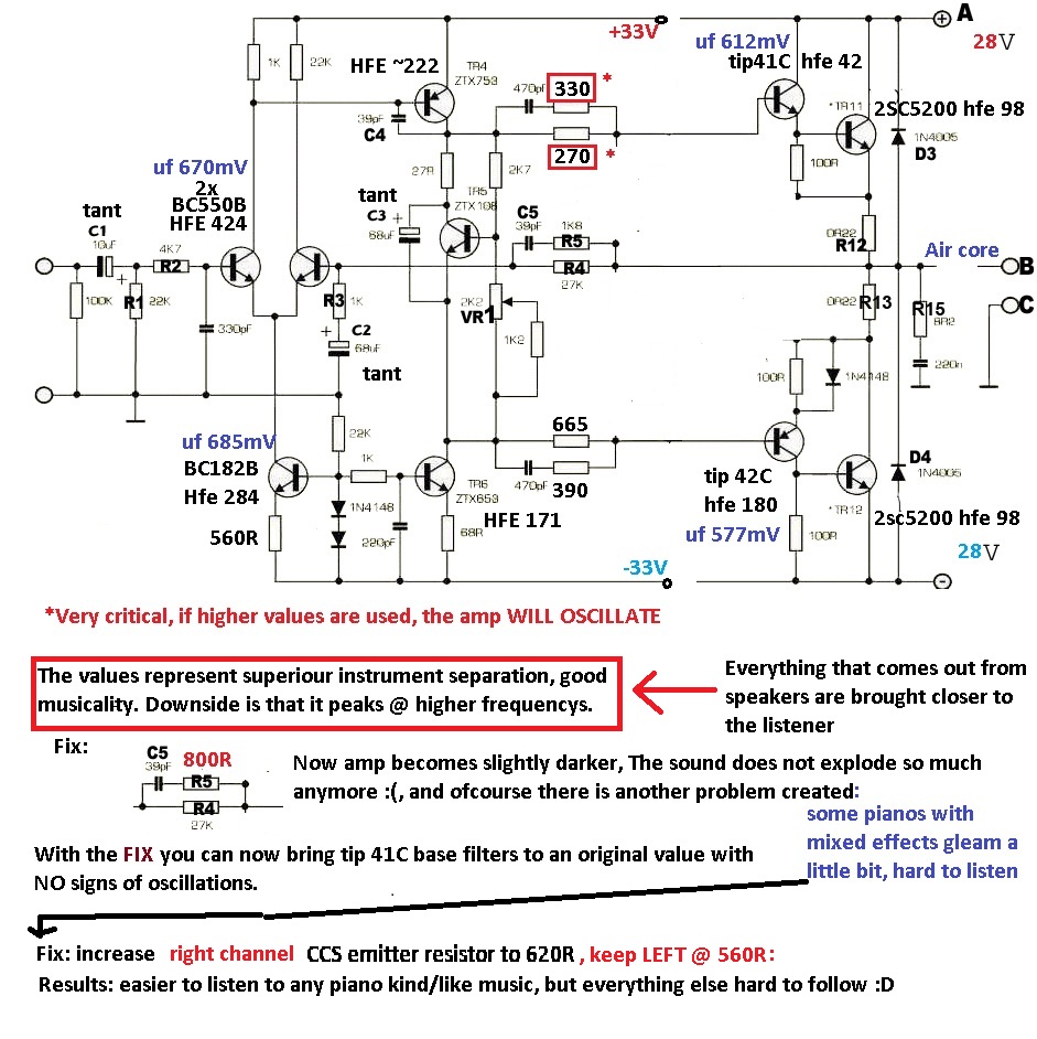

Tought's:
* I think, that LEFT and RIGHT channel NAP140 are fighting each other when used with 1 PSU,
I always had good results powering 1 channel only, from laboratory PSU(regulated).
*620R CCS emitter sounds worse @ 33V than 560R.
*In my experiments, using front end PSU on an amplifier that was not designed to use it in a first place will have negative effect on high volumes.
The effect is simple, one will get everything amplified as volume rises, even those frequency's(sounds) that should stay more or less attenuated. Simply put, it will suck the life out of the music.

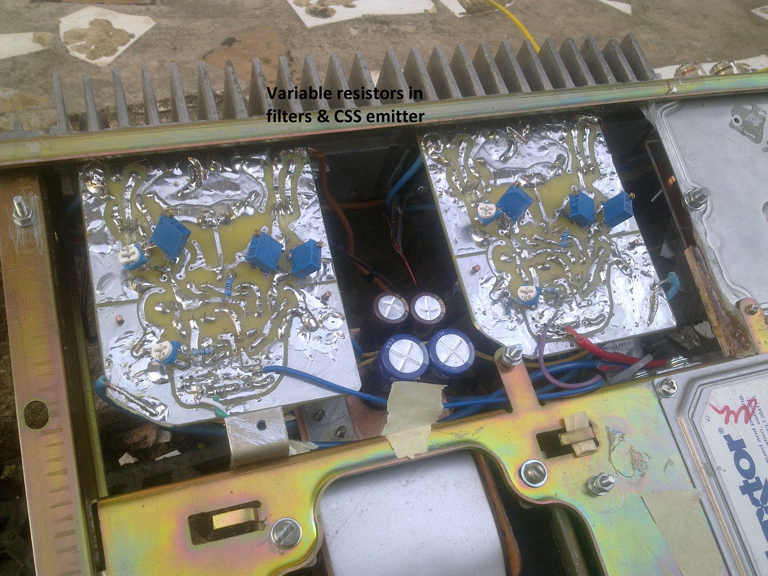

Few facts:
*Every output decoupling capacitor had negative effect for me, nothing positive for sure.
*10nF capacitor in parallel with rectifier diodes will affect high frequency perfomance in negative way. Removed, will be removed on my first amplifier too.
*Removing inductor from to the DC PSU and placing it back again after a week or so, i was not pleased by its effect. It was removed shortly after few hours of listening.
*New wireing vs old one do not sound different...
*Using Tantalum-Polymer SMT 50V 10uF capacitor on naim LTP input will have negative effect on the sound(becomes metallic).
*Trying different grounding techniques do not fix problems.
*H-140 clone shown in the last picture is better @ any kind of piano music.
*Original naim circuit is a killer, if configured correctly, it is very hard to make it enjoyable in every aspect with separate(OUTPUT, Front-END) PSU's.
*If one tries to compare amplifiers with low sensitivity and/or tiny or not properly made speakers, it could be very hard to hear any difference at all.
Is there a point to search for BC239C transistors ? Maybe someone here can suggest correct mods/adopt the circuit to the Front-end/Output separate psu ?

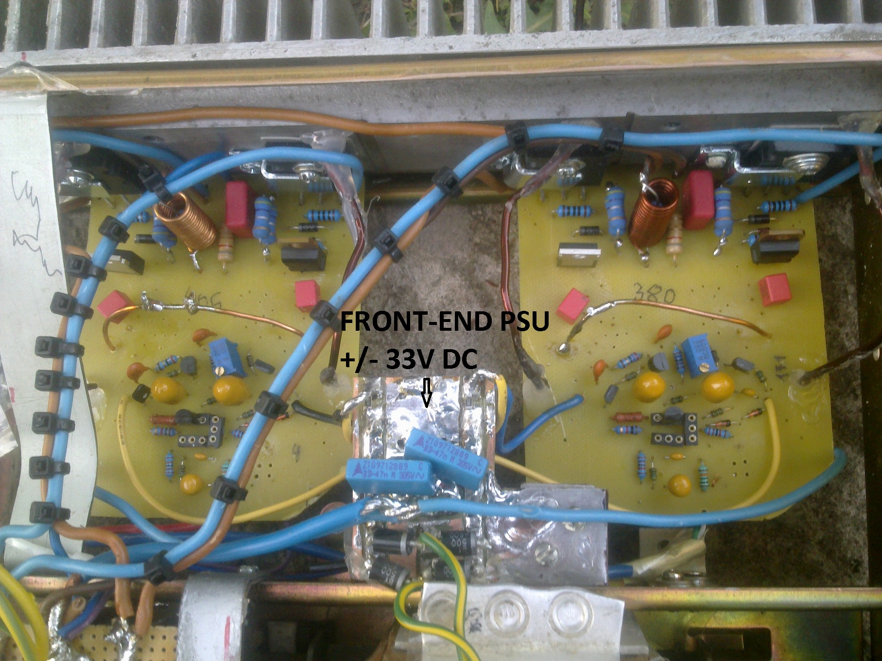

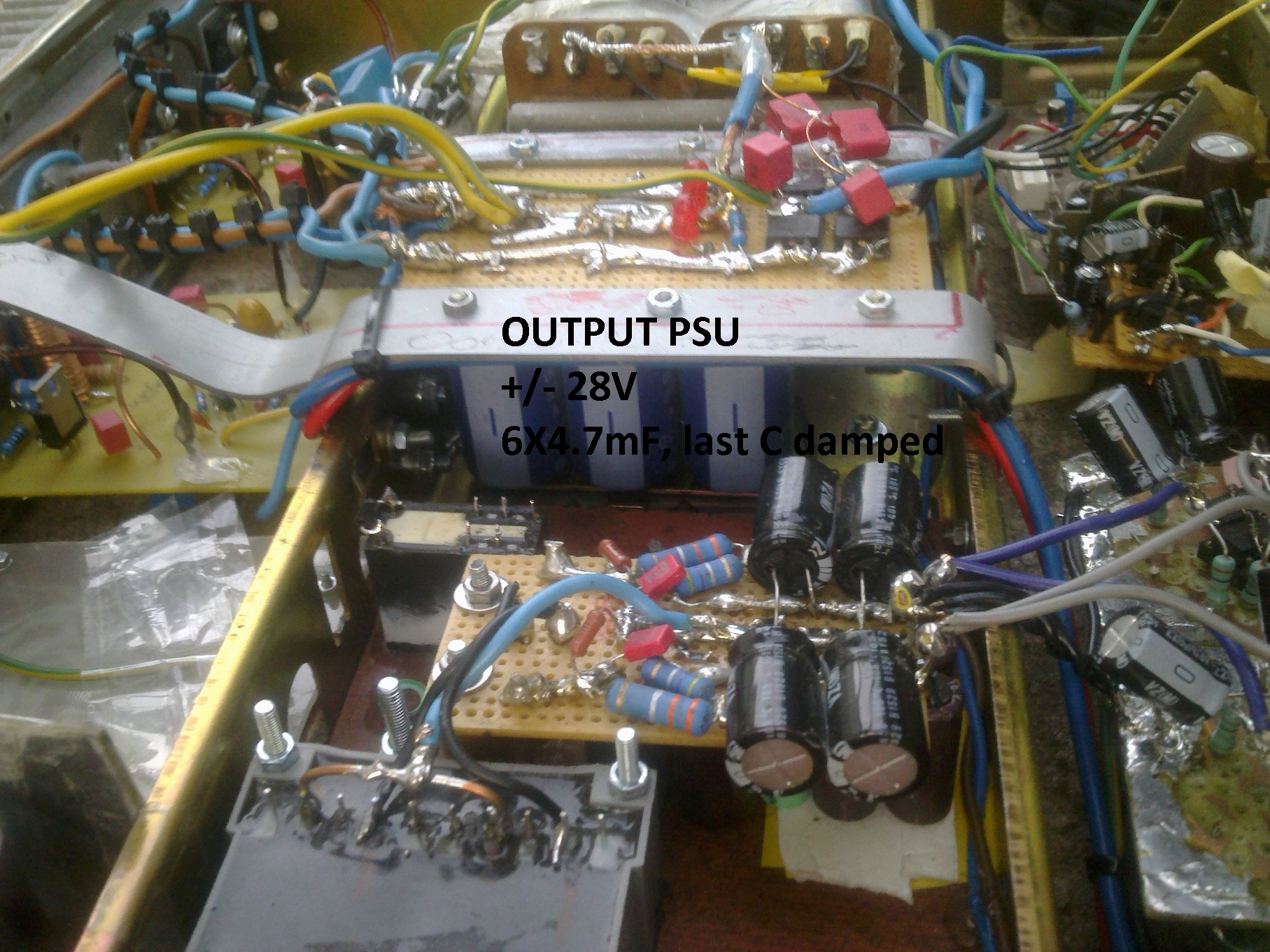

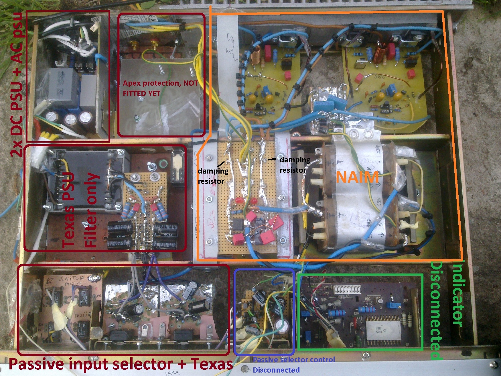

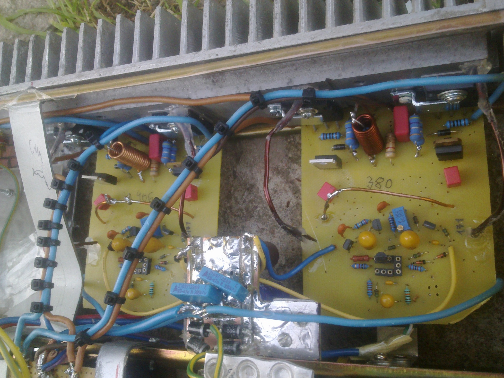

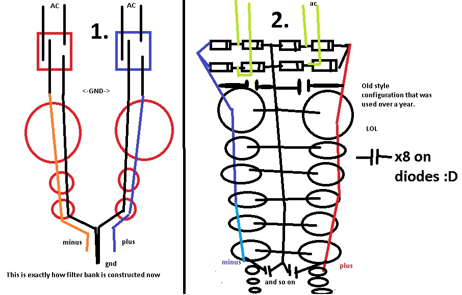

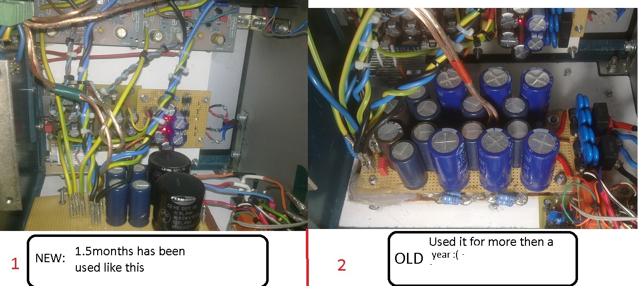

1st picture is now what i am using for about 1.5months
2nd. is the previous configuration that was used over a year.
Yes, new setup wich actually includes component removal is better.
Highs frequencys got cleared up, more damping factor = less but more
controlled bass.. like punchy. Still plays pretty low.
I noticed, that sound got more interesting again... a little bit front-
sounding on certain freq. spectrum.

Next thing is Font-End supply removal only, to listen the effects... it should be positive as i described long ago, cuz it is not ment to be in the design, when looking at naim amps 🙂) ...

1.
No, original naim spec'd amplifier is in another case, also demonstrated lately in this thread. Running on +/- 27.5V DC with separate front-end supply which is +/- 33V DC just rectified and filtered.
This is the amplifier, where i played with Driver base network-filters. The design is the closest to naim NAP 140, expect the rail voltages, too low i guess....
2.
My main amplifier and the same experimental one is the Ebay-clone H-140, where 2SC2705 and 2SA1145, both Y- type(gain) are used in VAS.
BC550B PH-03 LPT and
MPSA06 CSS
2SC5200 on outputs as always with MJE243/253 drivers.
MPSA06 CSS
Front-END is regulated here. But as i promised, will be removed.
