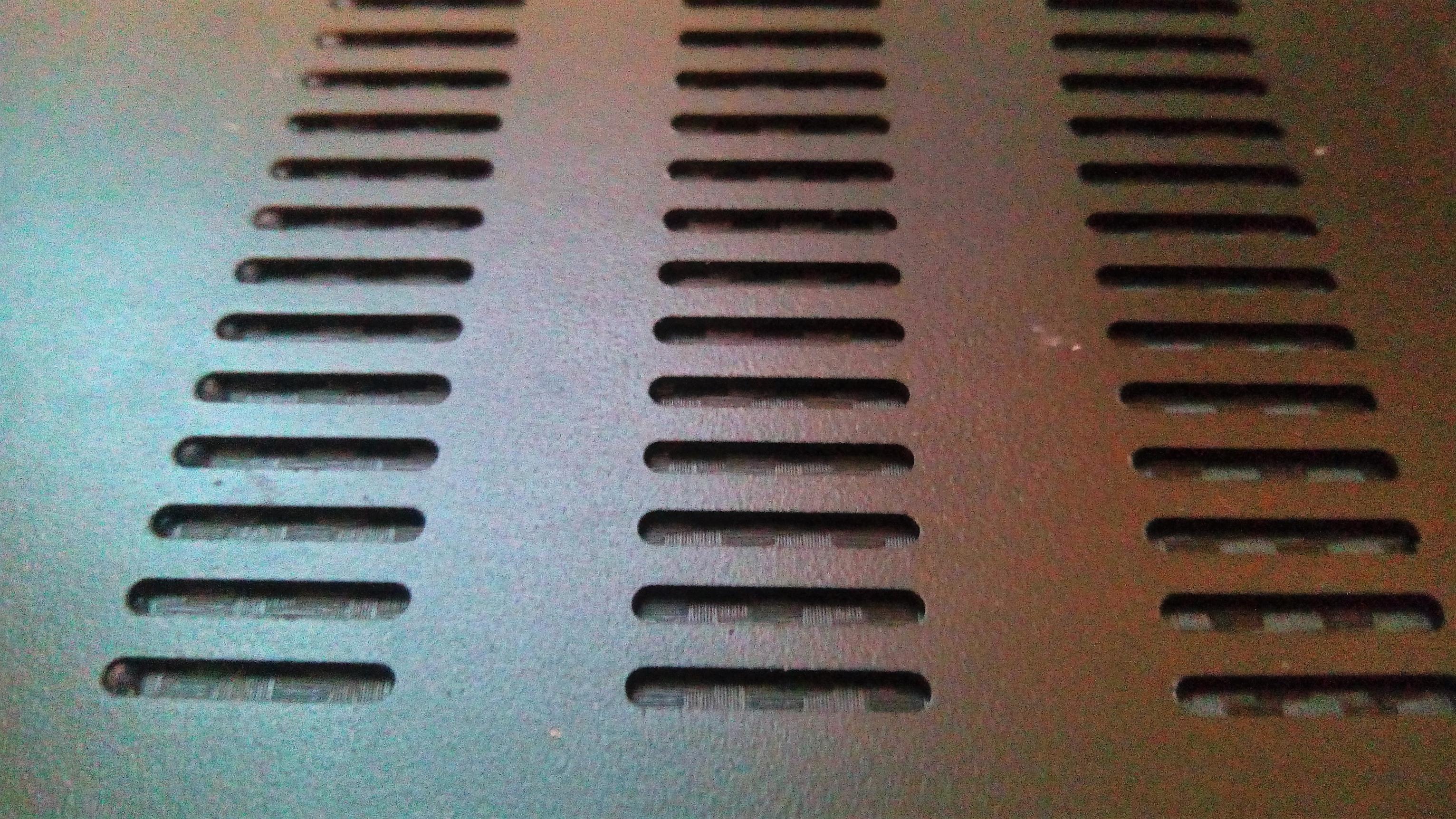

Out of curiosity I've just taken a quick look at the ebay listings for your case and it looks as though there are vents on the top. Apparently the NAP200 board is designed to be used in a sealed enclosure otherwise the amp can be subject to thermal runaway. I found a Chinese forum with posts relating to this kit and, with the help of Google Translate, found that this had actually happened to some kit-builders and with bad consequences. If your case has vents then you may wish to consider sealing them if you haven't already done so.
Chris
Thanks for that Chris, I'll sort out the vents. Though Naim cases don't seal the air completely, so I don't want to make it fully airtight.

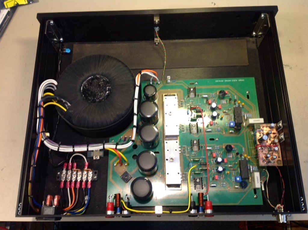

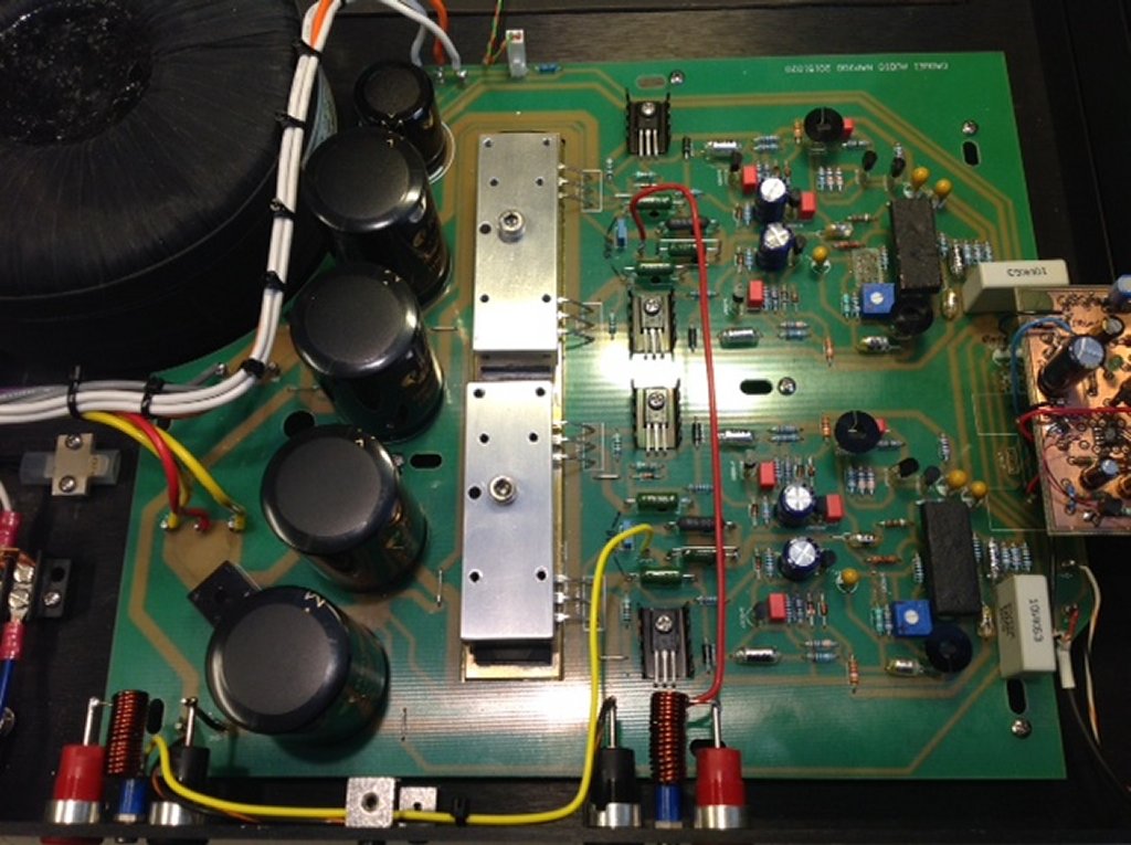

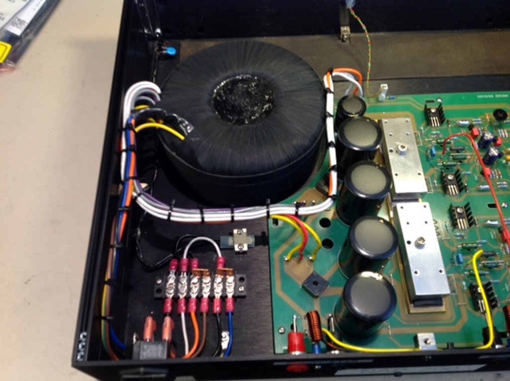

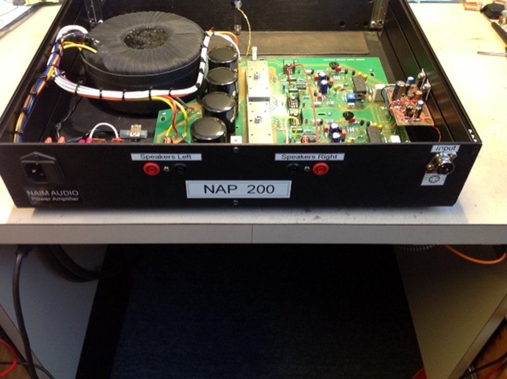

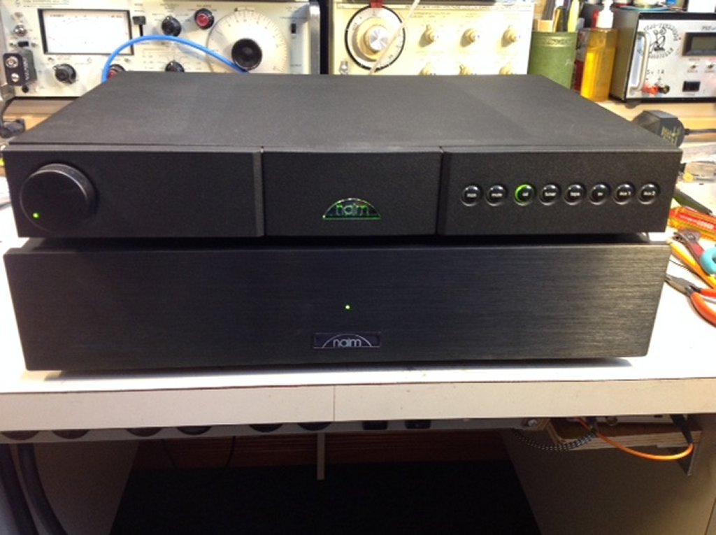

It is done, burning for some watts as I write 😉
-Custom made 300VA transformer, on 600VA core, dual 56Vct for the amp and 48Vct for the preamp supply, with shield and GOES band. Dual 117V primaries.
-LTP using selected BC239C with 10% difference HFE, and covered with thermal coupling aluminum block.
-Polystyrene caps at key location, as Naim do
-Original Tantalum input caps replaced by MKK film caps
-Original Naim DIN input 4 pins connector
-KENDEIL caps 10000μF, 63V for the amp supply
-KENDEIL 4700μF, 50V
-Internal wiring done Naim style...
-Front power-On indicator, green led and Naim Logo
-Feedback 27K resistor changed for Vishay CFM55 50 ppm type to reduce thermal modulation
-24V Preamp supply standard LM317 upgraded with DIY Jung Regulator
-R14 Speaker Output 0R22 ohms bypassed and Zobel installed (15R/2W and home made coil 16T, 1mm enamelled copper wire, on 6.3mm drill bit)
-75C thermal protection cutoff installed on bottom panel (as the original)
-Power-On switch hidden under the front right corner.

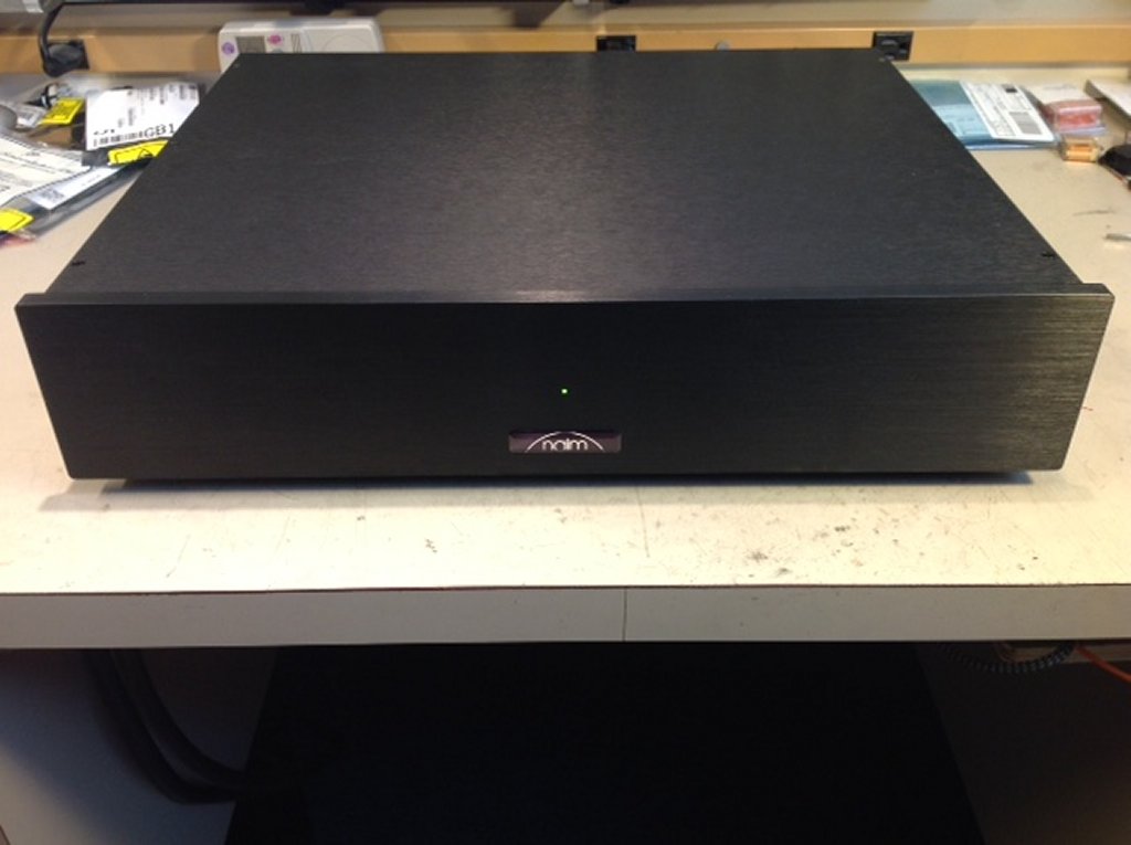

Thanks for the comments, yes I used the modushop case, with the cover without hole option. I blocked the bottom cover holes.
The output transistors are mounted on a brass bar I made, and it is firmly mounted on the bottom plate, with thermal grease.
Yes I know about the brass thermal resistance being worst than aluminum... In normal use the amp goes barely warm.

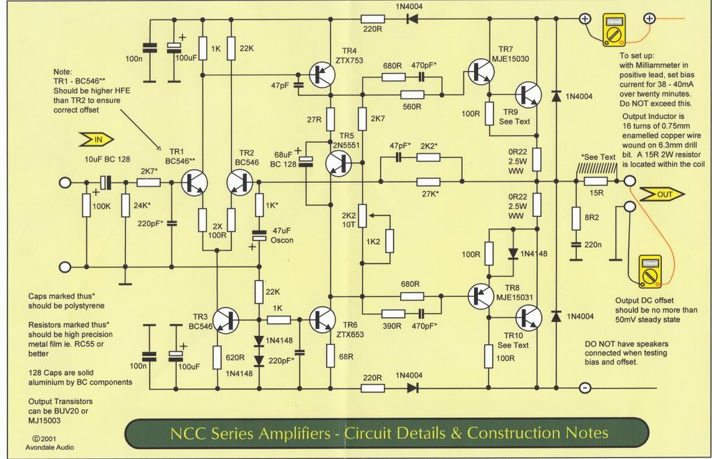

I got the Zobel idea from Avondale, see schematic. Apparently the Naim amps can oscillate with some speaker cables, and the output 0R22 ohms resistor increase the amp output impedance, reducing the damping.

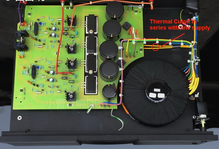

See the NAP200 user manual, they mention 70C thermal protection:
'' Section 46.2 Protection Notes - If the amplifier’s external case reaches 70°C due to prolonged running at high power, the mains supply will be interrupted and the illuminated logo will switch off until the amplifier has cooled down. This may take up to thirty minutes.''.
Hence it is not a mods but a feature on the original Naim amp. It can also be seen on the original amp picture, see the two wires going under the board? They are connected to a 70C thermal cutoff switch installed on the bottom cover, near the output transistors that turns off the amp in case of thermal runaway...
I used this thermal protection I had in stock:
5 Pcs Temperature Switch Thermostat 75°C N C KSD9700 Normal Close New | eBay

I then realised that I'd 'matched' the TR1/TR2 pair of transistors incorrectly, I was using BC550C's (after the discussions in previous posts) but I had matched them to be equal and not with Tr2 10% lower than Tr1😱.
I had some BC546C's- recommended in other Forums - which I've now swapped in for the BC550's, now getting about 10mV DC Offset on both channels.

Bias recommendation seems to be around 13mV across both 0R22 resistors (equals to 30ma, easier to measure double volt value). See this excellent page about the bias/THD: Naim, NAPs, Naits, distortion and bias-current settings
