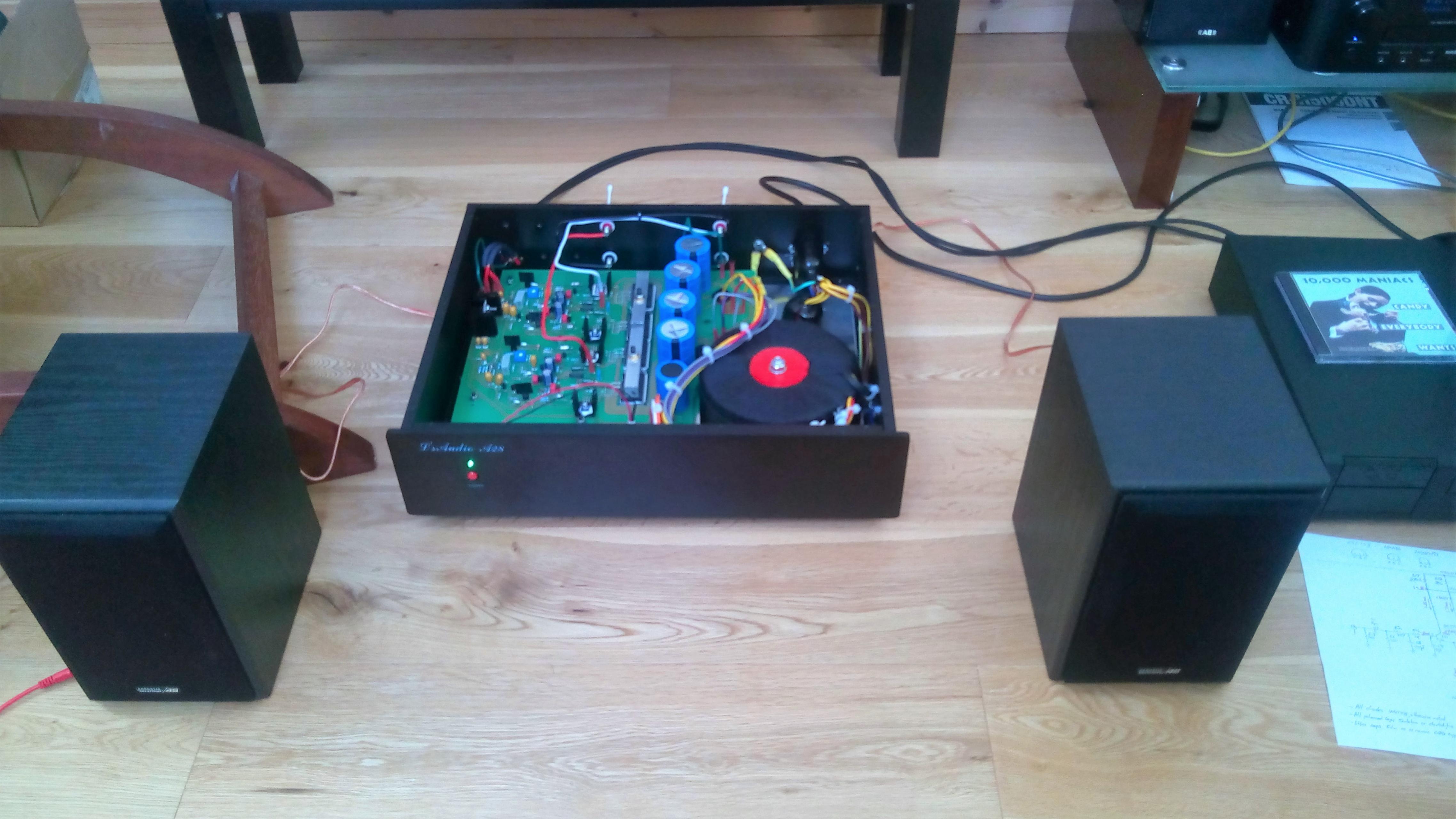

Hello and Thanks!
Hi, Just finished building a NAP200 Clone.
Many thanks to all here, it's all been valuable 🙂
Mind you with out a bit of luck and specific advice from Chris (Howarthcd), especially on the Toroid (Sourced from Tiger) and Algar_Emi (diagrams and part lists!!) I doubt I would be able to post some pics!
Lots of testing yet, but it plays music and appears (early days) to be running cool and best of all - no transformer noise - so far!
Anyway, I'm new to this, so very pleased to have got this far 🙂
Cheers
Robert

That looks great Naimart and excellent work for someone new to DIY. Yep, the transformer looks the part and properly wound too. Did you buy the full kit or just the PCBs but parts of your own selection?
Now you'll have to look around for someone with an original or similar vintage model somewhere to have a listening comparison. That would make an interesting post too 🙂

Thanks Ian.
I bought the PCB kit with loose parts 🙂 , and then the fun began! Initially just to see if I could, then it got a little more serious once I started to read on here!
I've changed some of the Caowei supplied parts, the tantalums and the variable resistor (trim pot?) and I'm using some BC550C's in place of the supplied MSPA18 for TR1 and TR2.
Other than soldering, the biggest issue I had was with the case. Probably should have gone for the modusshop ones recommended here (and other sites) but was enticed by a A28 lite case from Ebay. I liked the idea that it had a lot of the cut-outs already done!
However I had various issues to overcome; main one was that the base was 1mm and too flexible for the 'Tiger' 🙁 . I had to add a 4mm aluminium base plate to strengthen it and give a better heatsink. The front facia is nice though and it had the switch cutout I wanted.
When I get more confidence in it and it is off the 'light bulb limiter' I'll try it in my main system - maybe 😱
I connected it up with proper speaker cable and with better speakers, all fine and quiet - almost too quiet, if that makes sense - no hiss that I can hear. I'm using a passive preamp, so maybe that will come later!

Great looking build - you should be proud. 🙂
Out of curiosity I've just taken a quick look at the ebay listings for your case and it looks as though there are vents on the top. Apparently the NAP200 board is designed to be used in a sealed enclosure otherwise the amp can be subject to thermal runaway. I found a Chinese forum with posts relating to this kit and, with the help of Google Translate, found that this had actually happened to some kit-builders and with bad consequences. If your case has vents then you may wish to consider sealing them if you haven't already done so.
Chris
