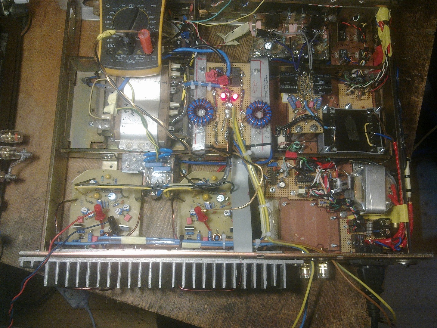

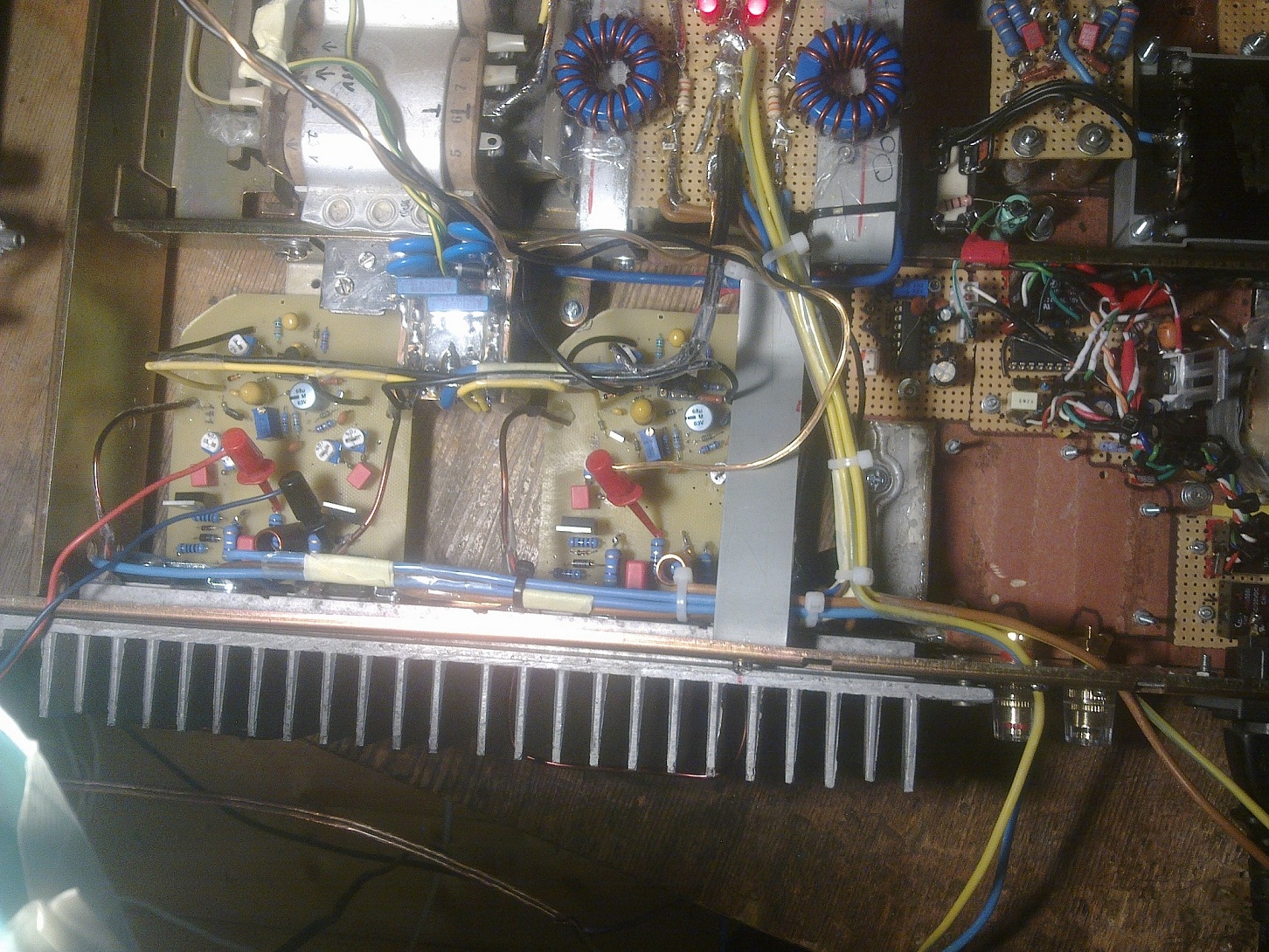

Ok after very fine tuning here and there I have the final noise level that I'm comfortable with, and AndrewT may be more happy 😉
I have now 0.1mVac (89db down from 1W) at the output, and I cannot here a thing in the speakers.
A few things that I did: Grounded the LTP aluminum block, correctly installed the polysterene caps to insure that the outer foil is the one close to gnd (biggest improvement), fine tuning of the transformer rotation for lowest noise.

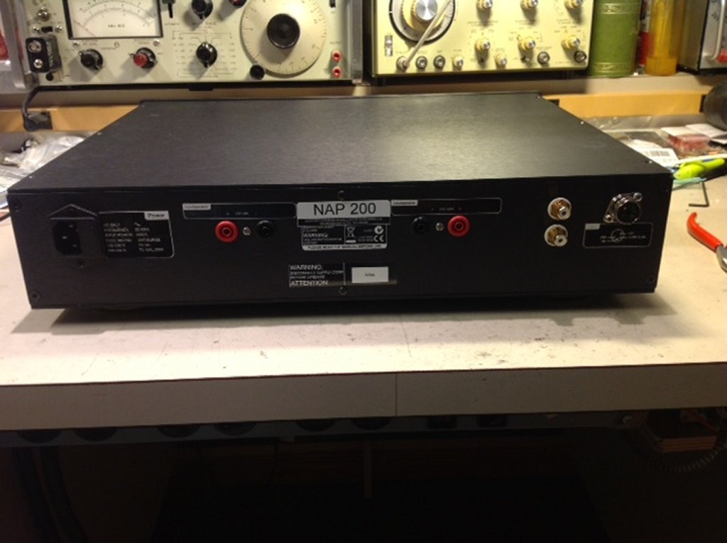

Here the last version of the rear panel, I added an extra RCA input.
BTW my ALW Jung regs has 0.07mv ripple of the preamp 24V, pretty good for an input of 80mVac ripple.

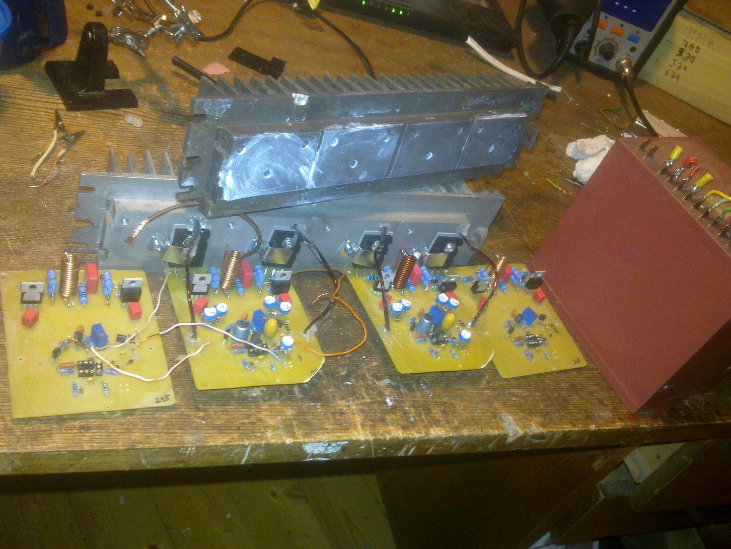

I have finished soldering 4 identical boards that corresponds to NAP 140 original design, leaving headroom for front-end supply and other modifications/snake-oils on the PCB-s.
As i have written before in this thread, there are 4 transformers sitting and doin nothing.
I could make 2 identical PSU-s from 4 transformers with the 48-50VDC/~300-400W per PSU and connect all four boards to these PSU's for the final two stereo AB solution and test everything(grounding, cabling, EMI filters, Snakes and oils, film bypass trends and so on).
It took long, as everything i have gotten so far is free or very cheap, so, it can be partially wasted.
I would allready have done it if only the transformers were lower voltage, about 40VDC, so with the 50VDC is this worth the hassle, cuz most of us here don't have that kind of crazy voltage on they AMP boards🙁(??
Also what bug's me is the metal case... because amplifiers sound different vs open environment, usually better @ last one.

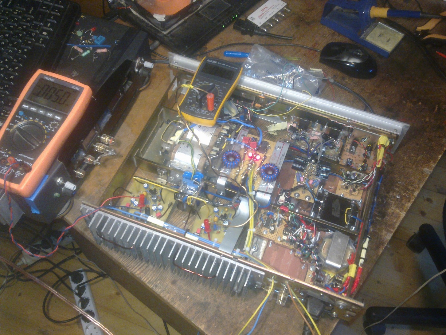

My god. Yesterday i took out AX11 amplifier board and replaced them with NAIM original NAP140 boards in an old metal case with new and fancy insides.
That tiny transformer delivers 2x28V DC(Main) + 2x35V DC(tiny current, for preamps or front-end).
So, after few hours of wiring naim's(OUPUT stage and Front end separated respectively) i turned it on and boom, oscillations... i could make it whistle pretty loud by touching naim output stage wiring. Actually, this oscillation traveled even to overheat protection/soft-start circuits and god knows where else 😀
So, i had my fingers all over the amplifier for some time until the Oscillator was turned off. Next, i took out input LPT pair transistors(BC550C, PH86 and PH65, HFE 500/550 respectively. The same ones here from ebay: 10pcs Philips BC550C BC550 NPN Transistor TO92 to 92 | eBay
Unpacked these https://www.fairchildsemi.com/datasheets/2N/2N4401.pdf that arrived recently from TME, matched gains and inserted them into naim LPT circuit.
Turn and woah, it works, BIAS works also, before, it was just jumping around while screwing it with a screwdriver.
After few more cycles of measuring, setting variable resistors searching for right resistance values, finally i set back and had a good listen to this beast.
First... unbelievable how much bass is there considering this transformer size and main 2x28DC voltage. The bass is comparable to my H-140 clone, which has 500VA transformer and ~50mF capacitance as filter bank..😕 ???
I don't get it, its a totally different beast and far ahead of H-140 "clone" lol, everything is not just better, its sooo interesting to listen, outstanding!
I am sure that this amplifier can make ppl smile and also cry 😀

Hi Ian Finch,
Feedback:
You are correct, 2N4401 aren't good in naim LPT, they need much more current for correct operation.
TIP41CG/TIP42CG are not good too(very high gain), i will write the resistors gain measurements at the end of the message, please see and if possible place a comment.
You are about 99% correct of the wiring loose or smth, i tried to follow the naim wiring techniques.
It could be my FRONT-END wiring fault... it sure looks a little bit funny 😀

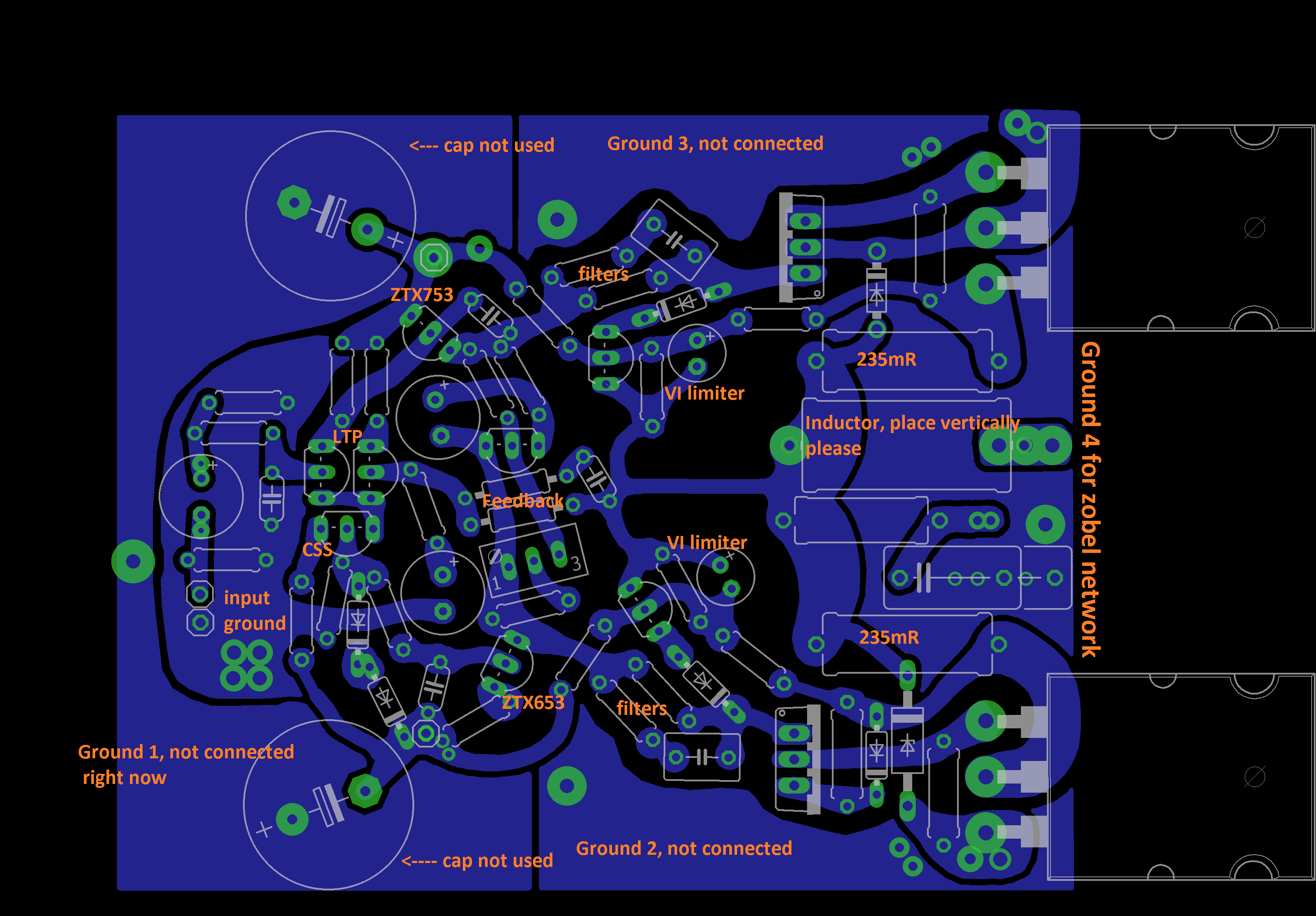

Yes, The PCB is 100% corresponding to NAP140, 180, 250 schematic, but drawn a little bit differently, VI limiter is included in PCB but not installed yet!! PCB copper layer thickness 18um.
The Inductor:
This inductor is less then 0.5uH in reality and was made from very THICK wire, so it won't affect damping factor(bass is accurate and goes deep down if necessary). 6mm diameter works best, as i have written here before.

Specifications:
For correctness, FRONT END voltage is +/- 35V DC
OUTPUT stage voltage is +/-28V DC
Because of the metal case construction, it is very comfortable to configure NAIM's, easy and fast (Y)
Another thing is that ground are properly wired, no ground-loop's inside naim or TIDU34 circuit. There is possibility for switching inputs:
