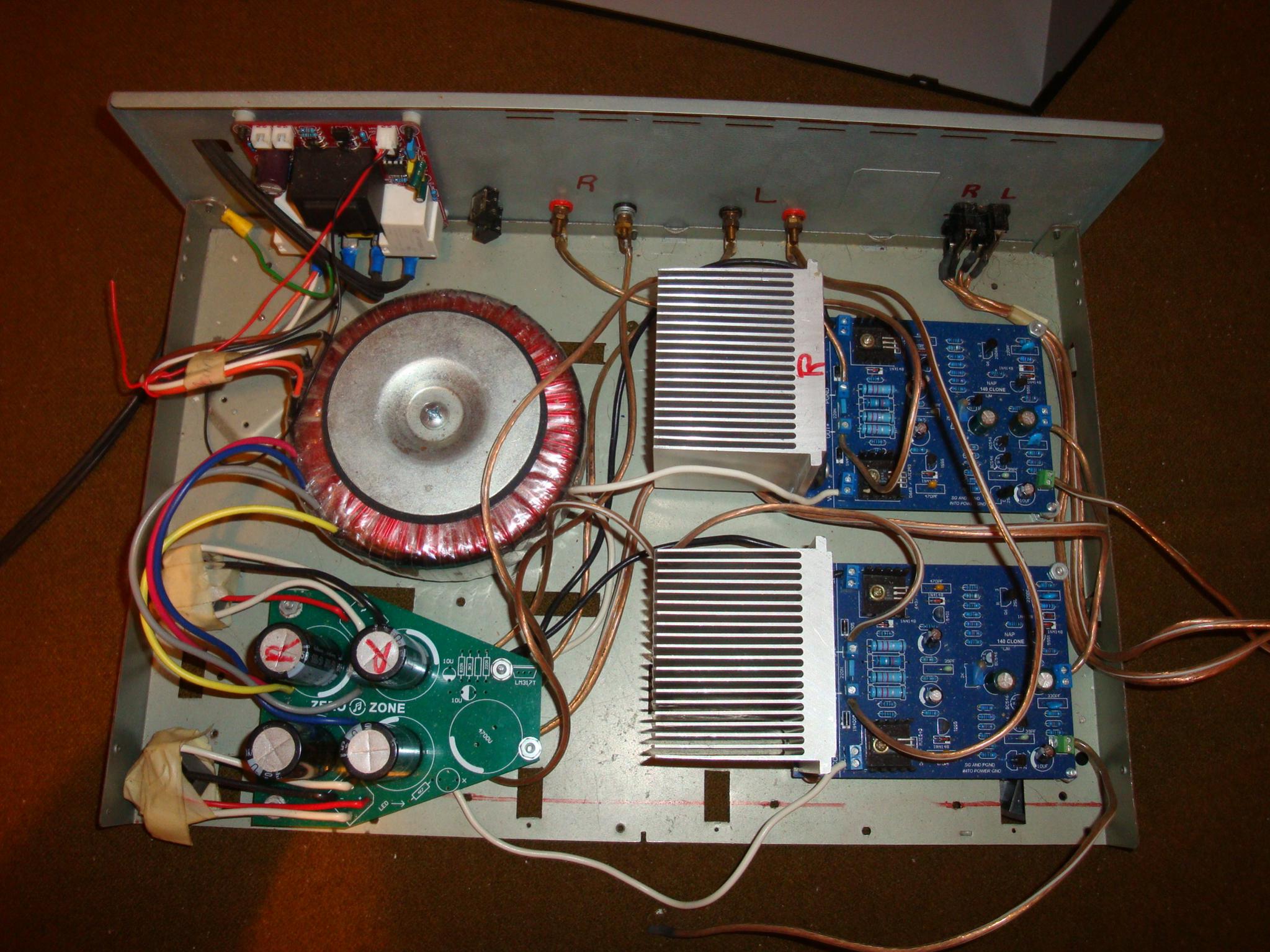

LOOP AREA !
where are the signal pairs?
Agree........
for signal please use thin wire and twisted if you prefer unshielded...

But other than that, anything wrong with my build?

is it safe?
A mains powered project must not electrocute it's operator, nor the todler that picks up an interconnect still connected to the project!
Checking my limbs, and nope no electrical burn marks.
All inputs and outputs are connected as per diagram provided by the manufacturer. No loose or stray wires/conductors, power cables and transformer fastened properly.
Is the Protective Earth wire permanently and mechanically fixed to the Chassis/enclosure?
Are there any exposed conductive parts?
These should be connected to the protected Chassis.
The Earth wire is permanently fixed to the chassis with a screw and the surface is scraped off any coating or paint to ensure conductivity.
There are no exposed conductive parts except for the ones that need to be exposed which are the connectors.

Dangerously.I don't know how you can build a ClassII product without the PE wire connected.

Dear group, I don't know that you remember me but this was my first audio self build. I have put this aside due to frustration. That said I did finally arrived at a working amplifier before putting it away, what I have accomplished in large part what I have learned in here and trial in error,LOL.( DONT DO THAT! )
My Problem!!! I have a low frequency hummm, a pronounced low-frequency hmmm but not the total silence I'm trying to achieve. The only thing that I have to chassis ground is the 120 V line in to my transformer. Am I missing something that is obvious to those of you that have built this? I guess what I'm asking is should this DC voltage be chassis grounded and if so where and what?
Your wiring may only be temporary, but you will certainly increase hum with all those long, loopy connecting wires. Have a look at how Naim do it, for starters. Next, your signal wiring is plain twinflex when it should be shielded or at least closely twisted pairs, routed away from noisy power wiring.

Ian, I will redo the input wiring for starters. Should I eliminate all of this speaker wire from the internal chassis? You're right this is not a finished product this was just trying to get something functional which I did accomplish. That said do you think any of this DC circuitry should be chassis grounded. Thanks
Input ground method
The input signal is grounded only to the amplifier boards themselves the positive and negative RCA inputs go directly into the amplifier boards

An overall principle of protective earth wired power supplies, like all DIYs should be doing in countries where it is possible or mandated, is to earth the amplifier once and once only to the chassis. Here's the general plan with details, suiting almost all amplifiers: Earthing (Grounding) Your Hi-Fi - Tricks and Techniques
Naim NAP amplifiers were originally developed back in the 1970s and wiring schemes have improved somewhat since they were introduced. The old models like NAP140 had few revisions over the years they were produced, until more recent models displaced them. Hence you see some anachronistic wiring schemes on them like the plain wiring still cable tied or loomed in bundles. It looks professional and "old school" and but is usually technically inferior to properly twisted power supply pairs or triples for balanced supplies, twisted pair output leads and twisted or shielded wire signal wiring.

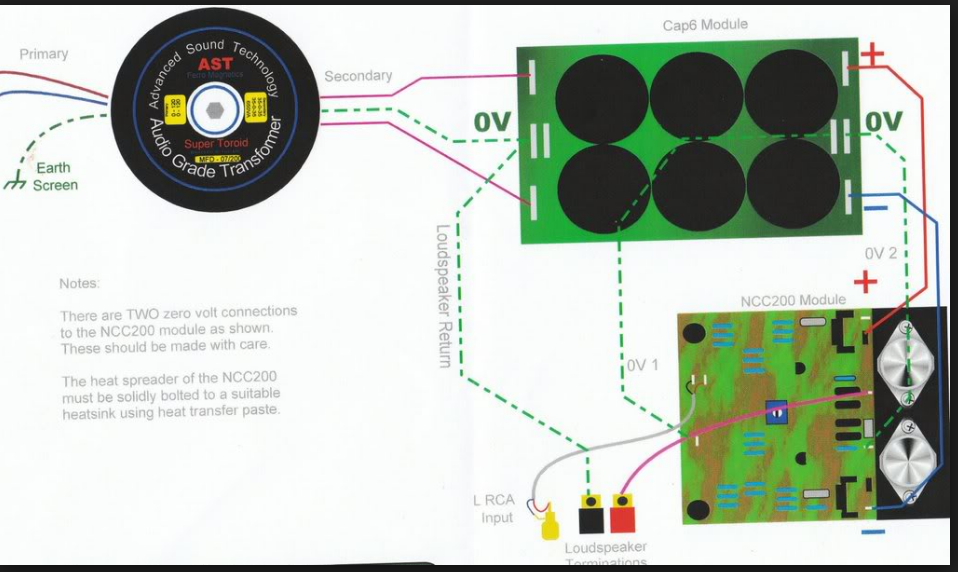

Good Naim clone board wiring is shown here in this thread a few times but you can still follow the connections using the better technique anyway. Here's a diagram showing how a up-market Naim Clone is wired.
