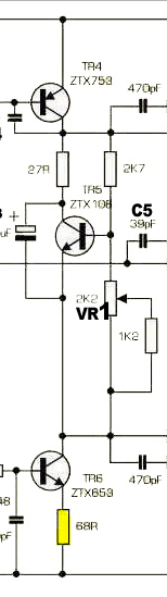

Calculate the current through the ZTX653/753 from the voltage drop across the 68R resistor. It should be only 6-8 mA and is not a problem if the correct series resistors and supply voltages are used. Note that 40V supplies are the maximum for the range of NAP designs and that in the original NAP140 amplifier, the supply rails were only +/- 34V. The attached schematic snip is from the generic NAP250 design used for the common Chinese clones.
E-line transistors such as these are small and consequently will run hotter than TO92 package transistors but as long as they don't "sizzle" with a moist finger on them, they should be fine. As an example of how tough these little monsters are, they were also used as driver transistors in the output stage of NAP90 and early NAIT models. Inside them is a medium power transistor chip, not a small signal type.

That's a large increase. It suggests that the parts you refitted to return to 1.5 mA, may now be wrong value, damaged or there is short or break in a trace that you haven't noticed. Check the collector resistor of Q1 which I assume is the same as TR1 on the Naim schematic(s) you find posted here.
Do you have the other channel complete for comparison?
Hi Ian and all the best for Happy New Year,
Tried to deal with dc out increase without success, the other channel is working perfectly and made some measurements. Also i replaced Q1,Q2 and Q3 keeping the rule of 10% hfe imbalance for Q1 and Q2 but dcoutput is the same.
Also i attached a schematic with voltages wich seems different to the working channel. In red between brakets are the voltages from "defective" channel.
I can adjust bias and is stable.
Restored the bias thru Q1 and Q2. Voltages on Q1, Q2, Q3 are the same in defective channel and working channel

you have not attached "-" to the negative voltages.
To make your measured voltages clear, attach + & - so we can tell the difference between them.

Once the circuit is working properly, then you can look at output offset.
let's start with output offset exactly zero volts ref power ground (where the speaker will connect).
Current must flow from the output through the 27k to the base of TR2. If that base current is 2µA then the voltage across 27k will be 54mV
Since the current is flowing into the base, then the base must be sitting at -54mVdc relative to Power Ground.
The voltage across the BE of TR2 will be ~600mV. That places the emitter at ~-654mVdc
If you know the emitter current you can calculate the voltage at the bottom of the 100r degeneration resistor. (or you can measure it).
Now go back up the other side of the LTP.
Volts drop across the other degen resistor. Volts drop across BE of TR1 and you end up with the voltage at the base of TR1.
Now that base current must pass through 2k7 plus 24k to get back to Signal ground.
Signal ground is shown as commoned to power ground.
You can adjust the base voltages on the two LTP transistorts by adjusting the "resistances" the pass the quiescent base currents in those two transistors.
These base voltages are what determines the output offset of a properly working amplifier.
Since the 27k between the output and TR2 sets the amplifier gain, then you don't want to change that.
That leaves the 24k or the 2k7 (on the TR1 base) as your adjustment for output offset AFTER you have got the bad channel working properly.
You can measure and record all these Vdrops and compare channel to channel.
This applies to any BJT input LTP stage feeding a Power Amplifier.
It does not apply to jFET LTP where base current is virtually zero.
The jFET Vgs determines the output offset. And difference in Id of the two jFETs affects the Vgs difference and thus even with well matched jFETs the output offset can wander anywhere.

Ah, maybe you are right Andrew, thanks a lot for detailed explanation on how works this circuit.🙂 I will check again tonight. I think i ignored if the voltage was positive or negative as i measured in comparision with the working channnel. Also i did not used degeneration LTP 100r resistors. I replaced thos 100R with wire.
Omitting the degeneration resistors increases the gain of the input stage massively.
That is very likely to reduce the stability margins and worse, maybe turn it into an oscillator.
