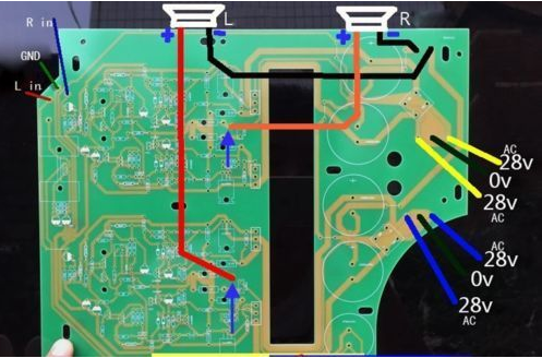

I bought the following assembled board from eBay.
2016 Assembled Black Box ?Clone Naim NAP200 Amplifier board DIY amp 75W+75W L
I received no schematics or anything so I don't know whether the parts are up to specifications. But assembly went on well and it runs well now.

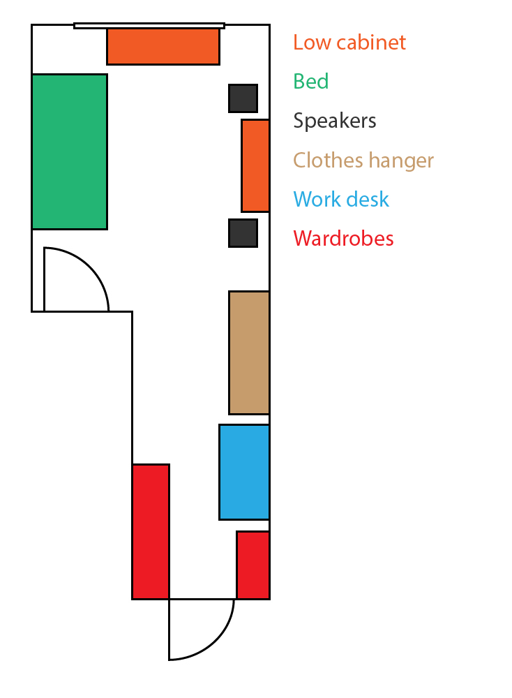

Attached is my small room diagram. My speaker stands are cheap reclaimed wood, probably from those wood pallets. I got them from a friend.
They have no spikes, but has plastic nubs that you nail at the foot of chairs or tables to protect the floor. Between the stands and speakers I've placed felt pads because the platform is uneven.
I've also tried to change the positioning with the speakers at the top of the room but the imaging was worse.

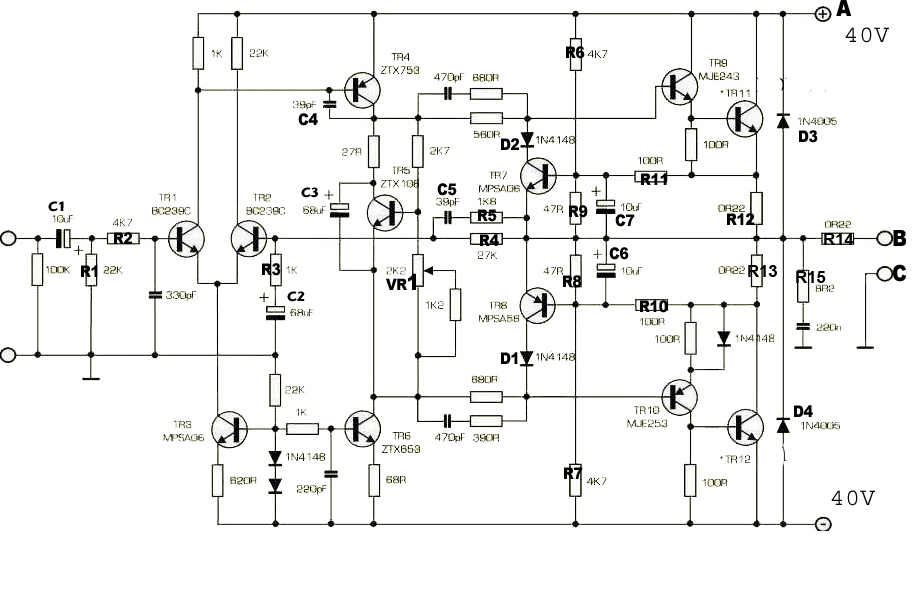

......Tried to deal with dc out increase without success, the other channel is working perfectly and made some measurements......Also i attached a schematic with voltages wich seems different to the working channel. In red between brakets are the voltages from "defective" channel.
I can adjust bias and is stable.....

Andrew thay are working well the off set for 80% is in the range 25>30mv however the rest are 40>50 mv note last rebuild i did not match tr1 tr2 , so first move match tr1 tr2 and then look at the the offset once more, comments please
David
the difference between the base voltages is the first effect that affects output offset. If you have 10mVdc across the bases and a DC gain of 1 then you have 10mVdc of output offset plus a tiny bit that has been divided by the gain.
The next effect is that due to the different Vbe of the input transistors. If you have a pair that are at the same operating current and have a difference in Vbe of 2mVdc, then these transistors will give an extra output offset of 2mV.
The two effects of base voltage and Vbe add together and one could be -ve with respect to the other.
Back to the base voltage diff.
This is V at base = base current * effective resistance to reference.
When you have two identical transistors operating at the same temperatures and the same currents and the same voltages then a difference in base current will be ZERO.
Now combine that with identical base resistances to Vref and you have ZERO output offset. And as long as you can hold the Tj to match inside the two transistors the output offset will not drift.
Your input resistor may be creating the offsets you have measured.
Try shorting the 27k with a high value resistor (when completely OFF and discharged) 27k||220k = 24k
Measure the +ve or -ve offset before and after, when the amp is cold and after fully warming up. That gives you some information on which to base the next adjustment.

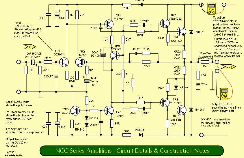

In your schematic the capacitors nearest the LTP are the wrong way around. Normally, the LTP bases will be negative wrt ground.
(PS: this is not a correct Naim schematic BTW)
Mr Vereker did do many things his own sweet way. I imagine Les Wolstenhome at Avondale Audio would just follow the hallmark design unless there was a compelling reason not to.
A Naim is very difficult to reverse engineer so many give up and try to make their own "improvements" and end up with an underperforming Franken-Naim.
The schematic on the right does not accurately depict a Naim (assuming that's what it is meant to be for) and both have a basic mistake in them. Best not to build from them verbatim.
I attempted to reposition my speakers and see whether there's better imaging I can get from my setup and I'm happy that I managed to.
It turns out its because of a combination of a few things, mainly the distance apart and from the back wall.
They're now about 5'6" apart and 2' from the back wall. The roughly 3' shelf has been moved to simulate a faux wall so the listening area is only 11.5'x9.5' and doesn't include the 2nd portion of the room.
I achieved better imaging from my turntable too instead of my Spotify. Though I'm a bit miffed that my speakers are so revealing that I'd have to clean the stylus sometimes halfway through a side. Gunk is barely visible but vocals distort noticeably.
Speakers are also toed in but towards my back wall as suggested by someone from avsforum.

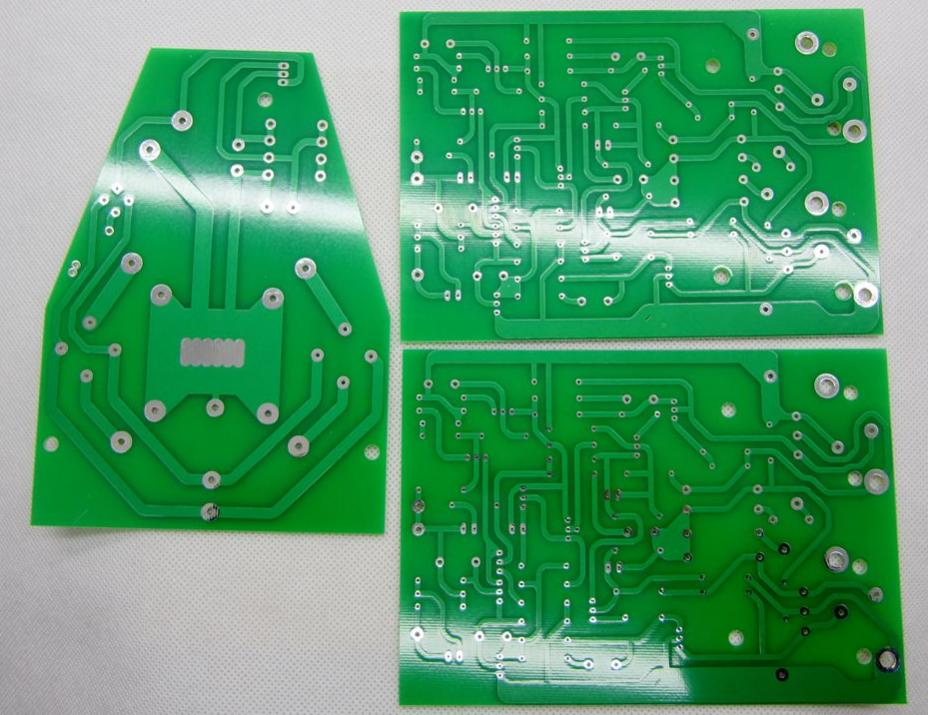

....I take it the pcb is carefully disguised as well; black substrate, and black overlay?.....
Haha...absolutely not - easy enough for anyone with a screwdriver to see and even scan the pattern without disassembly.
The Caowei board for the NAP 200 referred to is an exact copy, right down to the adjustable 2-axis mounting slots, finely slit grounding pads and traces. It's a work of art, just like the original. The 2nd attached pic. is another manufacturer's NAP140 boards which accept either MT200 or T03 o/p semis.
Unless we feel the brand of FR4 makes a difference, Caowei's clone boards are virtually the equal of the original boards. The real differences of builds are only in the component and PSU options (many of which can't be reliably obtained or replicated any more), the use of wiring looms, connectors and of course, the size and construction of the case and heat spreader.
No, these aren't like the majority of cheap kit PCB boards you find and if Naim screwed up the design of the PCB, so have the clone suppliers. Screwing up the star grounding (as happened on a couple of models) is a wiring issue.
