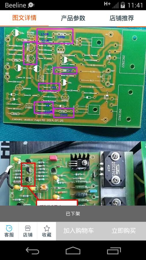

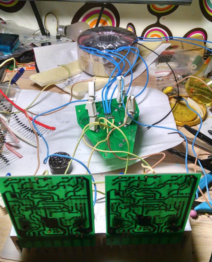

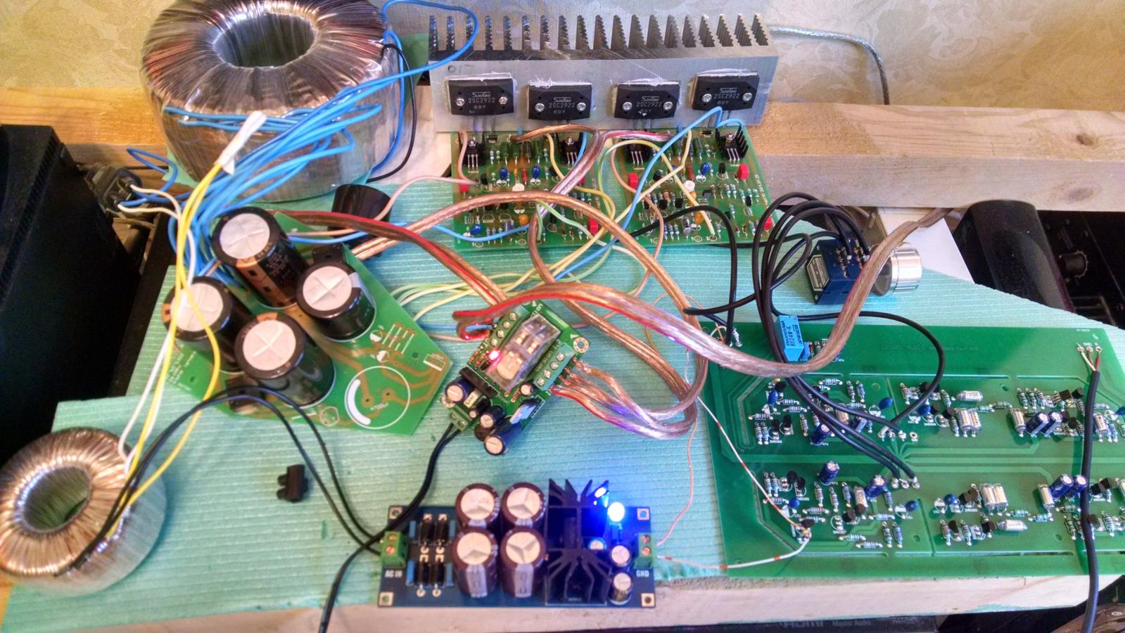

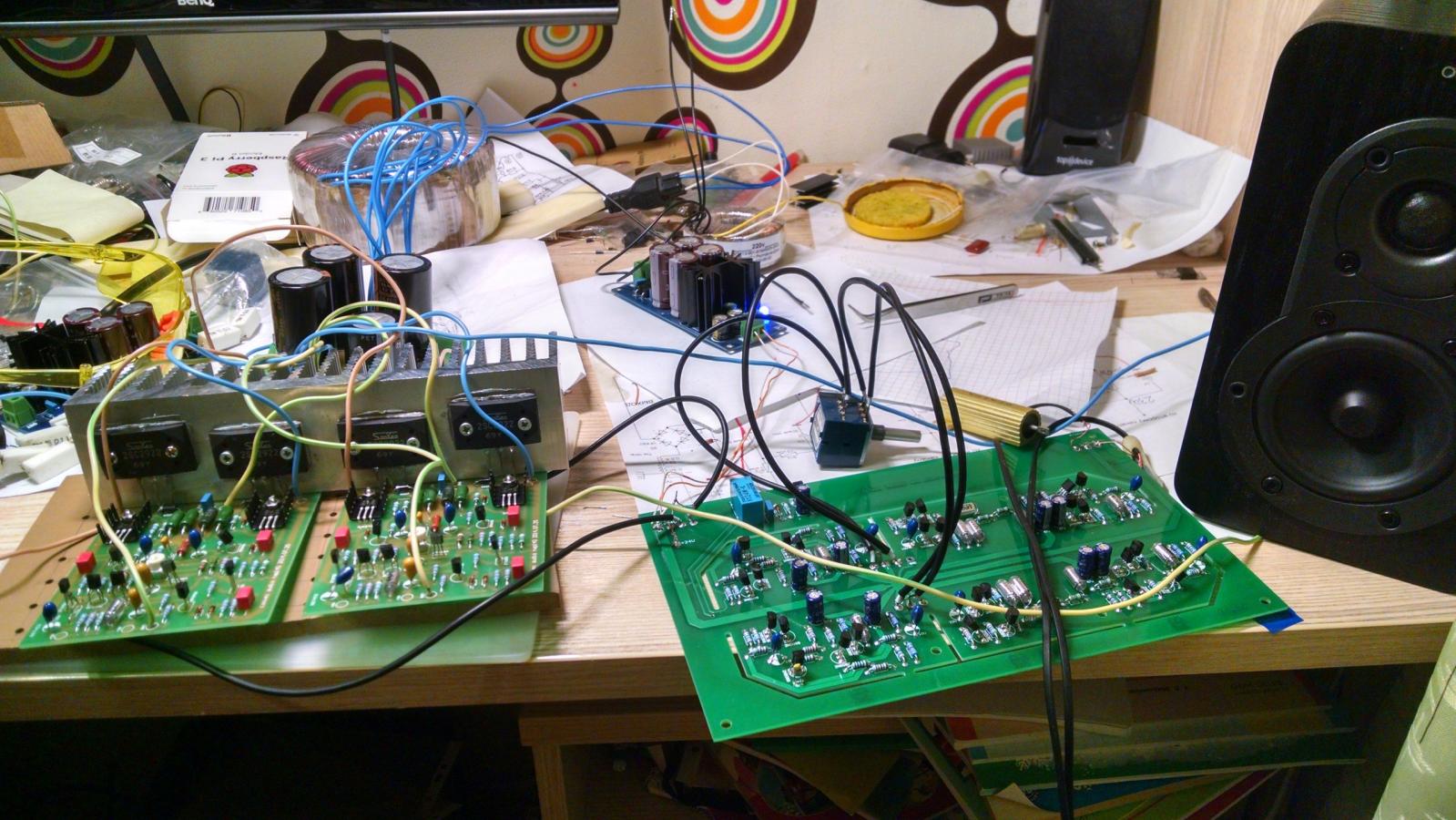

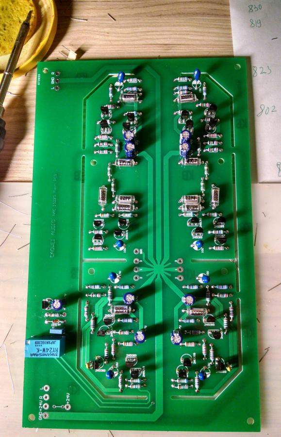

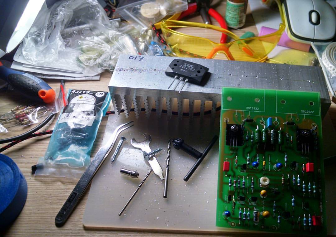

So, my Naim ))
TaoBao tweaks:
now I think what to make the case

nice vovans, please keep everything original😀
How is the preamp sounding ? Can you listen to it via headphones ?
please explain your phrase "please keep everything original". I'm sorry, I do not know much English.
No headphones are not listening. I wanted to try, but I forgot. All together sounds great, I really like! Without preamplifier not tried
He means keep everything original by using the same kind of capacitors and resistors, the same values, etc etc. This is because Naim amps are already designed with the kind of components to get that specific Naim sound. If we choose different kinds of components or values to "upgrade" it, it will not be original Naim sound (or close to) anymore.
