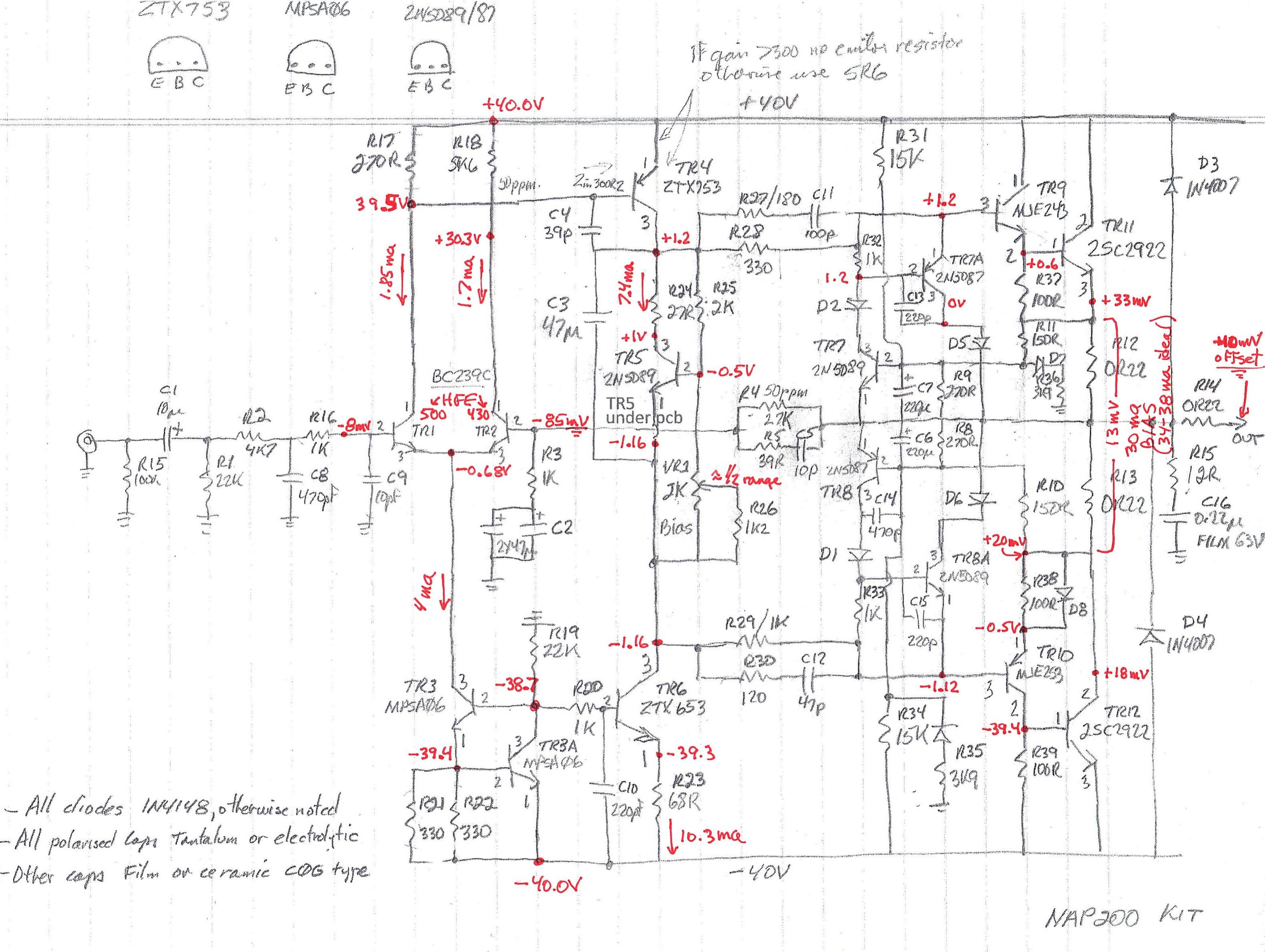

I received the BC239C for the LTP today, and after testing they seems genuine. Installed a matched pair (higher HFE for TR1) and the amp is working perfectly. Here the volts readings I got.
Gain: with 50mv input, got 1.4Vac output, or 28.9dB
BW (ref 1Khz) = 51Khz
With TR1-TR2 with the same HFE, I got 0.6V output dc offset, with TR1 (500) and TR2 (430) I have around 10mv 😉
I'll be able to provide matched BC239C pair for their Naim clone if anyone interested. I'll start a thread in the Swap Meet section shortly...
According to Chris the BC239C is the original part Naim uses...

The currents marked in red don't add up !
395mV across 270r is ~1.46mA, not the 1.85mA shown, (or is that 39.5V, giving a Vdrop of 500mV?)
1.85 +1.7 (plus a bit of base current) adds up to 3.65mA, not the 4mA shown.
4mA across a pair of 330r drops 660mV. That is probably very close to the correct value (40V-39.4V is shown).
Starting from the 4mA one would expect the 1.7mA to be around 2.5mA indicating ~ 26V at the collector.
Note also the 85mV and 8mV of mismatched Vbe at the -IN & +IN inputs. This difference would match with the 1.85mA:2.5mA mismatch of the inputs.
I believe it says 39.5V not 395mV.
Therefore there is 0.5V across the 270R resisitor = 1.85mA
Nice to see Algar get the same ZTX VBE as I got i.e. 0.5V. Took ages before anyone would believe this figure!!
