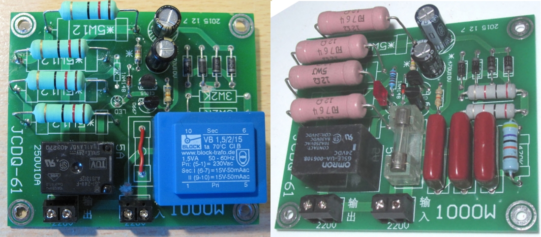

Granted a lot of parts will be replaced, but the actual PCB was easily worth what was paid for the entire built unit.
The ebay soft start board has now been converted to use a small isolating transformer, as well as having most other parts replaced.
The before/after images are attached. Hopefully it is easy to tell which is which.🙂
There was no need to secure the transformer in the end as I managed to re-use several of the holes and pads that the dropper capacitors previously occupied.
The fuse has been bypassed as there is a lower-value fuse before the mains touches this board. The transformer is rated at 15V output, but after rectification and smoothing, and considering the regulation value, this is more than enough to switch on the replacement relay.
I've yet to tweak the delay time as it's a little too long (~15s), but that should be a matter of adjusting the values of the components in the RC circuit, I'll probably replace the resistor having already replaced the cap.

Nice little transformer but why replace the better suited wire-wound surge resistors with MF types?The ebay soft start board has now been converted to use a small isolating transformer, as well as having most other parts replaced.....
It's more that I don't trust the originals, given the cost of the board. I replaced them with what I already had in stock.
The unit is working well, the amp is left on all the time so I'd expect the resistors to pass current maybe half a dozen times a year. During testing the power was cycled a dozen times and the resistors didn't feel particularly warm. The delay time is set to 3s.
What would be the advantages of wirewound parts?
