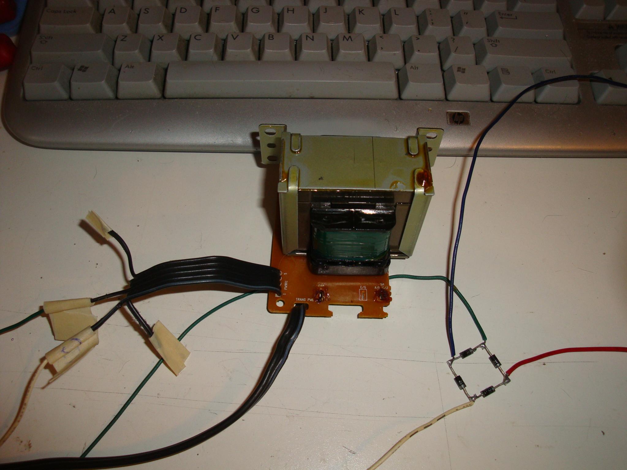

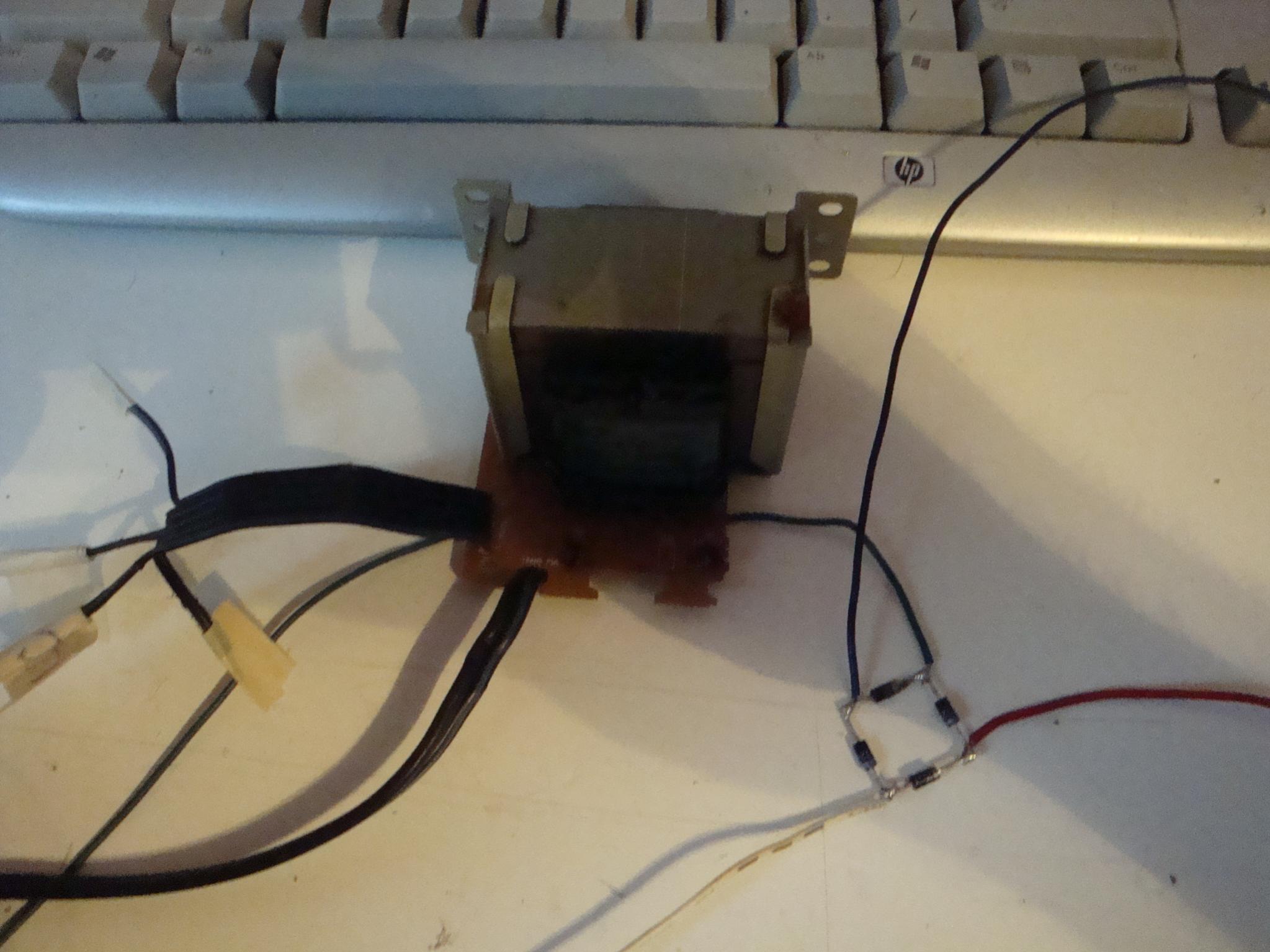

I built a bridge rectifier from some diodes I had to convert 29VAC to DC and ended up with 26VDC, the expected approx .7 volt per diode loss in the transformation. My question, using the 25 volt AC secondary output from a toroidal transformer how will I be arriving at the prescribed 40VDC for the amplifier board? Should I be using a 40VAC output from the transformer in the first place. Behold my first born circuit. Thanks

The question is a little bit more complicated than it appears. Usually the mains is taken to be a nominal 230 VAC ( 117 VAC USA, often now said to be 115 VAC +/- 10% ). That for safety has to be thought to be 253 VAC. A typical small transformer about 11 % regulation. If we take 25 VAC x 10% ( 253 VAC ) x 11 % we get about 30.5 VAC. That would be about 43.2 VDC without rectifier loss. If we say 0.6 VDC rectifier loss at the very small standby current that is about 1.2 V in the typical bridge circuit. That suggests about 42 VDC. In my house my typical supply is 243 VAC. On load the 25 VAC type gives about 37 VDC. That is fine with 50 VDC capacitors and shows no obvious problems with 40 VDC types even. 25 VAC seems as far as I would dare go.
The logical solution is to run lets say 30 VAC and 63 VDC capacitors to TR7/8/9/10. Run all the other transistors at +/- 39 VDC from a regulated supply. The transistors below are at worse 20 MHz, RS say 1 MHz. Even so 1MHz is as fast as any typical ready made regulator that often won't be safe at 50 V. If used in the amplifed zener type it is a painless way to make a very usable regulator. I was told in 1972 never to think of using one as the ready made would be better. That was the the most unwise advice I was ever given. If no regulator is used the amplified zener is already 100's of time better. The little bit of hiss they produce can be filtered. The big advantage ( very big ) of this is the amplifer becomes ideal in how it works. That means the VAS clips before the output transistors which sounds much nicer. The output transistors can never show the ripple mixed into the music. That is because the TR1/2/3/4/5/6/ see a near pure DC supply and the voltage headroom of the TR7/8/9/10 form a secondary regulator effect. The ouput stage will get slightly hotter. Also to my way of thinking the TR7/8/9/10 need to be 200 V types.
