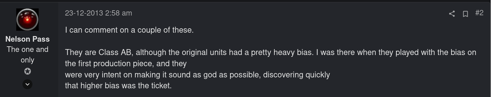

Hi Chris,
I think you misunderstood me; I'm not cranking up the bias by 2.5X; it's set at 40 mV. Actually, Chris, that's where you should have set it at since you're the last person who serviced it back in July of this year.

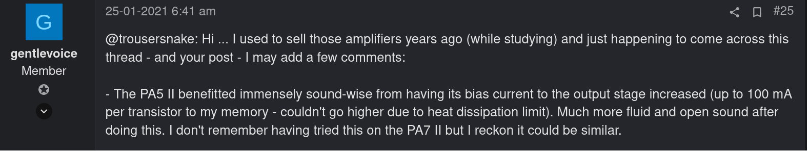

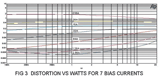

more bias to pa-7 lovered the thd that's for sure ,
I quote Nelson :"distortion is inversely proportional to the bias current."
with 55° at heasink ZERO problem a win win !
spk thd is another problem
The distortion produced by the PA-7 is pretty low already. I have seen, on the bench with my equipment, the reduction in distortion when higher bias is used. It is not worth the increased temperatures compared to the sonic differences.
Now, on the bench I am using Klipsch THX 6000 speakers (just the left and right). These are extremely flat (measured by two different individuals with two systems and mics) and very efficient. They are not cheap speakers and reveal everything. That's why I have them. The differences in bias levels are not discernible to humans. I proved my point to a client who believed as you do. He admitted there was no difference in sound quality.

"It is not worth the increased temperatures compared to the sonic differences." is only a personal point I can ear difference in resistor type that load my mc.....we are diy's here play and test is a must
if differences in bias levels are not discernible for the OP thats fine 😉
We are DIYs, however we must advise people responsibly at all times.
55°C is not a reasonable operating temperature, it is too high - period. Failure rate doubles every 10 °C rise in temperature, that is a documented, known fact.
When you hear a difference in some component types, it is expectation bias. My equipment measures easily and reliably 30 dB + below -90 dB from -10 dBu. I'm measuring things below a human beings ability to even perceive. So forget hearing that stuff. This is backed up by listening tests. That is the cold, hard truth. Some folks may not be measuring the right things, or interpreting the results.

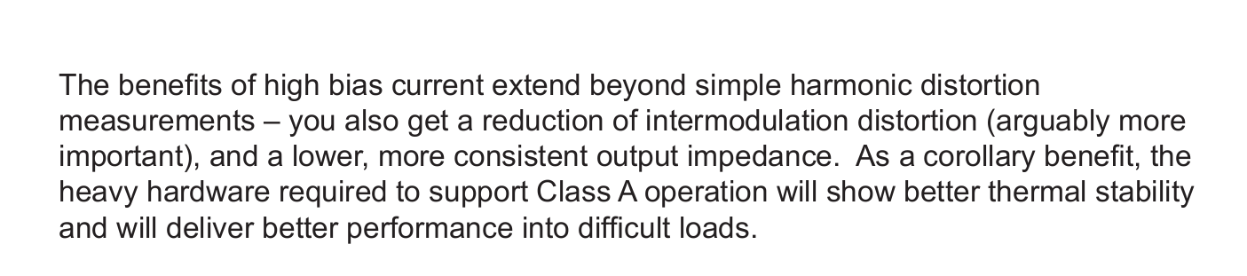

I'm not disputing that a high bias level has sonic advantages and other benefits but if one is not in the mood to listen to music it won't make any difference.

Hi nicoch58,
Nelson's statement is true of his low feedback designs. Not so of more normal designs. You have just got to equate what he is talking about to what we are talking about.
BTW, I have met Nelson a few times, and he is an extremely nice fella. But he is also honest about his design directions and they are not absolute. He follows his current interest. He has also found a lucrative design direction - which he follows. At least he is realistic.

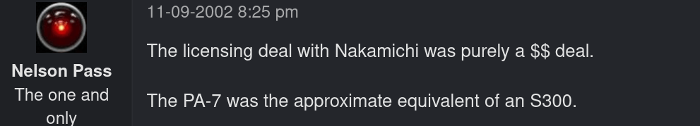

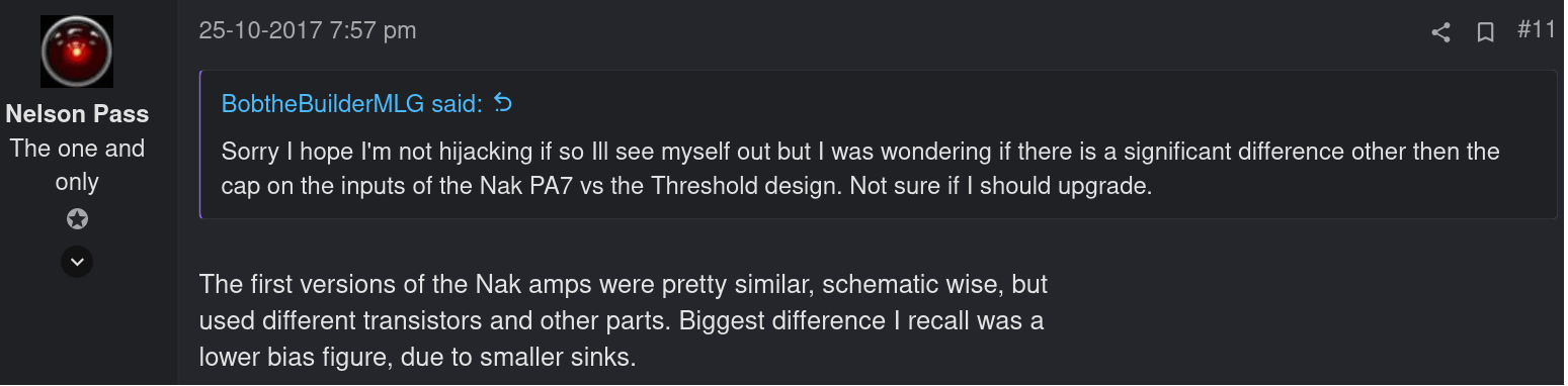

I am well aware, but if you look at the two amplifiers they are physically different. The Threshold build quality was much lower, thermal efficiency was lower too. The outputs used in the Nak product have a flatter current - gain curve also. That and matching was better even though the 1R0 emitter resistors minimized that requirement.
There are actually many differences that may not look like it on the schematic. I know both products reasonably well. I liked the Threshold amps, but I would actually wouldn't mind owning a PA-7, not so with the Threshold.
The heat sinks may be somewhat smaller but not by 60%, RE: Threshold S series bias at 100 mV VS: NAK PA-7 at 40 mV
I am surprised by that. The build quality on the Threshold S series (what I am familiar with) is pretty darn good. I will have to check out a Nakamichi at some point. They seem to be more popular just a bit smaller. Addressing your point before about Bias and sound quality, I run my Threshold S/500 amp at about 48 degrees. That seems to be good enough for me. Any hotter than that and I can run into an issue if the room gets warm for some reason.The Threshold build quality was much lower, thermal efficiency was lower too.

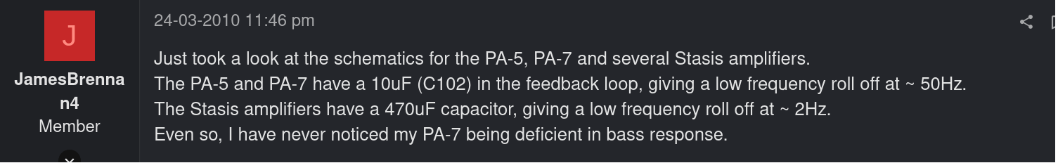

So this thread is about upgrades. I thought I would share my project. I have a Threshold Stasis amp. I have been playing around with a couple of things on it lately. Nelson pass made a new version of his front-end design. The front end is a simpler circuit with newer components. This could work for the Nakamichi amps. Look for the thread. 'New Stasis Front End' is the title. The Gerbers, schematic etc are all there.
I had adapted that front end to work with my S/500 which has stock 80v rails. It worked but the sound was a little off. The amp was prone to oscillation etc. I modified the amp even further by putting a lower voltage dual mono power supply in it with the DIYaudio Power supply boards and a couple of Antek 30vac transformers (39v rails) as well as the Diy audio softstart. That worked a lot better.The amp has never sounded this good. 🙂
So if you want to try to run the Nakamichi Stasis as a Class A amp with that new front end, that may be a worthy project. Zen Mod made his own stasis circuit board that is more compact.
I have been keeping my eye out for a good deal on a broken stasis amp to rebuild with the new stuff. If anyone has something laying around, let me know.
