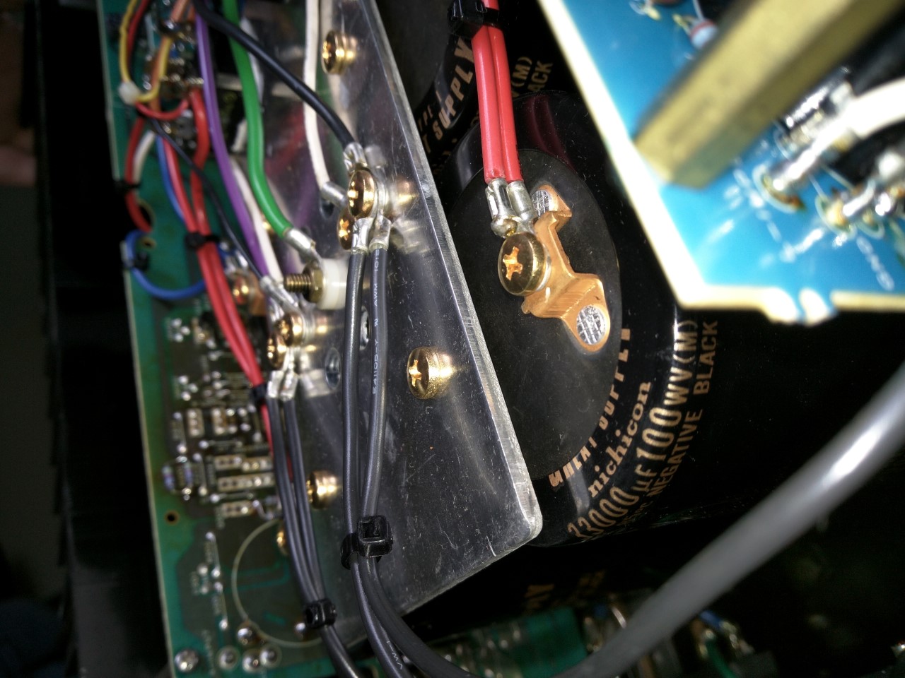

The installed cap "upgrade" in my PA-7 is 39,000µF. They fit the 63.5mm clamps that come originally in the amp. The 33,000µF are now smaller at 50.8mm and require different clamps. Each of the 4 39,000µF's.I received actually measured no more than 33,000µF in accordance with their published ±20% spec.
This is what I know as fact and therefore recommended in good conscience to the poster asking the question in post #37. It is not only prudent but also jives with YOUR stated guideline of "no more than 20% higher". I never advocated or agreed with the 47,000µF that the poster asked about. In the same post I also explained that I kept the rectifiers at 15A to avoid potentially higher inrush current casuing overheating issues with the soft start resistors. I gently suggested to him that there is more to it than meets the eye especially when he said he had not studied the schematic. I even told him there were different versions of the schematic so he should make sure his amp matches the schematic he is using.
Is that safe advice? Am I advocating caution? You bet. That is what I wrote to him to be helpful. Because I am safety conscious and polite in asking people to be careful.
Is that what you wrote to him to be helpful? No. Instead, you started ranting and raving at me obviously without reading what I actually wrote, and about something I did not advocate to do. And you have no idea who I am and what I know.

I took the lid off of my PA-7 today--one of my overload LEDs fell inside when I was cleaning the front panel. Turns out they are just glued on. I tacked them on with a little bit of adhesive, so that's done for now.
I was going to refresh the old cans, but maybe they have been done already. Was Nichicon around when Nak built these amps? There are four black 33000uF Nichicons in their currently. The inside of this amp was really clean. It doesn't look like it has been worked on, but, who knows?

Hi Wildcat,
I am pretty sure they were. Without looking up the manual myself, my quick response would be that they may be the original capacitors.
When an amplifier has been serviced by a good tech, it is very often difficult to tell anyone was working on it. However, the failure rates for these amplifiers has been extremely low. They are now having problems simply due to age. The filter capacitors are rarely bad in these, but an easy way to check them is to fire it up and let it reach operating temperature. Play some music while it's warming up - may as well enjoy the process. Use an oscilloscope on the AC coupling setting for that channel, set for 50 volts per division. Make certain the probe is in the X10 position. Really good cables are simply 10:1 probes. Connect the probe to the capacitor terminal with the voltage on it, and the ground clip should connect to the common "ground". Once connected, reduce the volts per division switch until you have a sort of saw tooth on the screen. As a capacitor fails, it will develop "pips" on the leading edge. The higher the pips are, the worse shape the capacitor is in. If you run music, you will see some of that waveform on your display even with good capacitors. Just watch for that leading edge pip. Check both polarities.
If you can't get to the capacitor terminals, you can probe the bridge rectifier, or the collector tab of an output. Take care not to slip with the probe as the energy can burn the tip right off. Makes an impressive snap too. You might cut your hand badly by jerking back and out with it. Take care when doing anything like this, it can be dangerous.
USB scopes. Make certain that you are using a quality scope. The less expensive ones can only accept 5 VDC, or 5 volts peak any combination of DC and AC wave forms. With a 10:1 probe, that means that your maximum voltage is only 50 volts peak! It's extremely easy to hook onto a larger wave form and blow the scope up. For comparison, a normal oscilloscope normally has a maximum input voltage of 50 volts, 500 volts using a good 10:1 probe. But read the front panel of the scope. My Agilent can accept 300 VAC rms (continuous sine wave), my Tektronix is rated for 400 volts peak. These are both very expensive oscilloscopes. Less expensive scopes tend to have lower breakdown voltages. Some older scopes have much higher limits - read the front panel, or manual. Where ever that information is.
Sound cards are usually limited to 5 V peak as well. Read your information before connecting anything to the inputs of your sound card. Some of these are also very expensive, and a goof here would really hurt.
If you don't have the equipment, have a friend that does give you a hand. Failing that, and honest technician will tell you honestly what the amplifier needs and doesn't need. I would recommend a shop or tech that was authorized warranty for Nakamichi, or a number of other good brands. Revox, McIntosh or Carver should be safe places. There are other good brands that also qualify for being responsible. TV shops are usually a bad choice, and I apologize to the good guys out there in TV service shops. Too many bad apples in that racket. Car audio service people are not tuned into higher end home audio, same can be said of professional and DJ amp repair people. On average, that doesn't mean everyone in those places.
