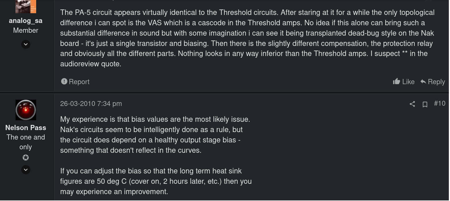

Anatech is having it completely right - Nak isn't made to elevate temps inside
it is doable, depending on your speakers you'll hear difference or not, but one thing is sure - if you want bigger (hotter) amp - either buy one, or build it
leave Nak as is ( recap if needed, change what is needed, set by factory specs)

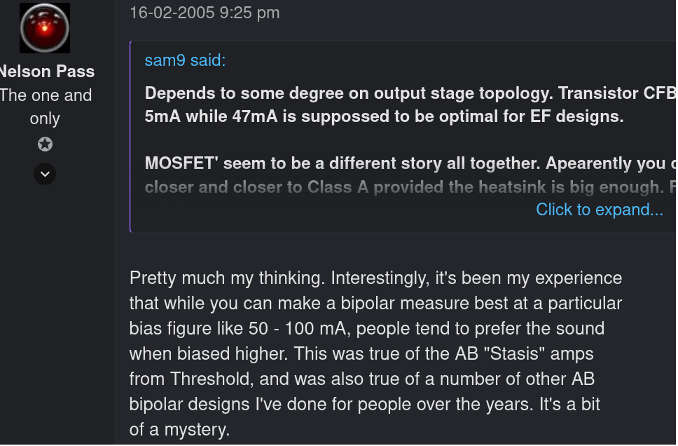

One low tech way to create a more linear circuit is to run it at higher current levels than advisable. The higher current reduces the delta I in the circuit with signal level, and charges / discharges capacitance more quickly (higher frequency response). Ignoring practical performance limits encourages a designer to tread into that high current area. The cost of this is higher part dissipation will will, and always does, result in higher failure rates as stated earlier.

This era of Nakamichi product was very well engineered. Customers received a well engineered product with very good performance at a fair price level that lasted longer than average for these products. This is a claim supported by the history of these amplifiers.
The engineering that went into these amplifiers go beyond the schematic. Output transistors were more linear, thermal path to the heat sink much shorter to the radiators with lower thermal resistance. Hmmm, more efficient in getting rid of heat. In general the parts were better and operating points well chosen. They did have a listening lab in the USA by the way. So people far less skilled in design, and even assessing sound quality want to come in behind and critique / redesign a product put together by a skilled design team?? Note I said team, it was a group of engineers, not any one person.

I have naka sr3 and the pa7 are cheaper copy of S300 work the same! fan solve all temp problem and affidability
The problem you have as in caps section, that you think that caps don't have a sound and hi bias cannot sound better !!

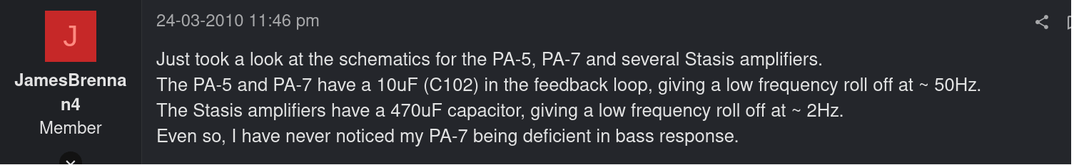

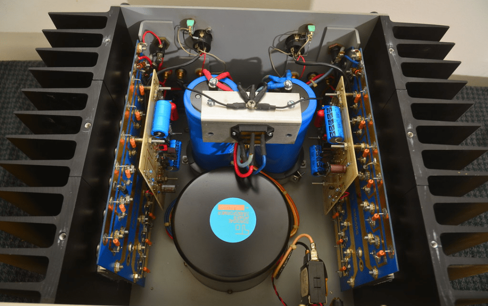

I’d like input on the best replacement mains caps for a PA-5. Best meaning quality and fit. Perhaps also best bets for the bridge rectifier.
the amp works, but it is exhibiting some hum and I know NP suggests the mains cans be replaced. The smaller caps are already replaced last year.

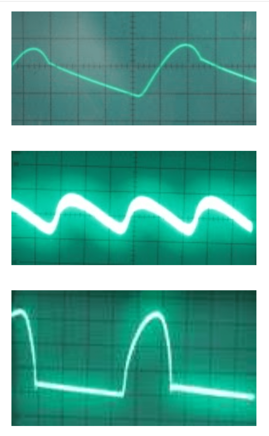

Okay, let's use some intelligence here. Don't blindly follow what anyone says, use common sense and some science to figure it out.
Nelson is a very smart guy, but he designs equipment that runs at high current levels and also - HOT. The filter capacitors in his equipment will not last as long as the ones in a Nakamichi PA-5/7 type amplifier, or a normal class A-B amplifier. It is about ripple current in the capacitor and ambient temperature. I have yet to find bad main filter capacitors in these amplifiers. I have found other issues I repair when inside, but not filter caps yet. I have in other amplifier brands. I have also replaced perfectly good filter capacitors in equipment and measured before and after (no difference). They also sounded the same. We commonly measure to levels well beyond what any human being can hear by using a sensitive spectrum analyzer designed for audio.
Take a good oscilloscope and have a look at the ripple across the filter capacitors. That tells the entire story. Filter capacitors are better sealed than other types, and there is more electrolyte inside too. They rarely go bad unless over-heated and then they typically vent. That's a clear sign you need to replace them. Better techs know what types of waveforms are normal, and which indicate a capacitor is aging. Do not install higher capacitance values.

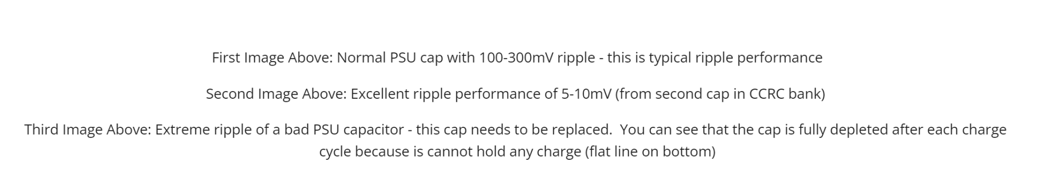

You mentioned the type of ripple on good versus bad capacitors. I stole the below information from Eric's Aleph X page:
https://sites.google.com/bucknell.edu/ericshometheater/erics-home-theater/aleph-x-clone-amp
Well, what happens is the less good condition a capacitor is in, it develops a "pip" on the leading edge which increases as the capacitor degrades. You will see this long before changes are measured on an ESR meter. However, the dissipation reading on a good capacitance meter (ie a real one like a 4263B from HP / Agilent / Keysight or similar) will increase before an ESR meter can show changes. Once you see that the charge doesn't hold well, that capacitor is really bad. Far beyond the changes you'll see on the leading edge or dissipation reading change.
I guess the important point is that you can see the condition of a filter capacitor while it is in-circuit and operating. Ripple will depend greatly on load current (so internal ripple current). The leading edge "pip" will always show you the health of the capacitor.

Over time, it has developed a mild hum. That’s the main symptom which has me staring at the filter caps.
