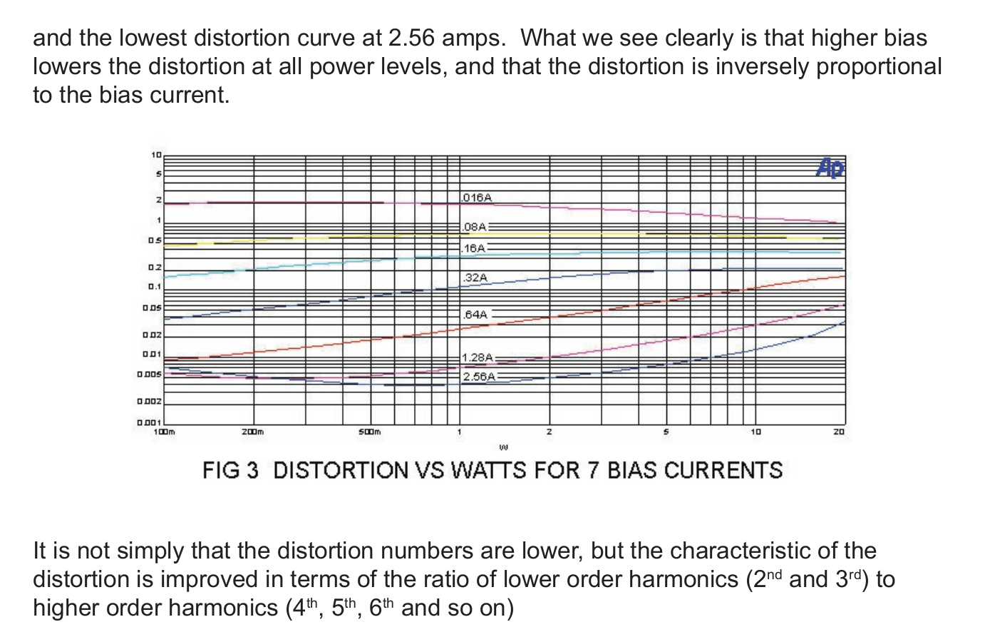

https://www.firstwatt.com/pdf/art_leave_classa.pdf nice reading ...
Reactions: Mikerodrig27
From the above pdf...
The bias is generally set at a level suited to the heat dissipation capacity of the hardware. At Pass Labs the bias is set to the value which raises the heat sinks 25 – 30 degrees C. above ambient temperature. The result is a heat sink which you can put your hand on for about 10 seconds or so.
I think I'd be replacing parts every other year if my bias was set that high on my 30+ year old PA-7A MKII. As Chris said NP likes to bias on the high side; stasis Thresholds from the same era as my NAK are usually set at 100mA, 2.5X more than the NAK
Hi UncleAng,
You do not need to do that. Just run the poor things at the recommended bias levels. Higher bias is not buying you anything at all. There are enough parallel out[put devices so your output impedance is low enough already.
Reality check time. What is the distortion from your speakers? Compare that to the amp. It comes down to the type of distortion where the PA-7 actually performs well. Other amps with the similar numbers may not sound as good. But cranking the bias 2.5X is not helping you at all.
