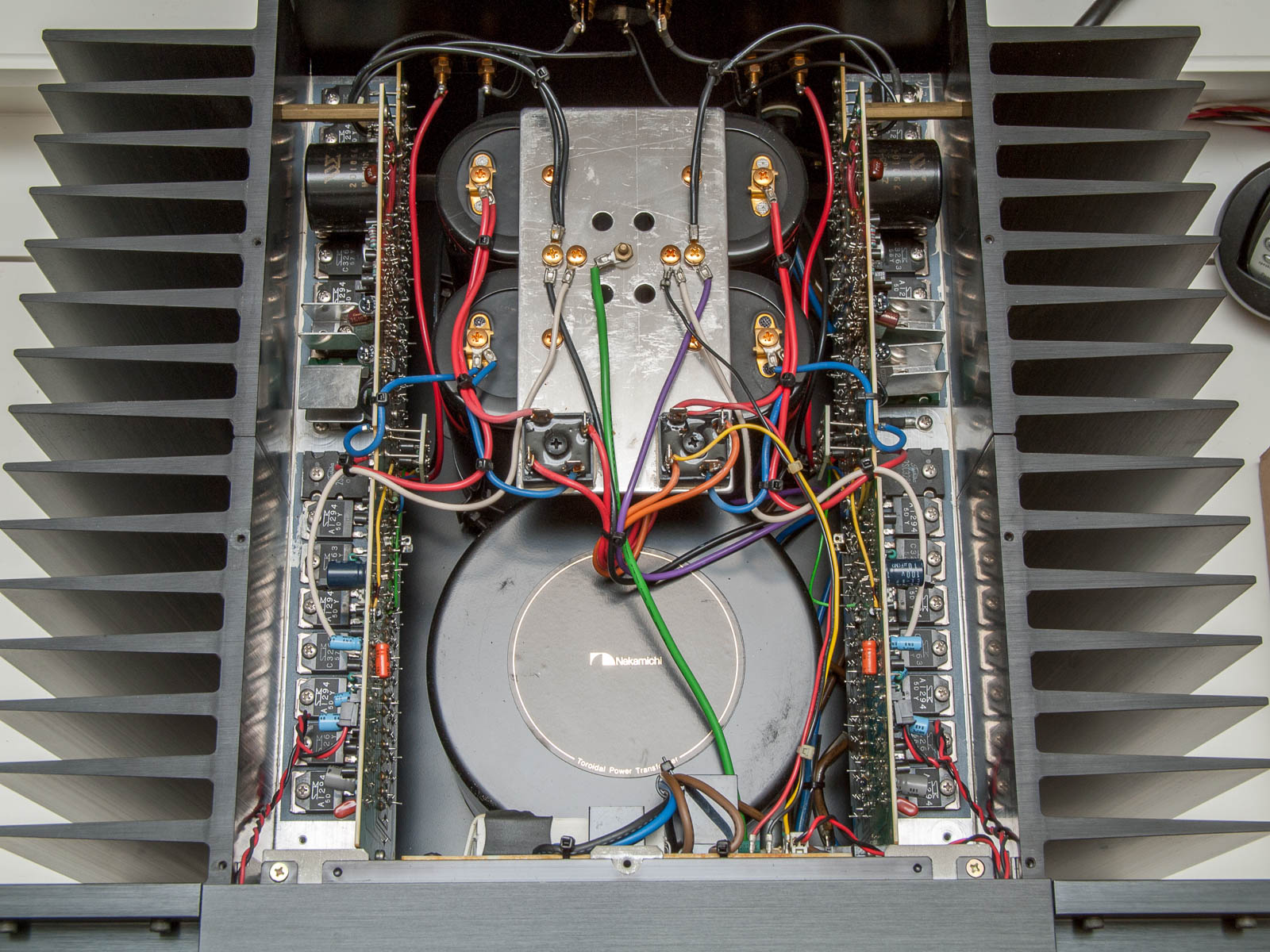

Well, finally got it done.
I like the sound of the "after" quite a bit: very dynamic, harmonically correct, highly resolving, eerily 3D voices and instruments. So much so that I can almost feel the brass instruments biting into me. And no complex passage could make it sweat. Yet it is also beguilingly warm when the music is properly recorded, just as it can be tuneful, rhythmic or downright chest-pounding if it was in the source. Dead quiet too.
I never thought a 30-yr old amp would sound like this. I remembered when these were around, along with the Thresholds, CJ and ARC, that it was quite rare the music played so convincingly and effortlessly from any amp on any speaker. I've had quite a few come and go, but this PA-7 is definitely staying.
I am now deliriously happy spending much more time listening to a lot more music than digging for the next mod...(famous last words)...

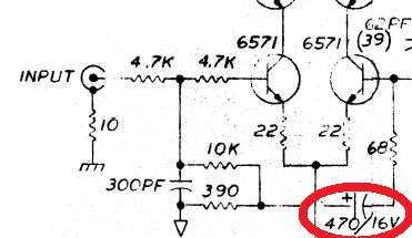

I have added a Mundorf ECap Bipolar Raw of 400µF 63V in parallel with C102.
Without added cap (ie. original configuration), gain drops -0.2db at 50Hz, -0.5db at 20Hz and -1.8db at 10Hz.
With the additional 400uF, gain does not drop at 50Hz, 20Hz or 10HZ.

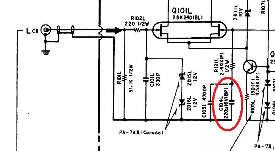

I now believe Nakamichi incorrectly identified C102 as a 10uF, 200V. My recent measurements indicate that C102 is actually 200uF (maybe 10V).
Has anyone actually measured capacitance of C102? Could there be an early version of the PA-5 compared to what I find with my PA-5s?
I suggest that it is change from polarized cap to non-polarized cap that improves the performance, not the increase of capacitance.

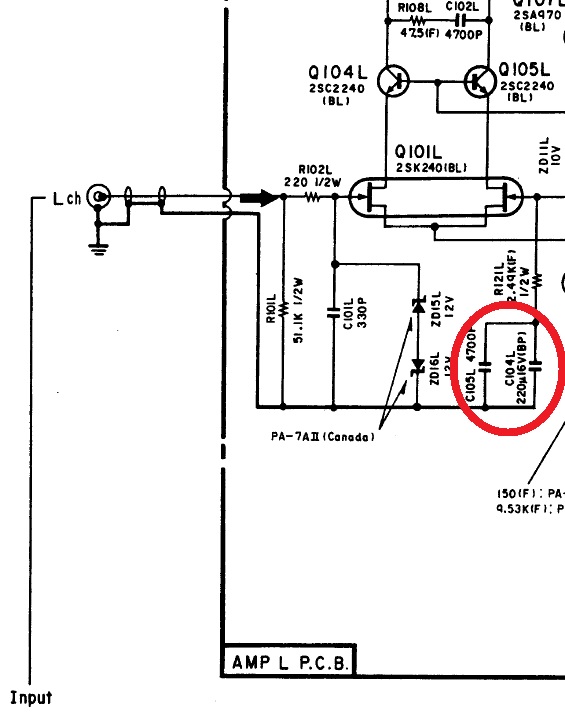

A few points:
- I paralleled a Mundorf ECap 470µF/63V Bipolar across C102 in my PA-7 and after the effect is not subtle - more dynamic presentation, more correct spatial delineation (difficult to believe from a electrolytic), and just feels more effortless overall. You can see this in the "after" in Post #31 above.
- Before putting the 470µF there, I checked out what is already at C102. It is actually a polyester cap, made by a Japanese capacitor company called U Sigma and is also used in other Japanese manufacturers such as Fostex of car audio and pro audio fame. Please see attached picture - the color of the cap is different but the markings are the same. So it does appear the Nakamichi service documentation correctly stated this part as 10µF /200V.
- But why they picked it over the 470µF as used in Threshold Stasis amps has been the subject of much discussion - the one I tend to believe came from Jon Soderberg who suggested it was likely to "detune" its performance so as not to steal the thunder from the real deal. Having the "correct" value in place certainly elevated the performance of my amplifier.
- James, on the PA-7 Mk II, the feedback cap is C104 and is specified at 220µF/16V so your measurement of 200µF corresponds with their service documentation. Please see attached picture. But the dramatic change from 10µF/200V to 200µf/16V to do the same job in almost the same circuit is a little mysterious to say the least!
