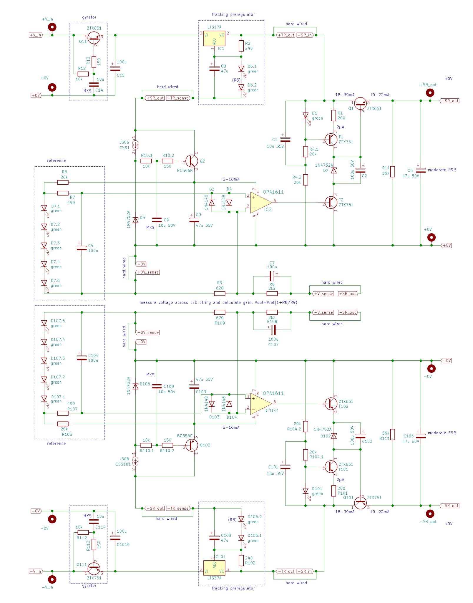

ALWSR, modified for higher voltage, it's basically a Jung super regulator, see attached schematic (there are caps missing at the outputs of the pre-regulators: I use 100uF).Jpk, what super regs are you using?

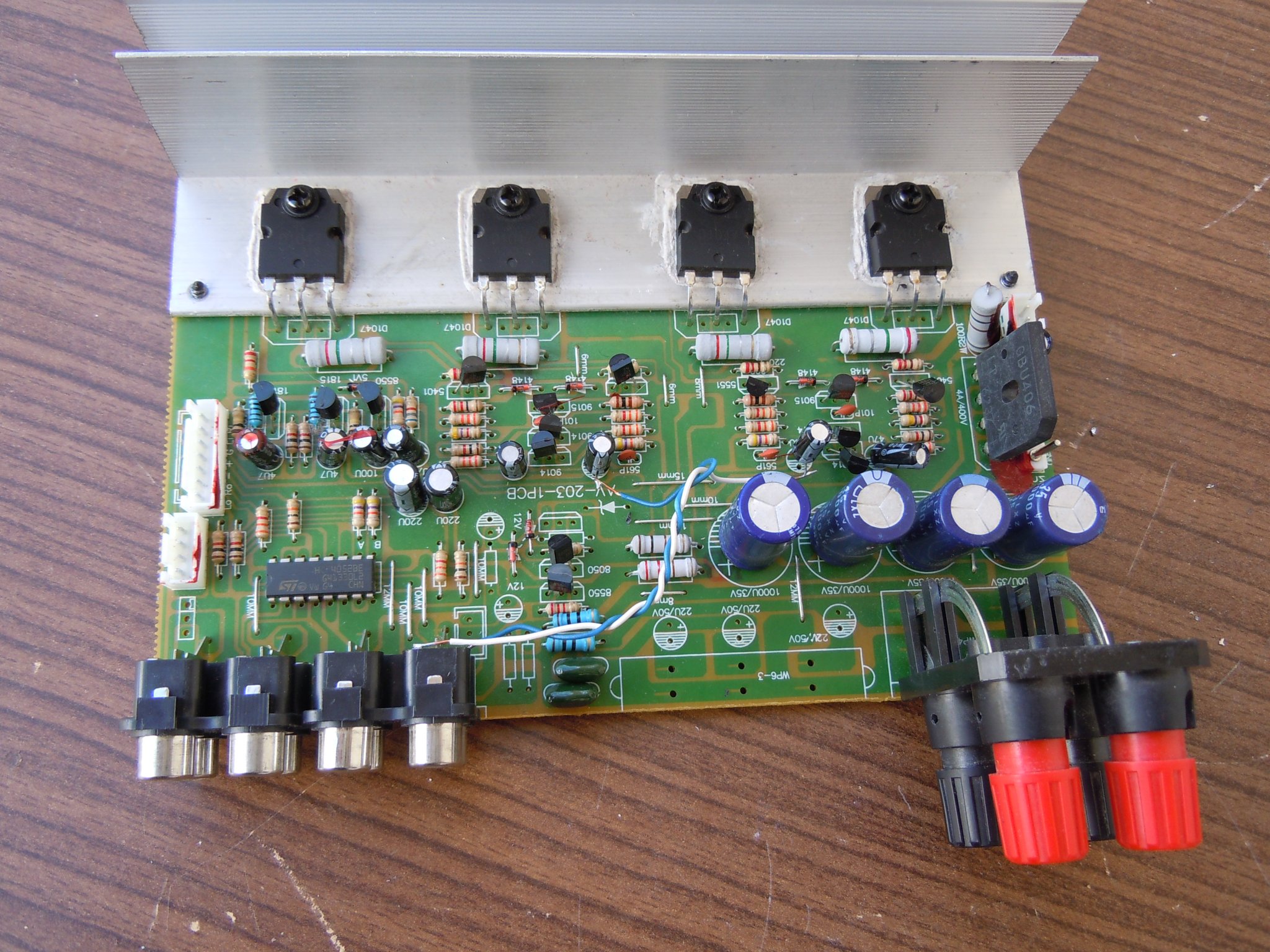

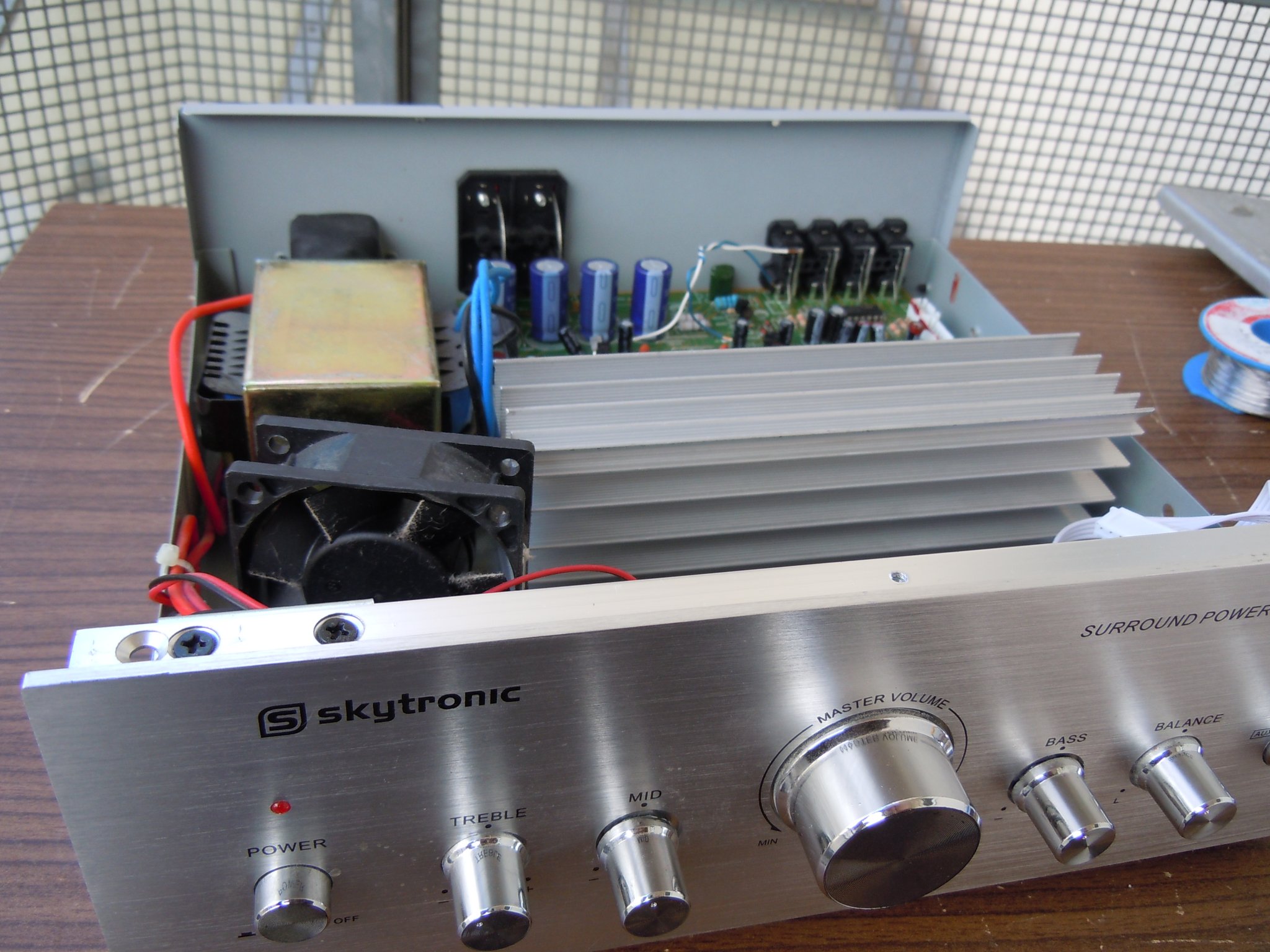

Okay. Not an "original NAP" but nearly the same. May be, a little better, because little simpler and no further preamps and connectors and psus and more.
I would start with these "chinese" dreamamps. They do a really great job! This little one beats all complex complementary-transistors-pp-amps, label and price do not matter.

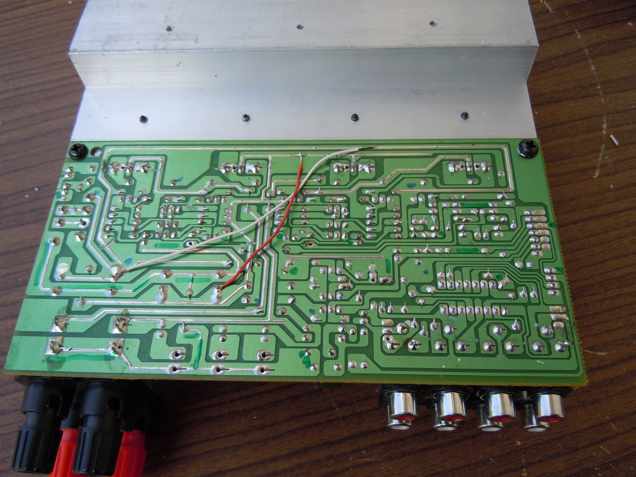

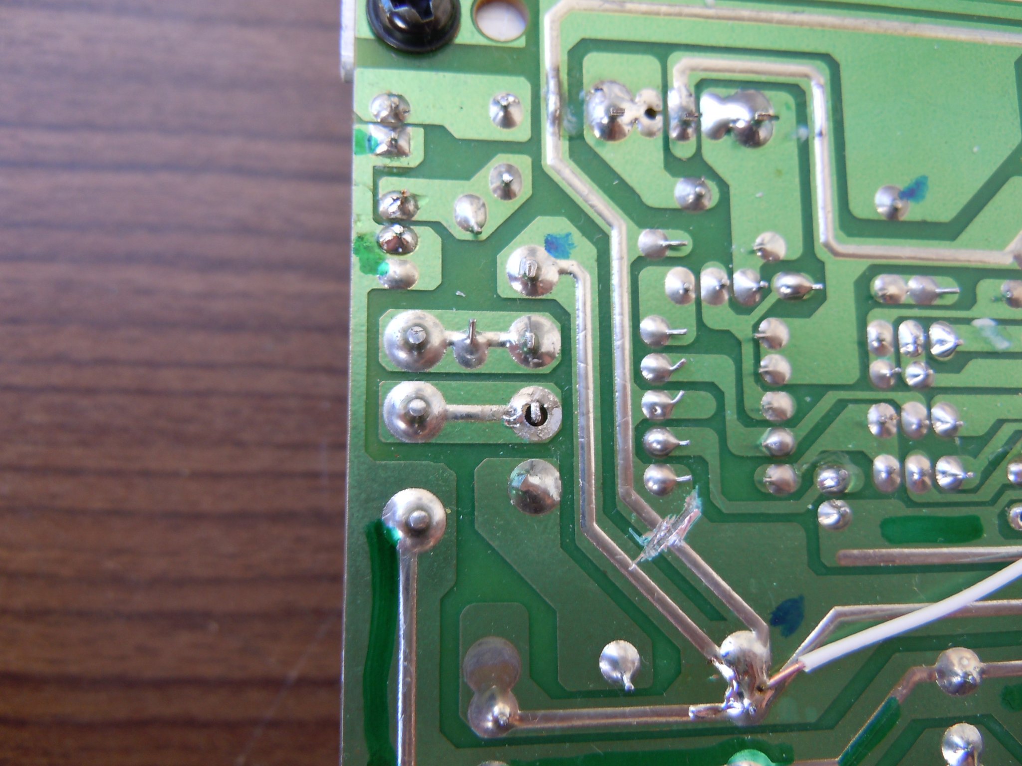

I have prepared to start some tests: bridged input selector and volume poti (white and blue wires upside), symmetrized the channels - half-wave symmetrizing is not feasible here; the only drawback with this little thing - regarding psus (+ and +; TWO psus! red and white wire downside), disconnected the second secondary winding of the trafo - last picture, the resoldered hole;-)
Finally I want build in a little se - a reference in sound and a basic to test e.g. parts as diodes, transes, resistors, caps and all other stuff;-)
So my advice is to buy one of these little things and do basic exercises. To finally create a SUPER NAP 250;-)
And my first advise would be: disconnect the second secondary winding of the trafo. Generally;-)

I think this super reg schematic for preamp. do you use reg for amplificator? If you use regulator, does it change HF or only LF? If you don't, forget it 🙂 I miss your conversation.ALWSR, modified for higher voltage, it's basically a Jung super regulator, see attached schematic (there are caps missing at the outputs of the pre-regulators: I use 100uF).
I use this super regulator for the front end of the power amp. The output stage is powered by Jeff's inverted version of the discrete Naim regulator. So it's non-DR, but at the end of the day I would call it DR ;-)
The sound improvement is both in HF or LF: everything gets cleaner, tidier, more natural, more musical, in my ears quite a significant difference. As I mentioned I compared many (if not all) combinations of non-regulated and regulated front ends and power stages and found that with my NAP clone the fully and separately regulated stages give the best result.
Of course you can use the super regulator also for a preamp or DAC - I use 14 of them in a AD1862 based DAC, another project not yet finished...

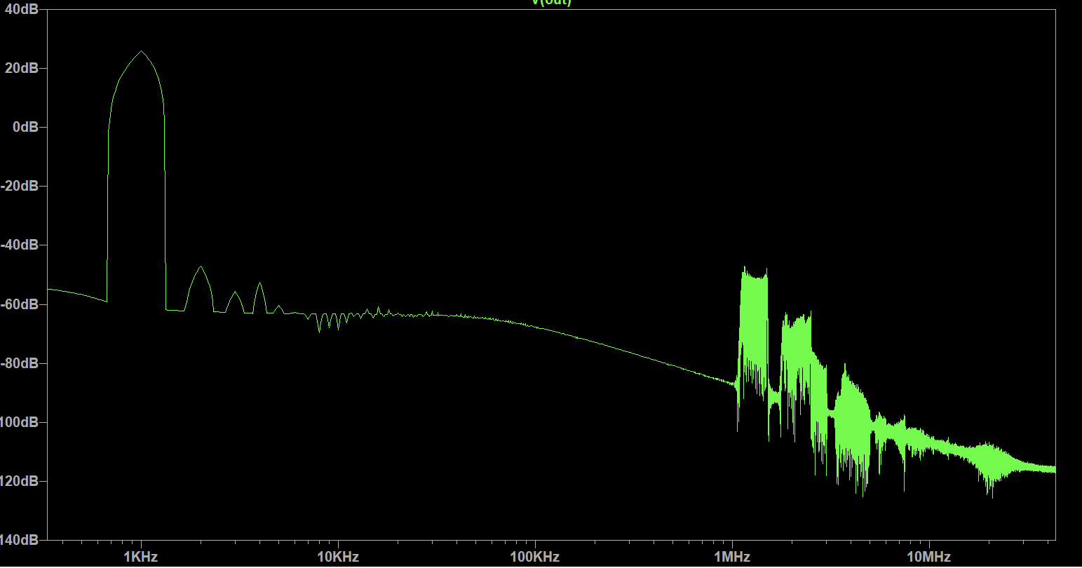

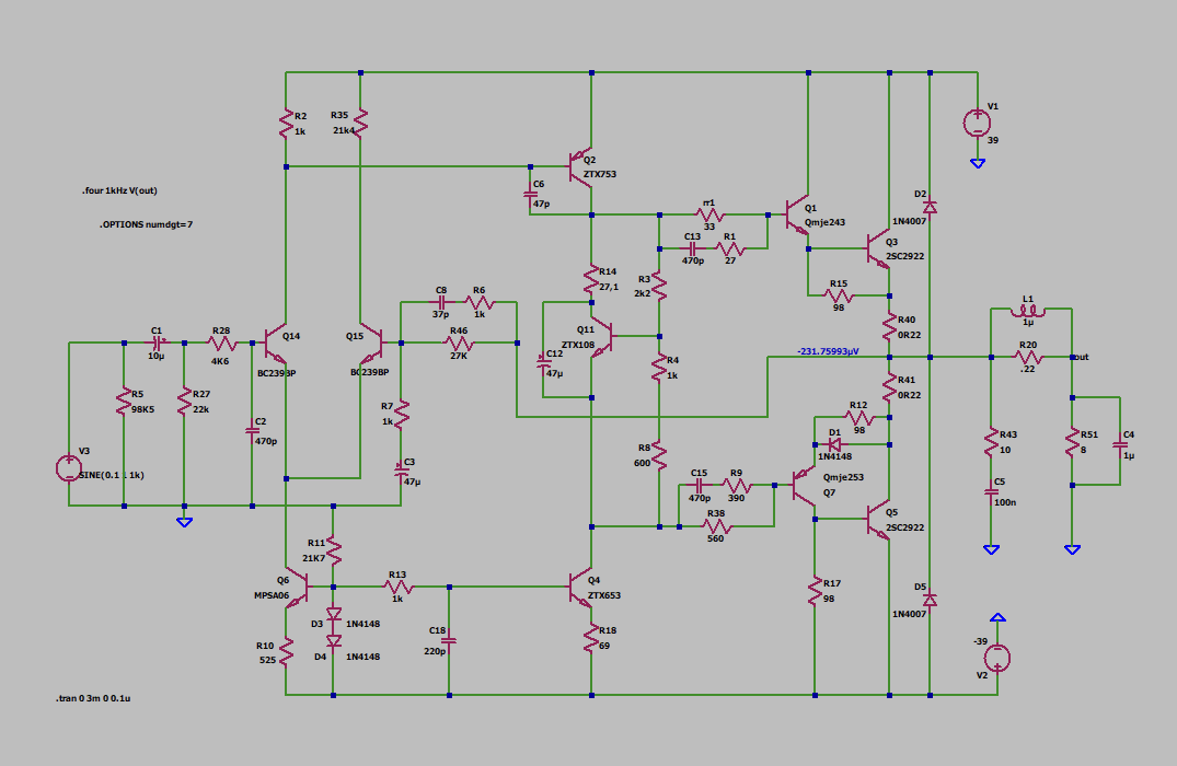

About that circuit (NAP140).
R22 is 0.22 ohm (like there is no inductor L1)/ speaker has 1uf capacitance->
for 1khz, FFT is like. If you put R22> 4ohm then there is no that like oscillation. phase compensation resistor values also changes the oscillation. I didn't look for different values. I'm writing here for as knowledge about what is going on 🙂 (Ltspice simulation results).
Also, you can see the oscillation from the sin wave. I didn't test in real world. I was searching optimum R22 value in the L1/R22 combination.
Check the Avondale schematic: they use 15 Ohms with the inductor.
