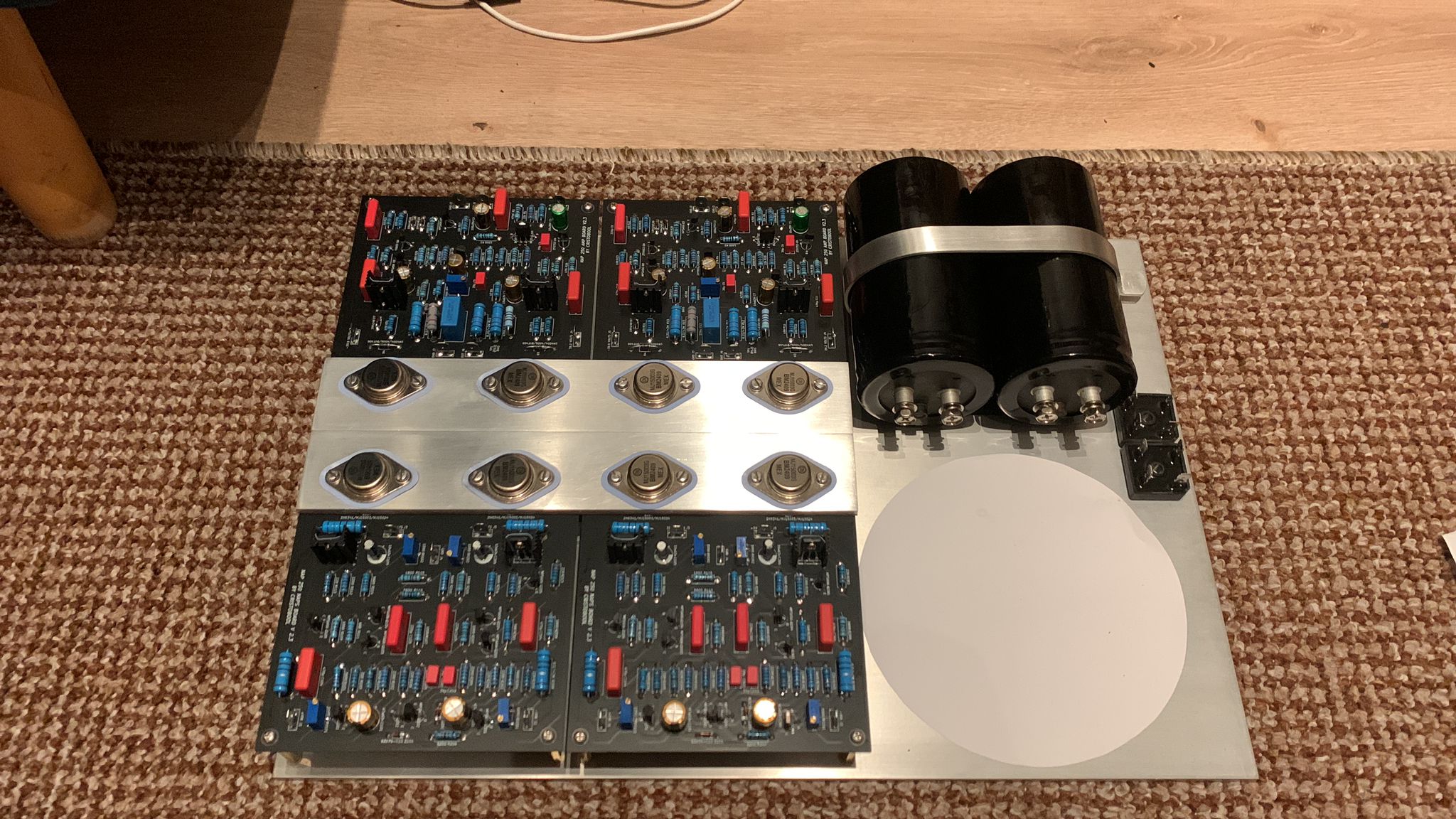

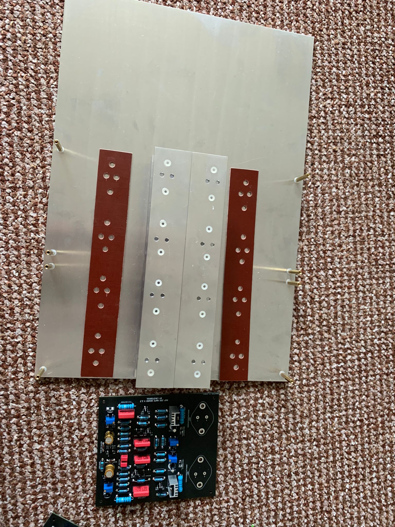

Thanks to Cristobool's courtesy, I'm also building this amplifier using the 2.3 boards. I figured that since I've benefited from my colleague's work, I should also contribute something. I have designed NCC200 boards that match the dimensions of Cristobool's boards.
Also you can find a picture of my amplifier (still under construction) 😉

I've since designed and built a new NAP 250 clone (with the help and work of other forum members) that I'm finally fully satisfied with. I can say that this time its design is truly accomplished and that I've corrected the mistakes I made on the previous ones.
