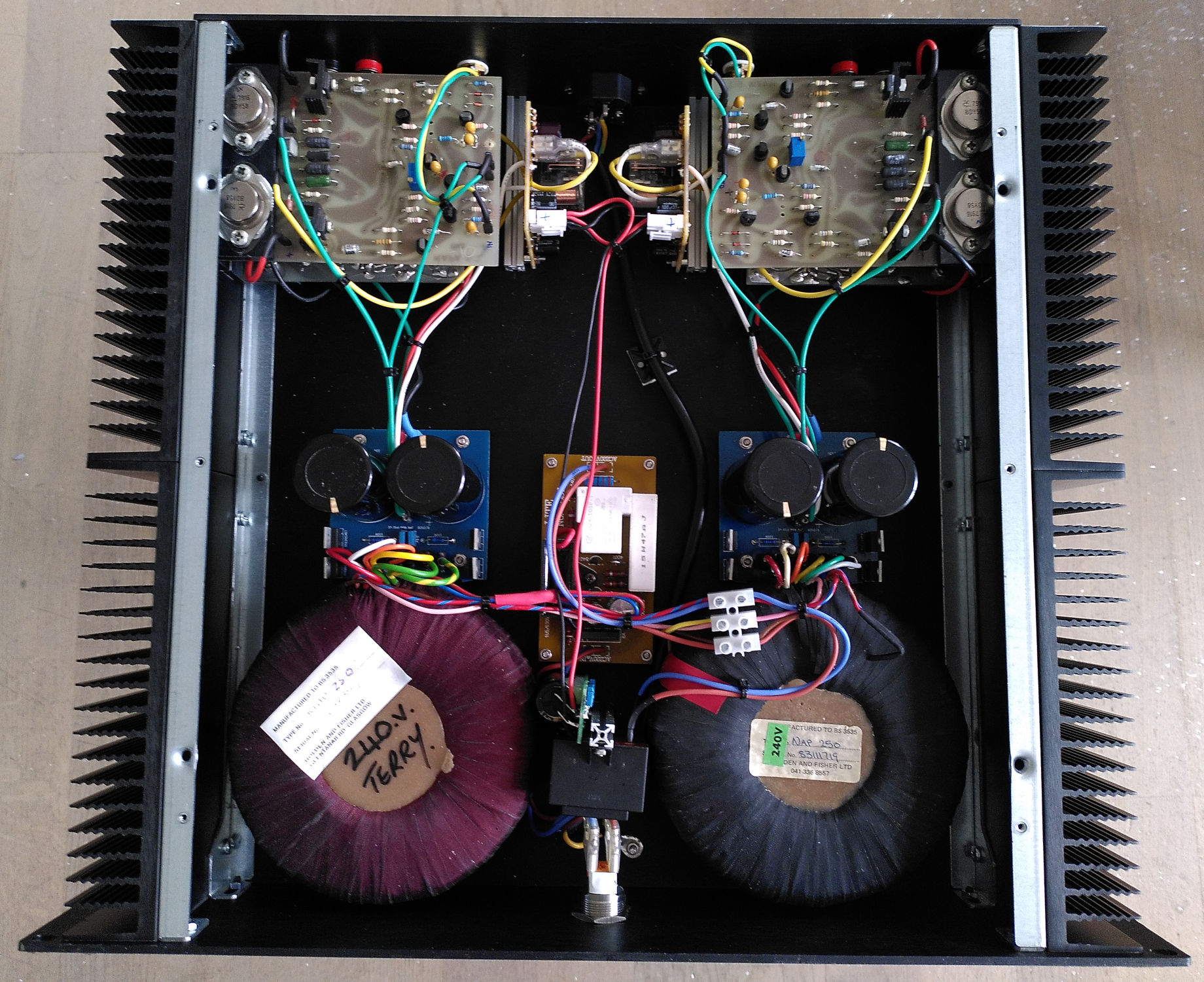

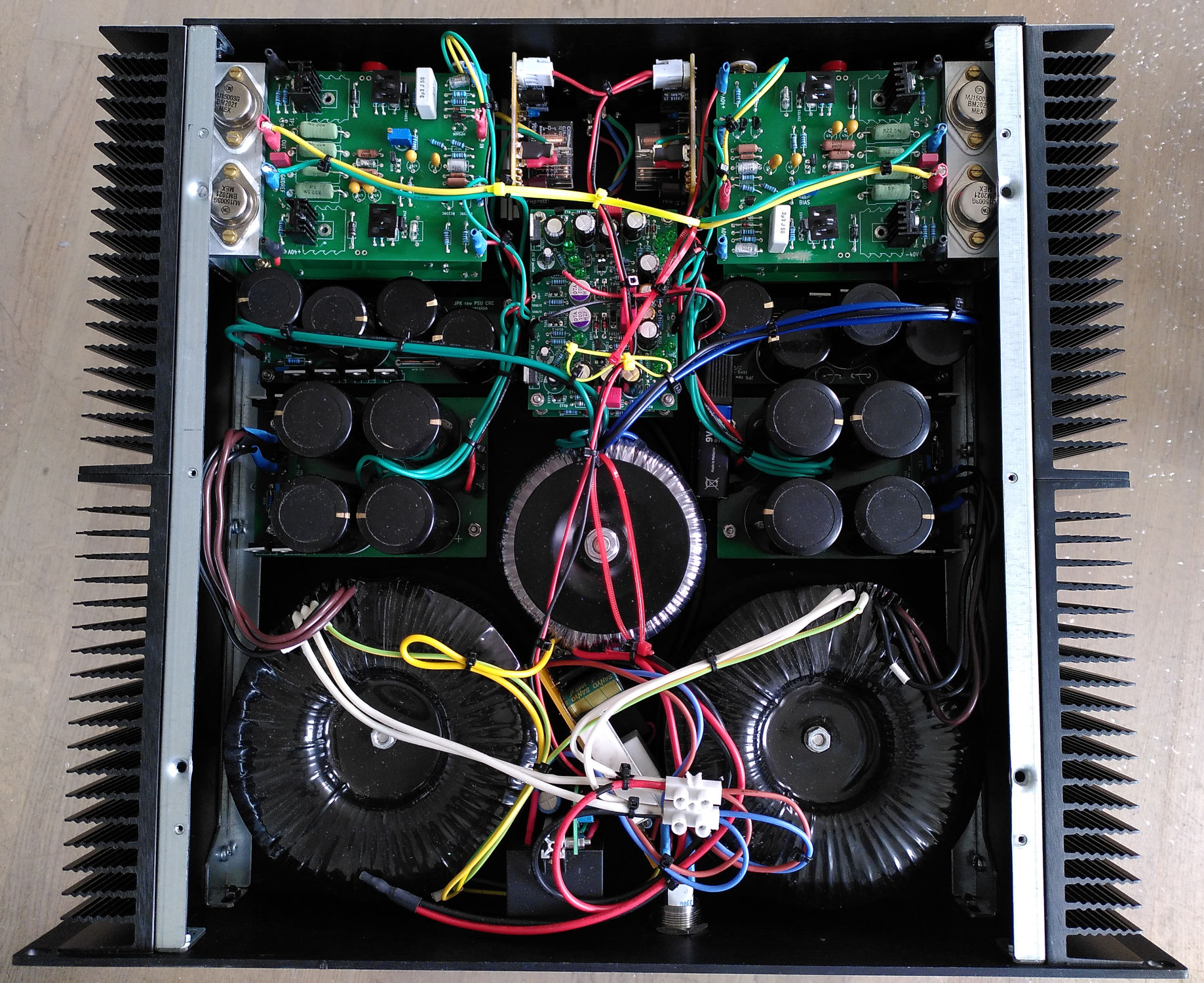

Both my amps have the same protection modules etc., and layout is same, but the Naim has Holden+Fisher transformers and Mundorf caps, the clone has Toroidy transformers and Kemet caps. I think the clone is too tightly stuffed, hence things disturb each other. Also it sounded much better when it was wired outside the case with flying leads. I will try to disable the separate front end PSUs and see if that changes things. BTW the H+F transformers have 2 center tapped windings each, the Toroidys only one, so the rectifier arrangement is a bit different as well.

When I had them wired outside the case with crocodile clip wires my clone sounded better, but mounted in the cases I am not sure. I have to test some more configurations to see if it's because of the front end PSU which was powered differently: I shared the transformer/smoothing caps of the output stage, now it has a dedicated (but smaller) transformer with other types of caps. Also the original boards were powered from the same arrangement, but now there are vintage Holden+Fisher transfomers as you can see in the picture. It seems the original sounds more dark and smooth, the clone more open and textured, but somehow a bit flat in comparison... Any thoughts?

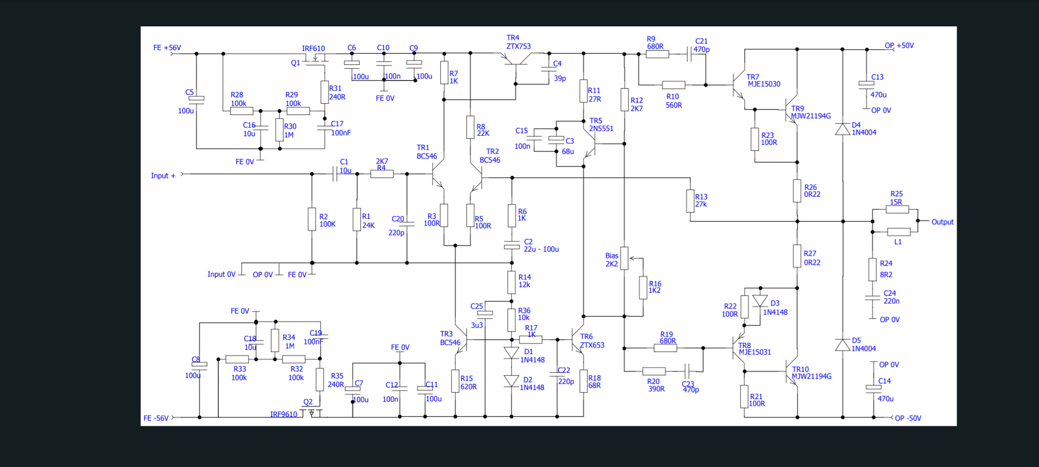

I would expect the HackerNAP to sound quite different to a Naim NAP. The circuit has important differences.
It looks like Hacker tried to change the stability of the circuit by adding LTP emitter resistors, eliminating the phase lead compensation and adding an output coil.

I didn't use any LTP degeneration in my clone (which uses a pcb of my own design) but in other projects they have the very helpful function of allowing you to measure the standing current through each leg of the LTP so perhaps low value resistors in that position have some reason to be.
