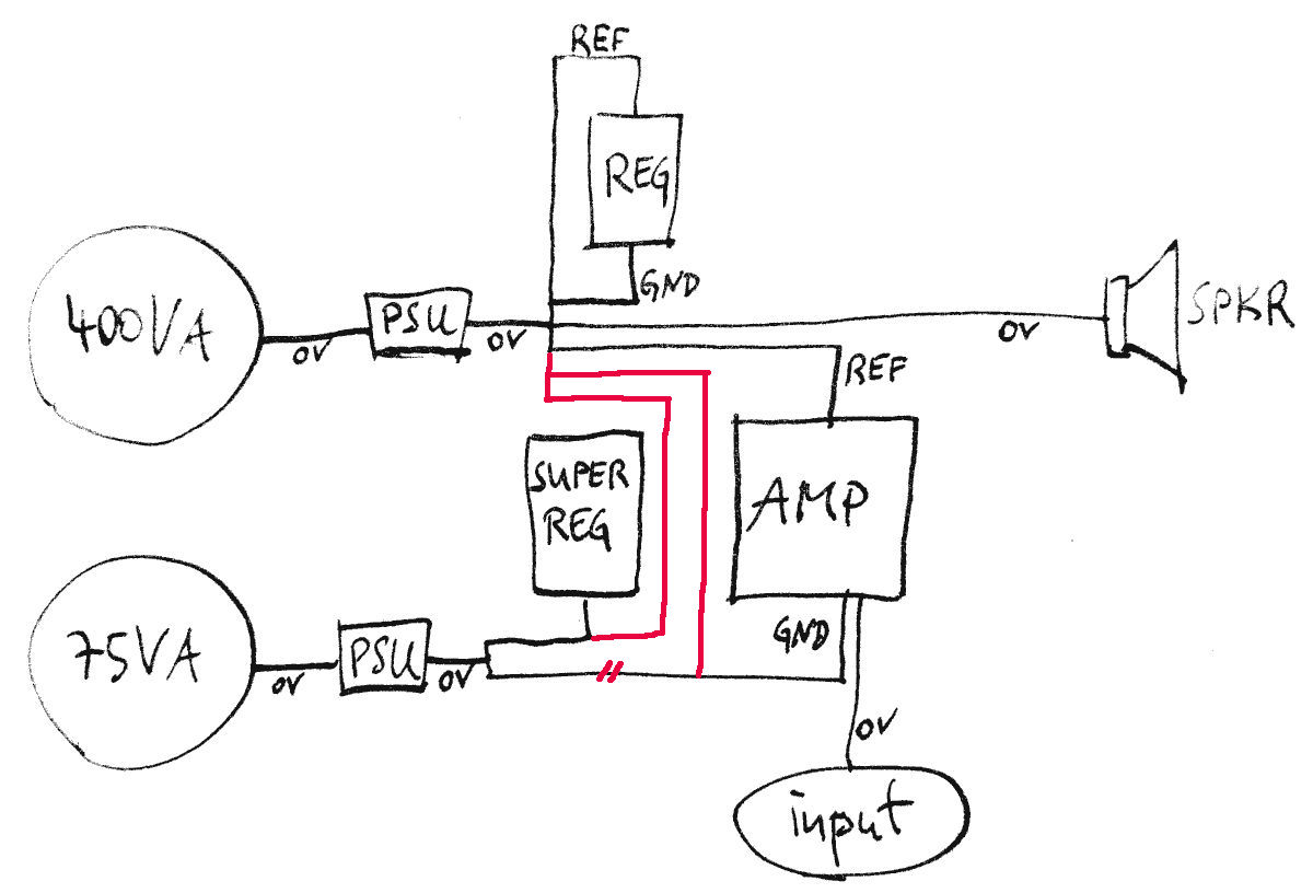

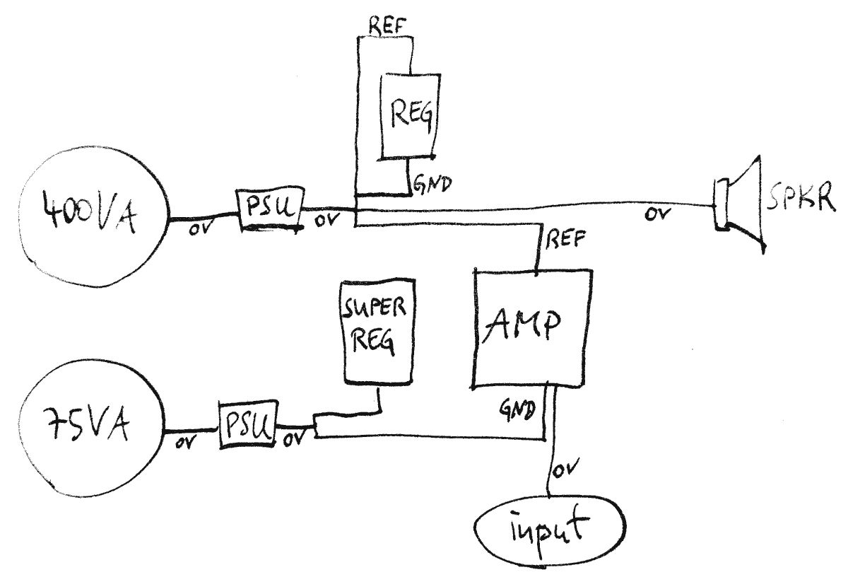

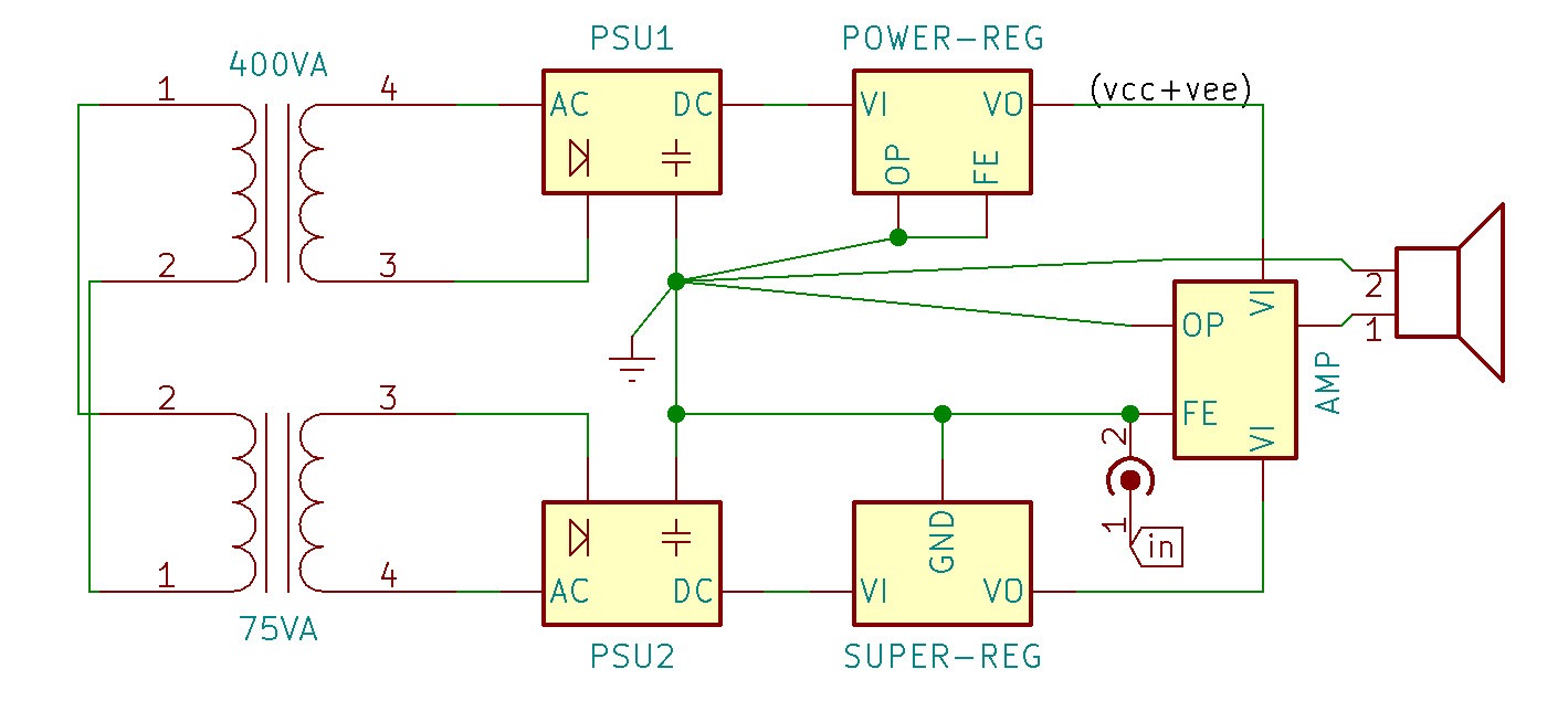

Now I am looking for how to best ground my amp, please see attached picture showing one channel (only 0V lines are drawn): I have 2 transformers, 2 PSUs, 2 regulators and the actual amp board for one mono amplifier. The regulator for the power stage and the amp board both have 0V connections from their output stages, I marked them with "REF", and they have a normal GND connection at their input - which are not internally connected to the REF points. So I need to wire the REF points directly back to the 0V lines which is fine and known from the NAP circuits (the super-regulator for the front end does not have an extra REF connection). Now the question: where do I join the 0V lines of the 2 PSUs together: at the transformer, or after the smoothing caps?

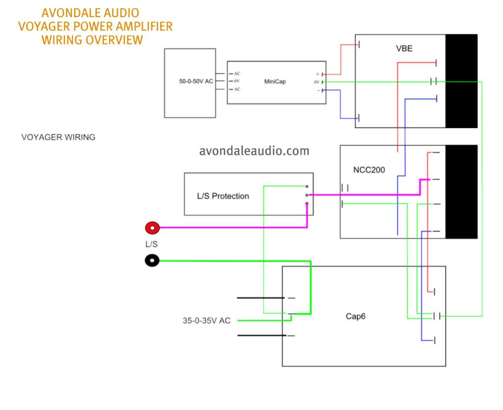

No input on this...? I got noise using the above scheme, so I corrected the grounding and wired the amp as in attached diagram, now it's quiet. For reference I include a wiring diagram by Avondale, and one showing a Naim amp:

This is a different topic from the 0V layout inside a power amp, no...? In any case if signal-GND in the power amp is directly connected to earth you might get a loop because usually the ground connection is located in the source (at least in a Naim system). Either lift signal-GND in the power amp and/or ground it through the incoming signal-GND (but don't forget to care about safety). The GND-layout inside the power amp can cause noise (in my case it sounded just like faint white noise without buzz/hum), but now it's sorted (I think the reason was a bad path from the REF point in the power regulator). Here is a picture, suggestions are most welcome (cables are not dressed yet):

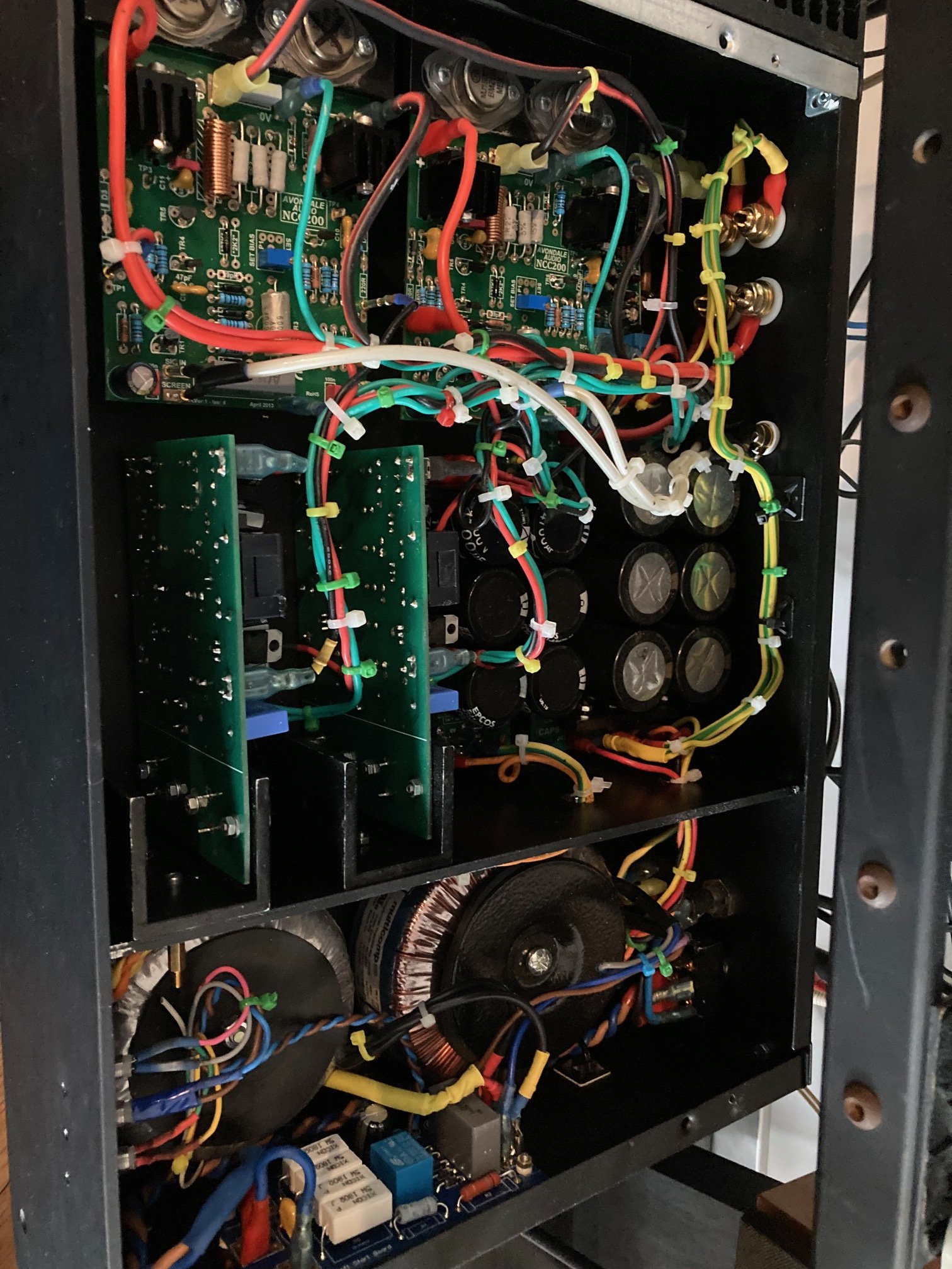

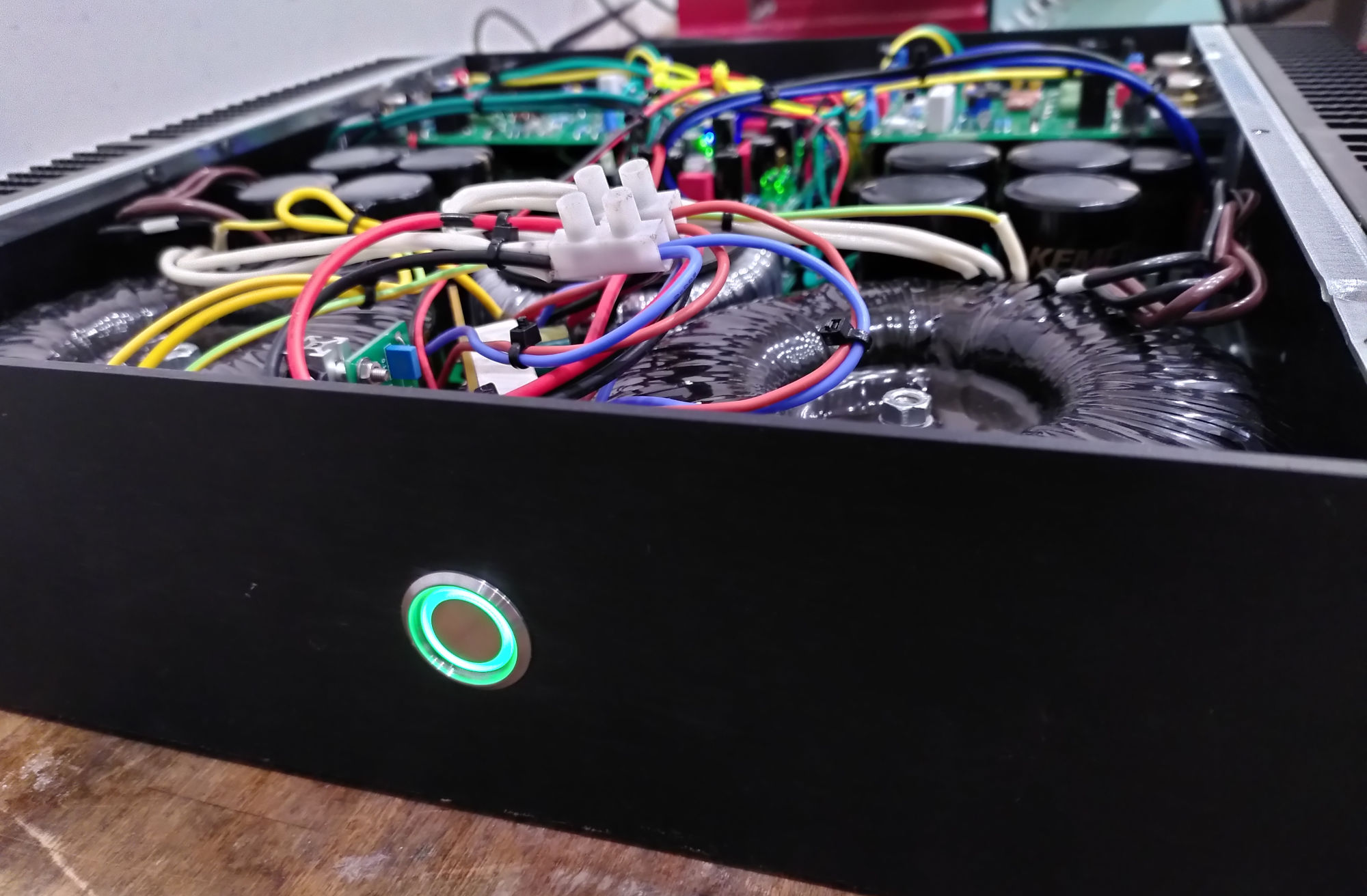

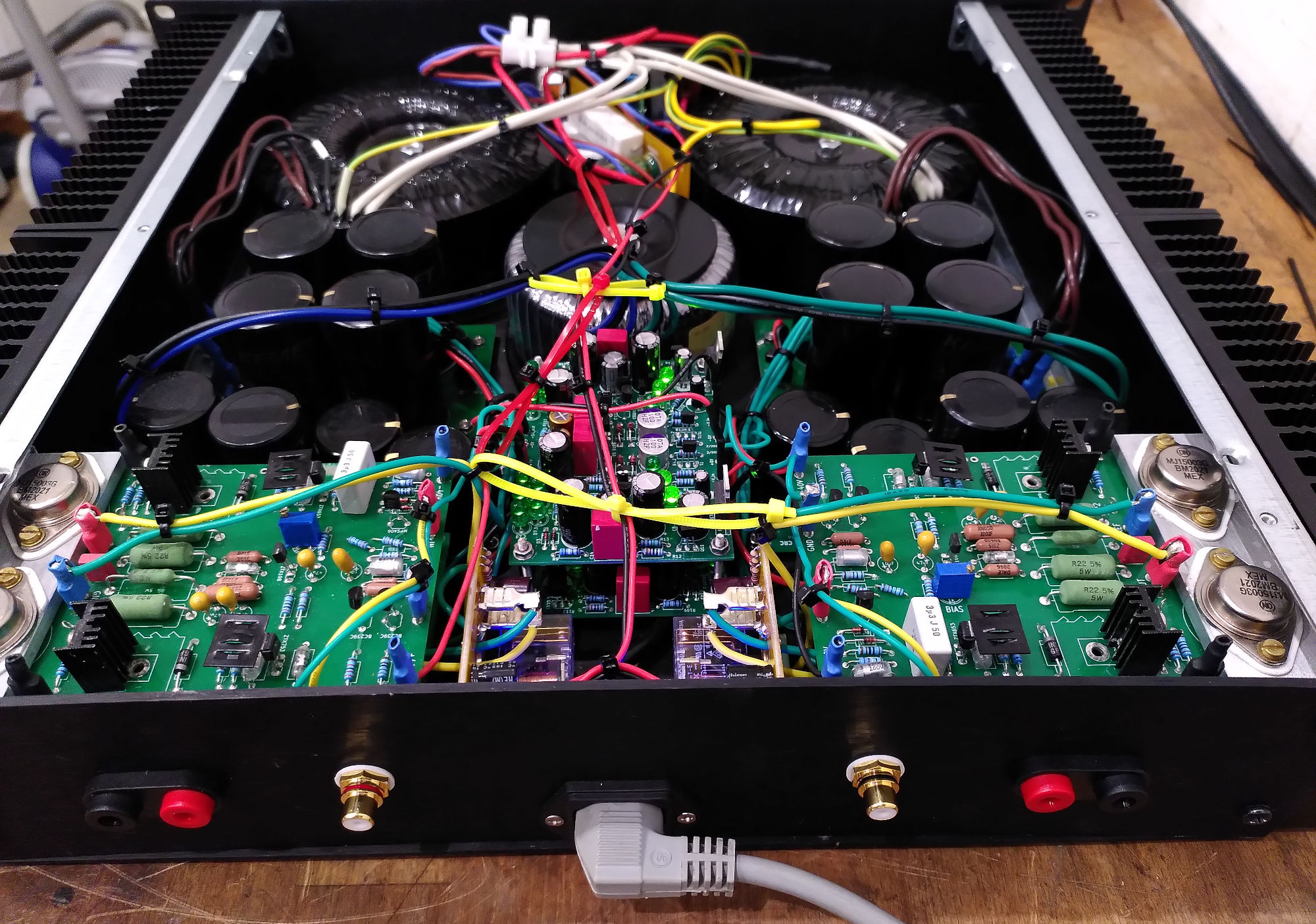

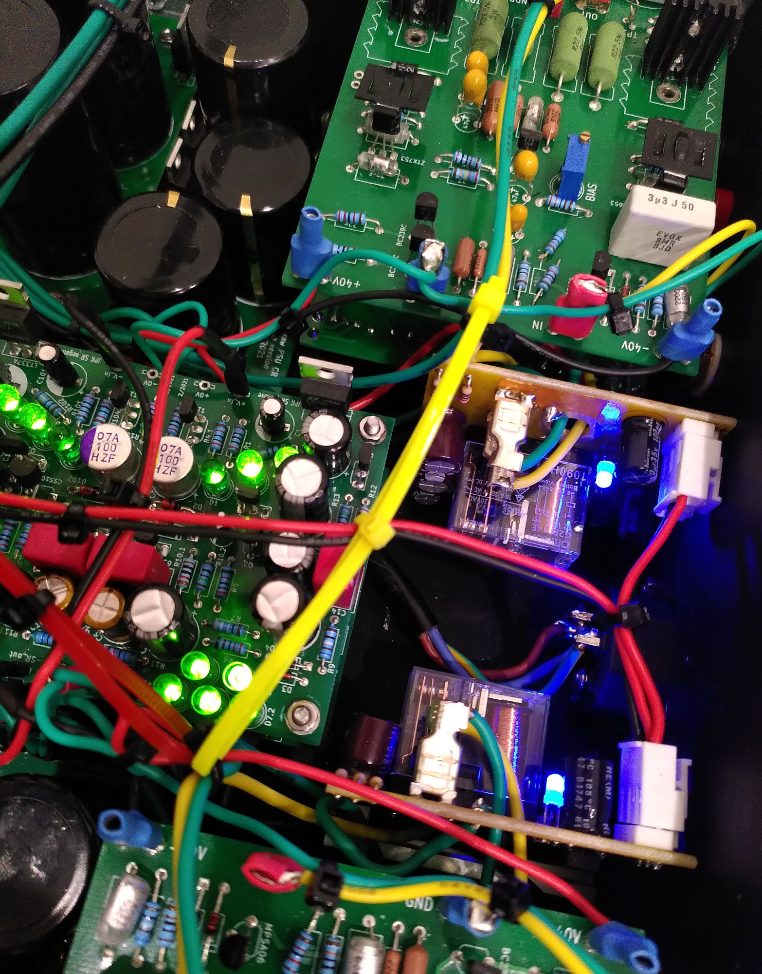

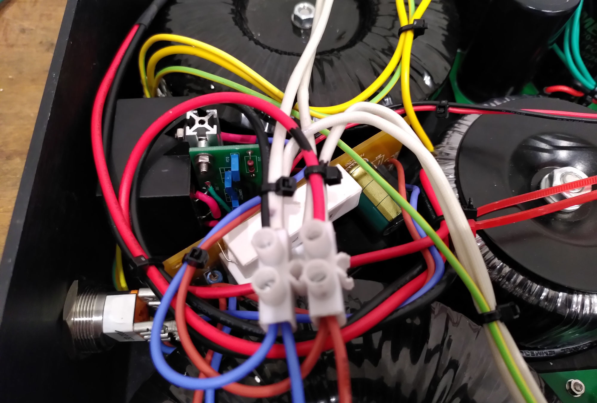

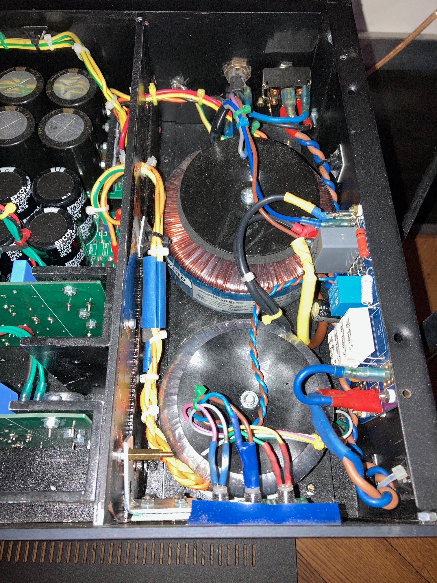

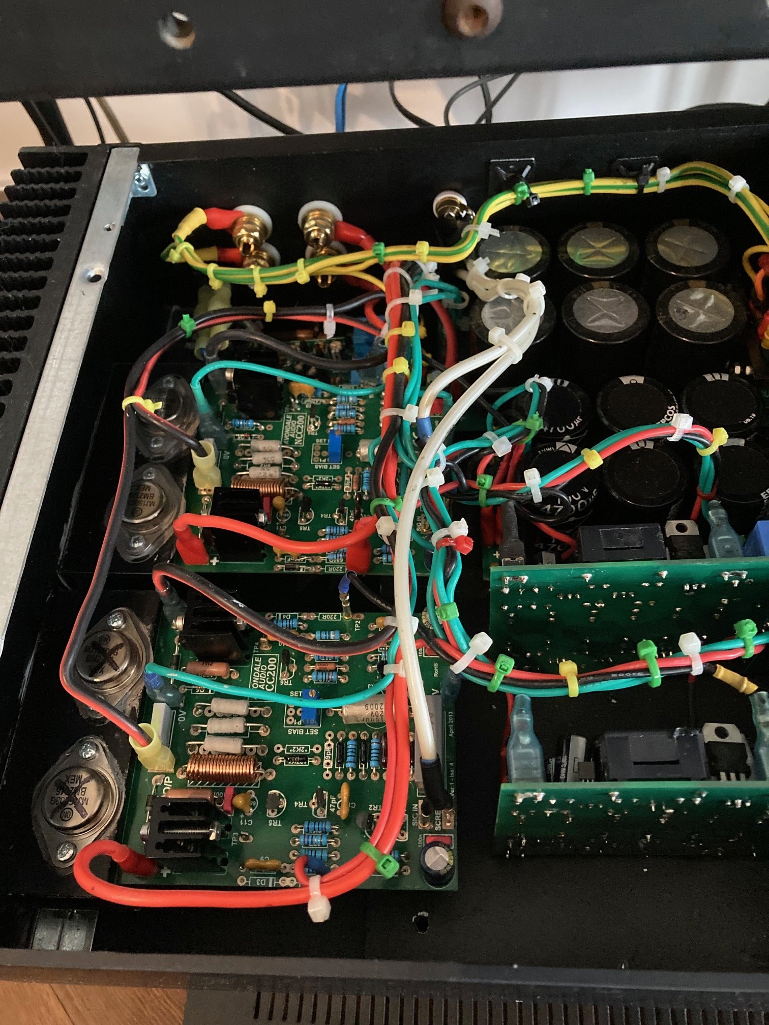

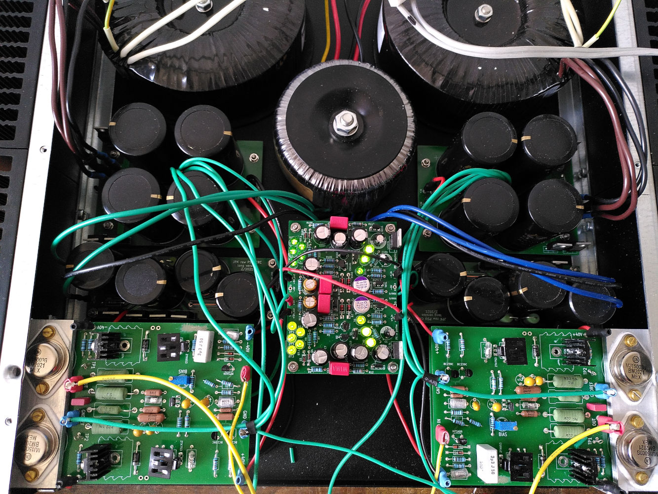

My amp is kind of completed! I tried many grounding schemes (with some help from PFM) and finally settled on the one shown in attached pictures. It's a completely separate dual mono amp with four transformers: one per channel for the power stages, one with separate windings for the front ends, and one for the speaker protection modules. There is also a softstart module. The case is only 80mm high, it's a Dissipante 2U / 400mm (completely closed version), so it's very tightly stuffed, and the amp weights almost 20 kilos. The wiring looks a bit messy, but I tried to locate away the AC lines as far as possible from the DC and signal lines. It's not perfect, so if you have suggestions feel free to chime in. I have adjusted the power regulators to approx. +39,2 and -39,8 volts, the super regulators output 41,8 volts, and there is practically no DC offset. The sound is very smooth, natural, has great emotional impact and the timbre is neutral. The bass is extremely strong and clean even with small bookshelf speakers. Bias is set to 7,2mV (across both emitter resistors): is that too low...?
I made an ncc200 with the front end modules according to the Avondale ground plan and from the first listen no background noise or hum.Looking at your complex realization I notice that the layout does not clearly separate the power supply part from the circuits . The 220v outlet is symmetrical and in between the two inputs so the 220v takes a long path before the transformers. These are details I know ,however .
You are right, but I didn't find a way to separate them further in that case. I don't hear hum/buzz/noise though, so I guess it's fine, but the version with the original Naim boards sounds vastly better: same layout but without the extra transformer for the front end regulators. When I had them setup with flying crocodile clip wires the regulated amp sounded better, but assembled in the case the Naim sounds better by far. Surely the distance between the AC and the signal lines/circuits plays a role... BTW the Dissipante case doesn't fit together without bending the front and back panels: the heat sink elements are too long, there are small gaps everywhere, is that also the case with your case?
