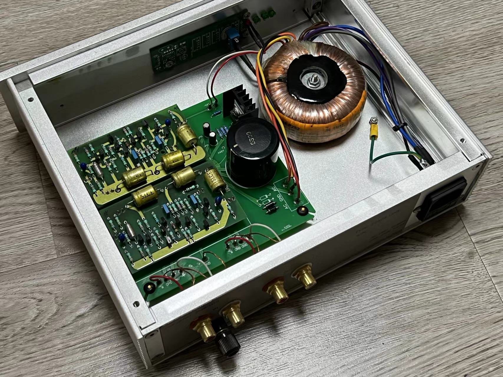

BTW I made a phono stage using NA32x cards: with the transformer in the same case it was impossible to sort the hum. Moving the transformer into an extra case was the only solution. The same was reported by several diyers.

Phono cards hum only with transformer in same case!!! Many diyer experiences this. Hum with external case has other reasons...

I made this and it hummed until I removed the transformers from the case:

Nait 1,2 ,3 , Supernait 3 have phonostages inside and hum wasn't a big problem. I assume. I agree it's easier to build with separate power supply. Hum pickup in your enclosure was probably caused by layout issues. I got a Stage line N for $100 last week. Just to have a matching enclosure because everybody seem to unequivocally agree that it's a piece of s.
Don't Nait/Supernaits have different phono stages from the ones in 32/72? What layout could make such a loud hum? I moved the transformers around, and it was simply distance and separation by an extra case that cured hum. No changes in layout or earthing were needed.
However hum is only one example - there can be other more subtle influences from the transformer that they wanted to eleminate by putting them into separate cases...

It is,a good practice to have power supply in different box than phono stage but many exists with transformer in the same enclosure and they don't hum. It could be solved with different transformer, box or layout. Im just trying to say that separate box is not the only solution. If it works for you than its a good solution. I prefer MM stages with step up transformer to MC phono stages . I don't know what difference particular Naim board makes. Never heard any.

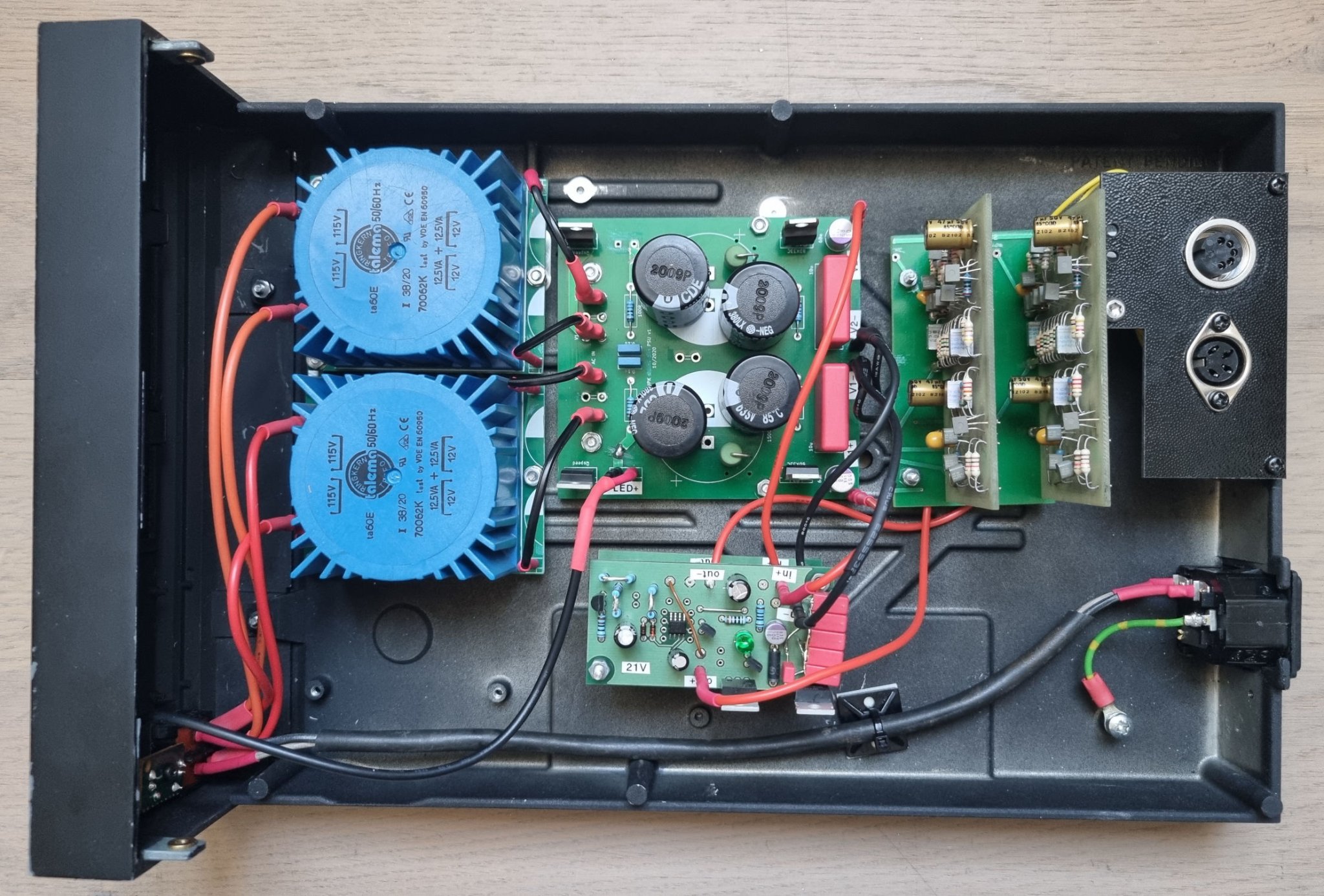

I think this design is a NAC152I have a NAC112 that fell into the water. I bought it like this. I didn't throw it into the water. Cleaning and repairing was difficult, so I redraw the PCB from scratch, referring to the NAC82's PCB. Looks good. Most parts are from the original NAC112. Controller using the original NC112.
